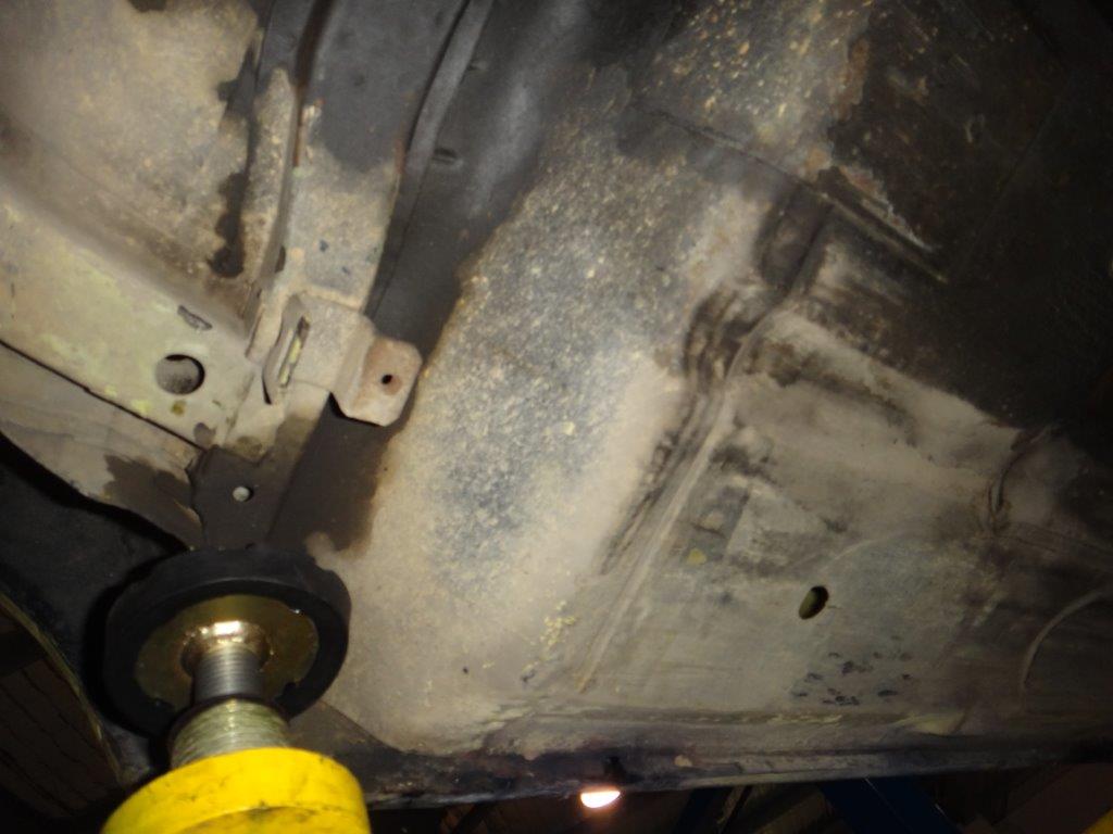

240Z_au Posted September 7, 2015 Author Posted September 7, 2015 OK, she's almost stripped underneath. Doing exterior tomorrow and interior Wednesday. Quote

GongZ Posted September 7, 2015 Posted September 7, 2015 I did a double-take when I saw that photo - it looks like you have just taken the diff out of the engine bay! Quote
240Z_au Posted September 7, 2015 Author Posted September 7, 2015 So are you doing a full resto on this car or just a freshen up? Hi. Full Restoration. The 73 was a refresh. What do you think about them?: https://www.redistrip.com.au/ I'veonly ever done soda blast before. I did a double-take when I saw that photo - it looks like you have just taken the diff out of the engine bay! Yeah, it looked kind of cool. Havent seen that type of a shot before, so here it is Quote

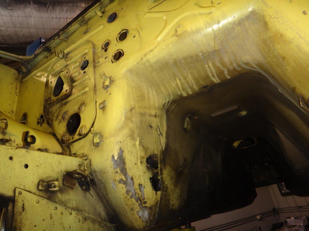

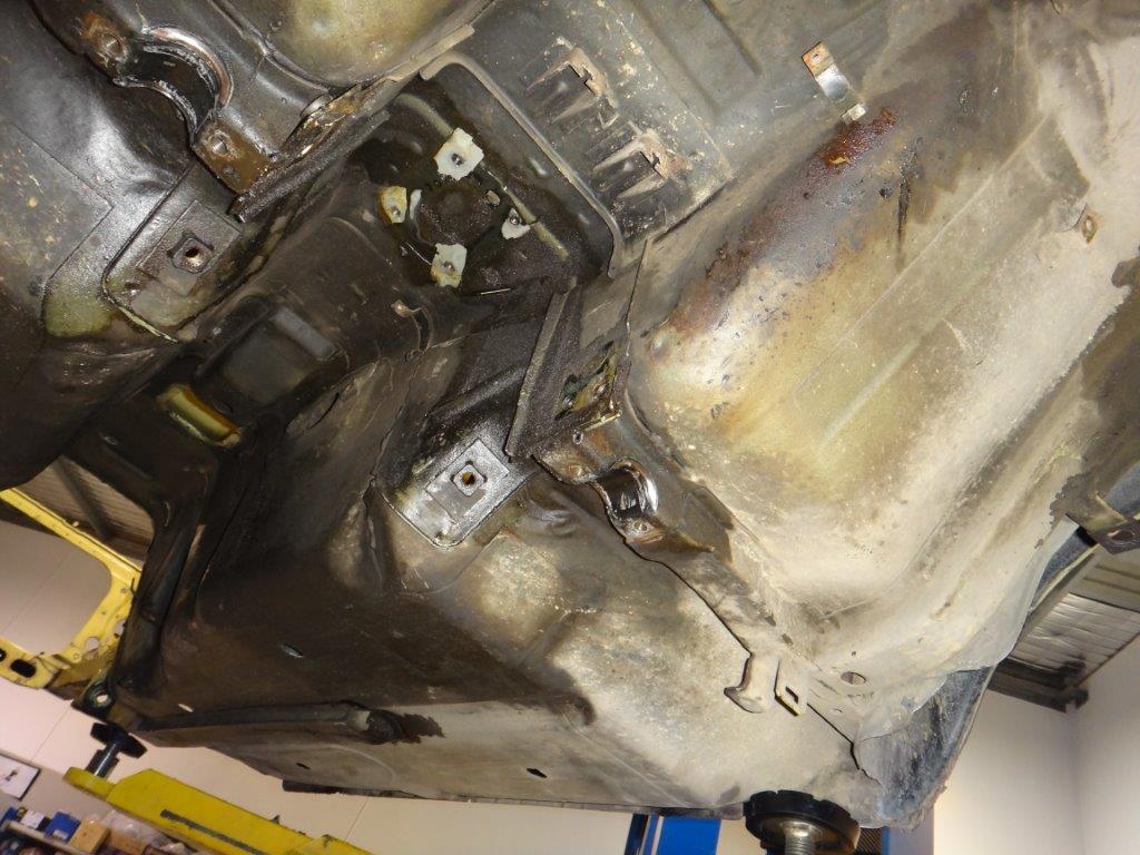

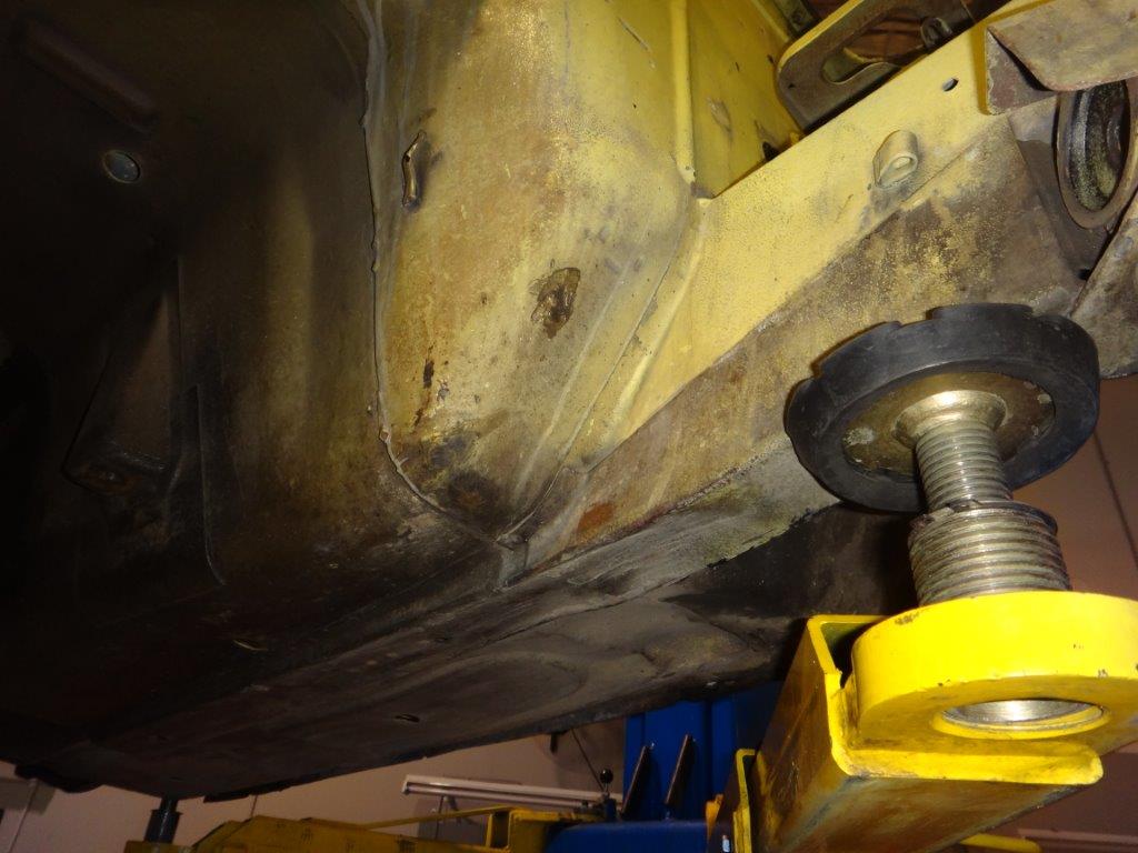

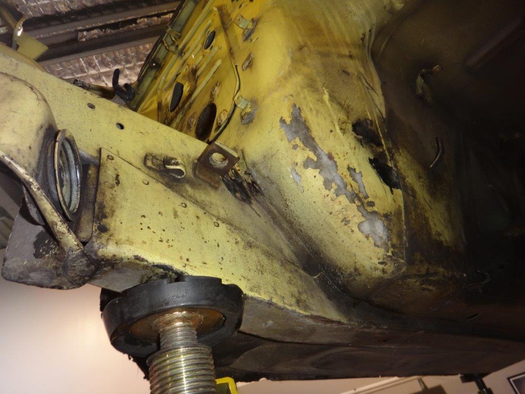

Moderators PB260Z Posted September 8, 2015 Moderators Posted September 8, 2015 (edited) More sins of the flesh...Good news, no rust in Rails or the battery area. I particularly enjoyed the wire contraption for rear exhaust It is just amazing the "interesting" repair methods you find in old cars. We could probably justify a thread on Dodgy and Interesting previous repairs ? Edited September 8, 2015 by PB260Z Quote

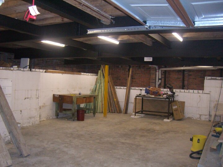

Moderators PB260Z Posted September 10, 2015 Moderators Posted September 10, 2015 but I'm struggling with garage space ATM..Something I'm trying to resolve without selling the house ;-) Start digging. gav240z and George 2 Quote
Administrators gav240z Posted September 10, 2015 Administrators Posted September 10, 2015 I could have bought something else out there, but I would have done the same thing to no matter what "original"car I've bought, because for the last 2 years or more, (and some of you would have seen my shout-outs for a decent car out there) I found nothing for sale that I would have classified as a properly restored car (to my very personal standard). I had PM's from owners and businesses out there that claimed to have "the one", but seriously, all I saw was disappointment, after disappointment...and the $$$!! LOL. So, the aim was to buy 71 or earlier (getting tougher) and with all original bits on the car and do a nut and bolt restoration. That is the only way I feel I can get what I really want. As many of you would know, unless you build it, it ain't there....and if I cant pull it off, I can only blame myself. I'm with you on that, I think you did the right thing. Buy the best original car you can and work from there. It will always be less headache that way, and the few little things you've found are normal for a car of this age. Something that has become incredibly obvious to me from the early girl bingo thread is just how "few" early 240z's are a.) Original complete with matching motor and b.) How few are actually in good shape, most are projects in need of a lot of love. You can literally count with 2 hands how many 'good' early 240z's are out there in terms of originals non modified period correct cars. The correctly restored cars have had a lot of time and effort put into them and the owners of said vehicles generally don't want to sell unless they have to. Hence looking for the impossible dream for so long . In terms of your storage issue, I'm looking at buying a warehouse to live in and convert. > Of course Peter's idea of digging under the house is a good solution also. Quote

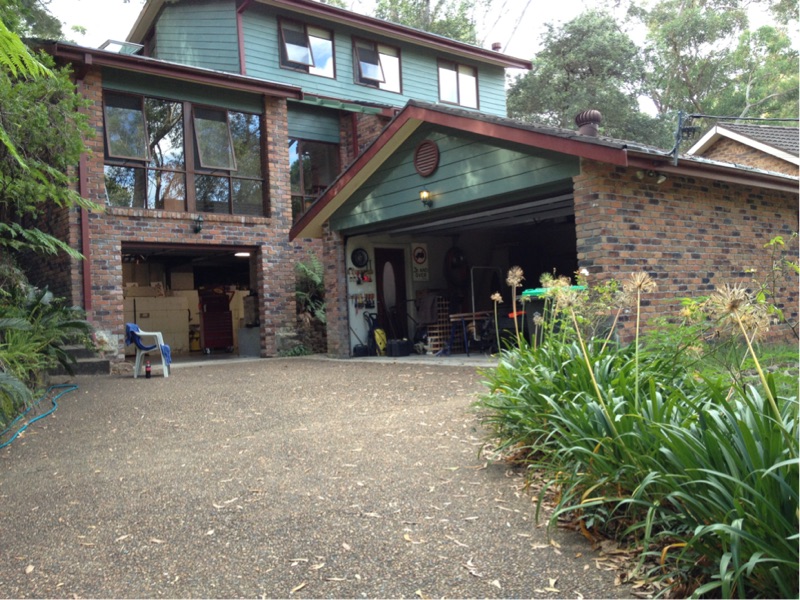

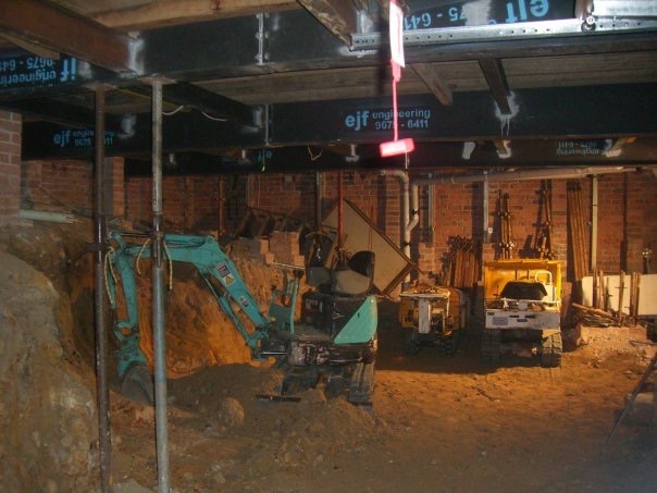

Moderators PB260Z Posted September 10, 2015 Moderators Posted September 10, 2015 In terms of your storage issue, I'm looking at buying a warehouse to live in and convert. Of course Peter's idea of digging under the house is a good solution also.Buying and converting a wharehouse would be the ideal, but doesn't really fit with the family scene. Digging out under the house, we purchased the house with this in mind and it took 12 months to find a suitable property. Below is before and after shots of tne street view. It wasn't a cheap exercise but I am very happy with the result. George 1 Quote

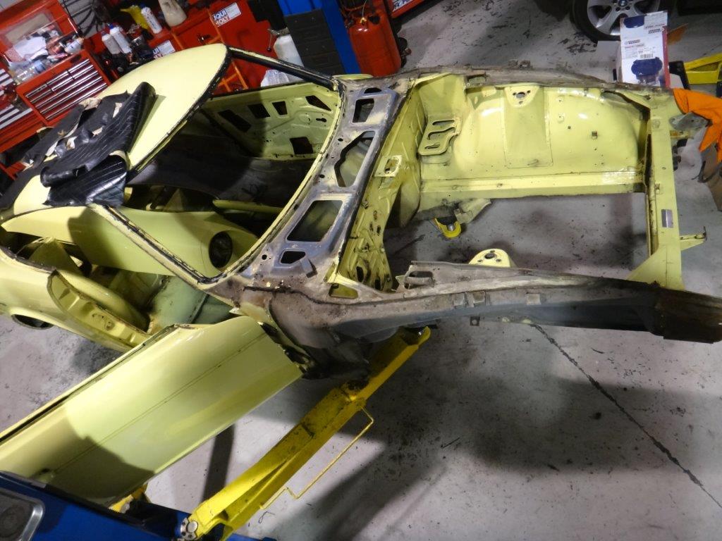

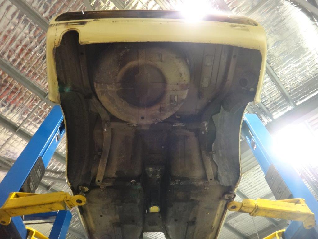

240Z_au Posted September 14, 2015 Author Posted September 14, 2015 ^^ Awesome setup^^ Unfortunately for me, I don't have an elevated site.. Just got back from Townsville, did 5,550 or so km's from Sydney to Melbourne to Townsville and now back to Sydney for my daughters birthday..Awesome trip (as always is the case in the country)..This is what I saw on the way...and later when I got back today..My 240 is well and truly in pieces now Quote

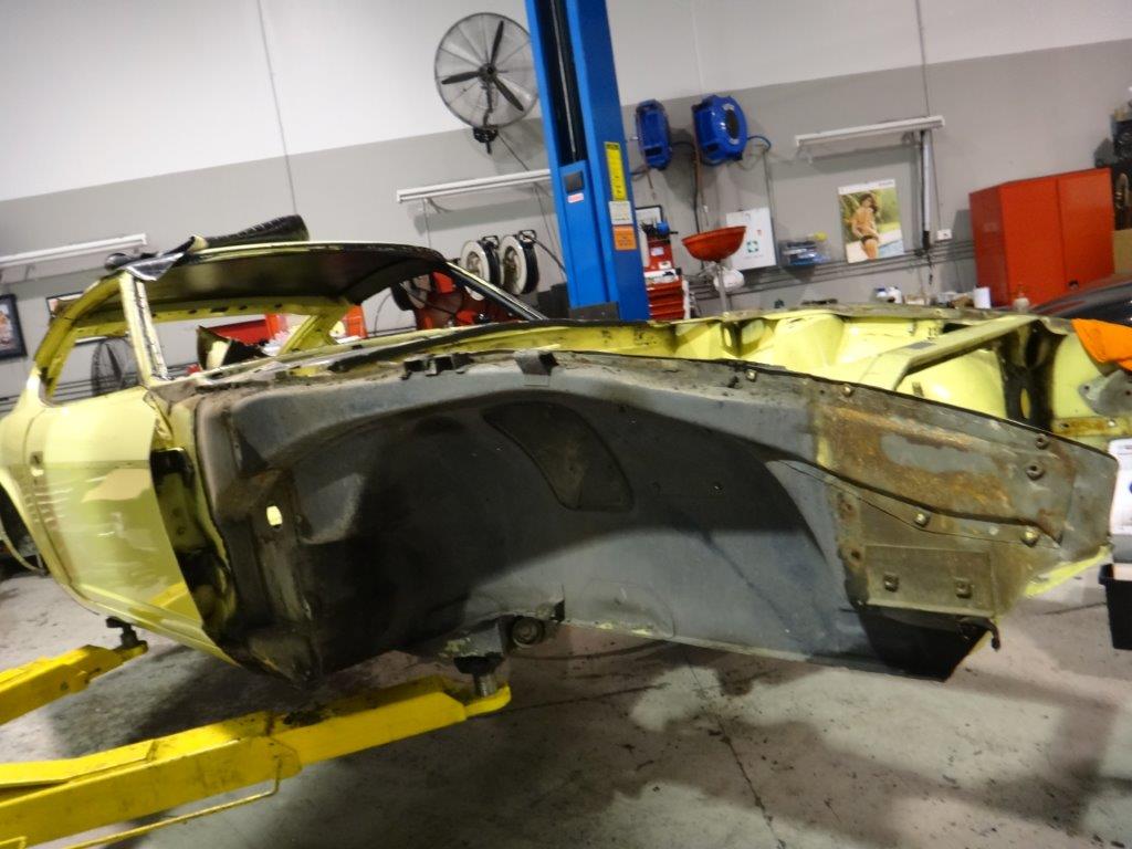

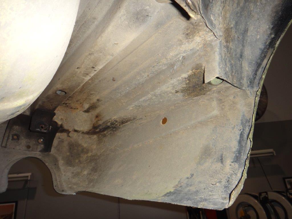

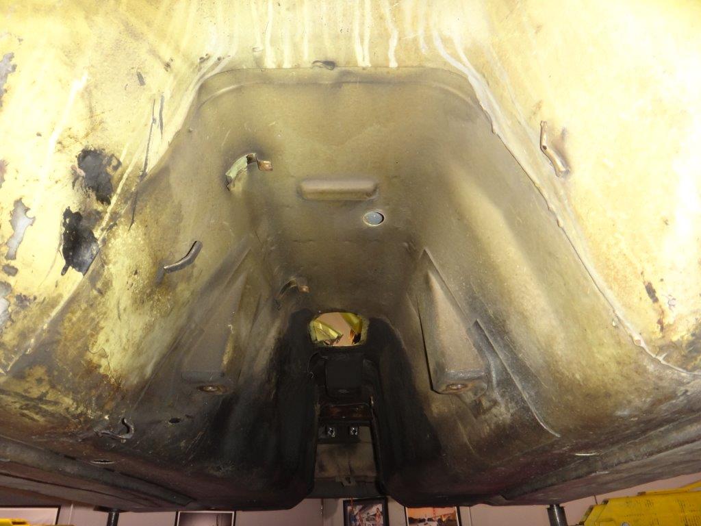

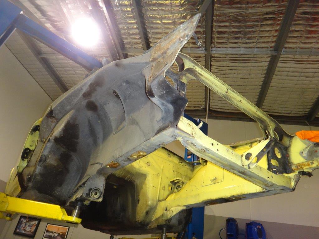

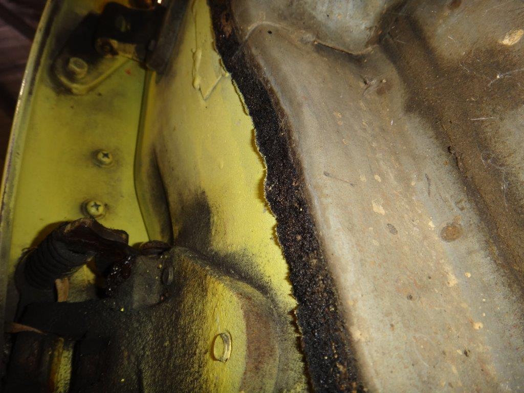

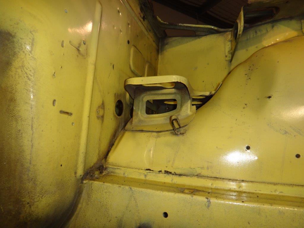

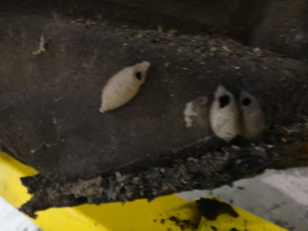

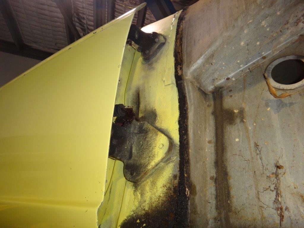

240Z_au Posted September 15, 2015 Author Posted September 15, 2015 (edited) Thanks Gav. It was an amazing sight..I can picture what you suggested, pitty I didn't have my Z there for the pic, I would have definitively made the effort. OK, so here is my Z now. No major surprises, everything actually looks very well preserved including lots of rust proofing in the doors and other strategic to S30 areas. Its a good base, I'm happy. EDIT..Only surprise are the wosp nests ..Under both guards. Edited September 15, 2015 by 240Z_au Quote
KatoKid Posted September 15, 2015 Posted September 15, 2015 From the photos I would say that's one of the best condition original cars I've seen.......very well done! Just a little lime green with envy. Quote
