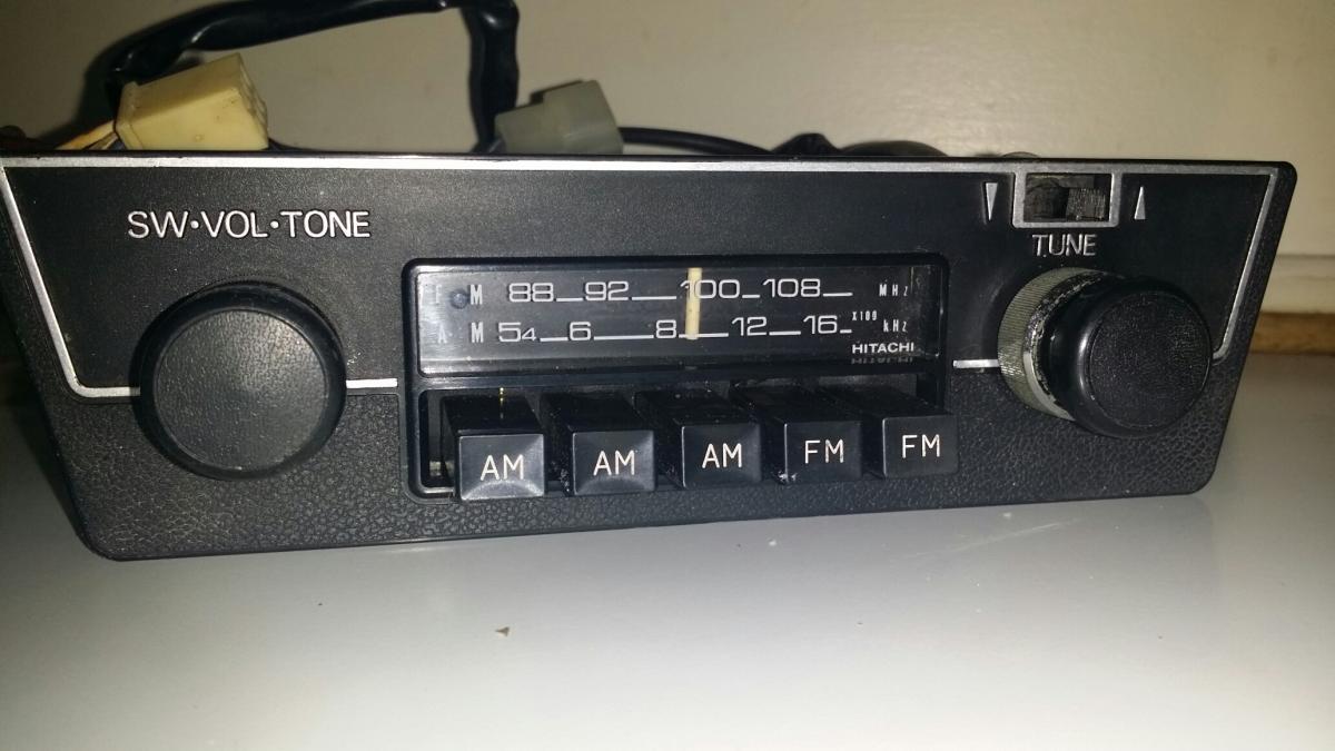

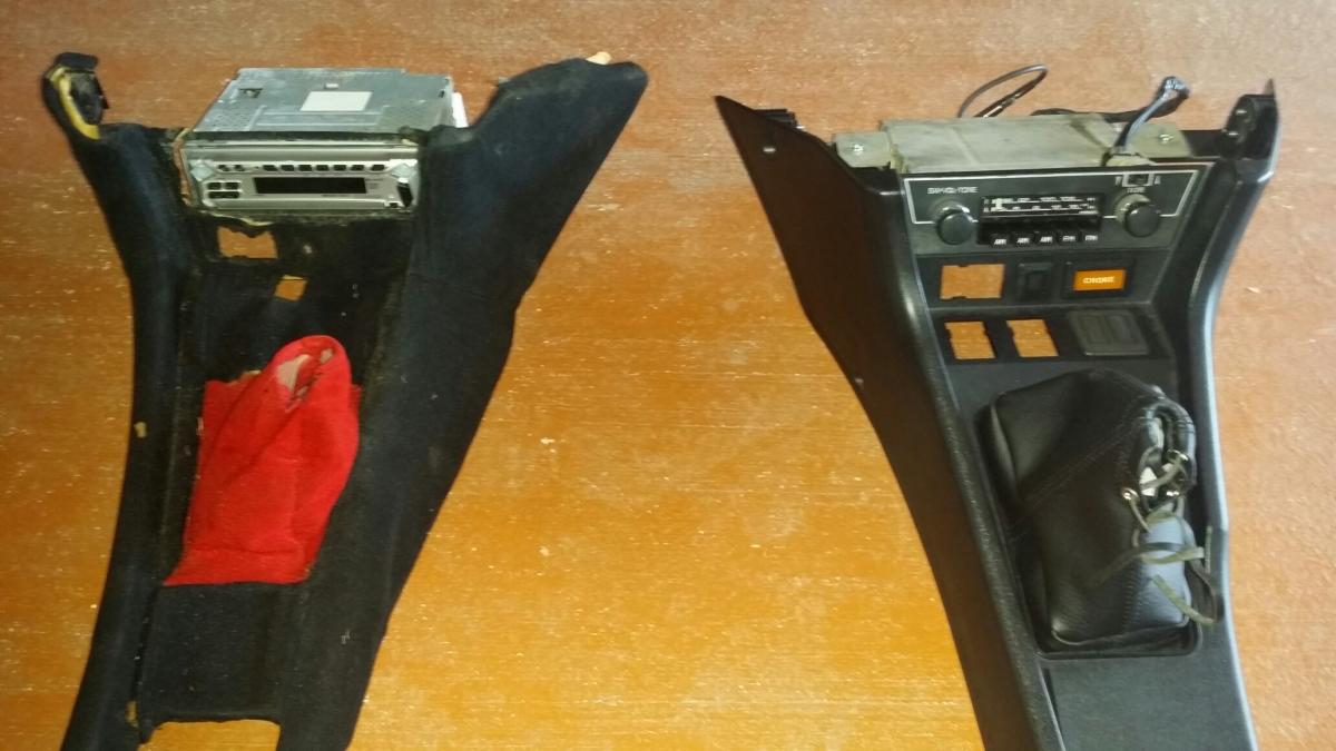

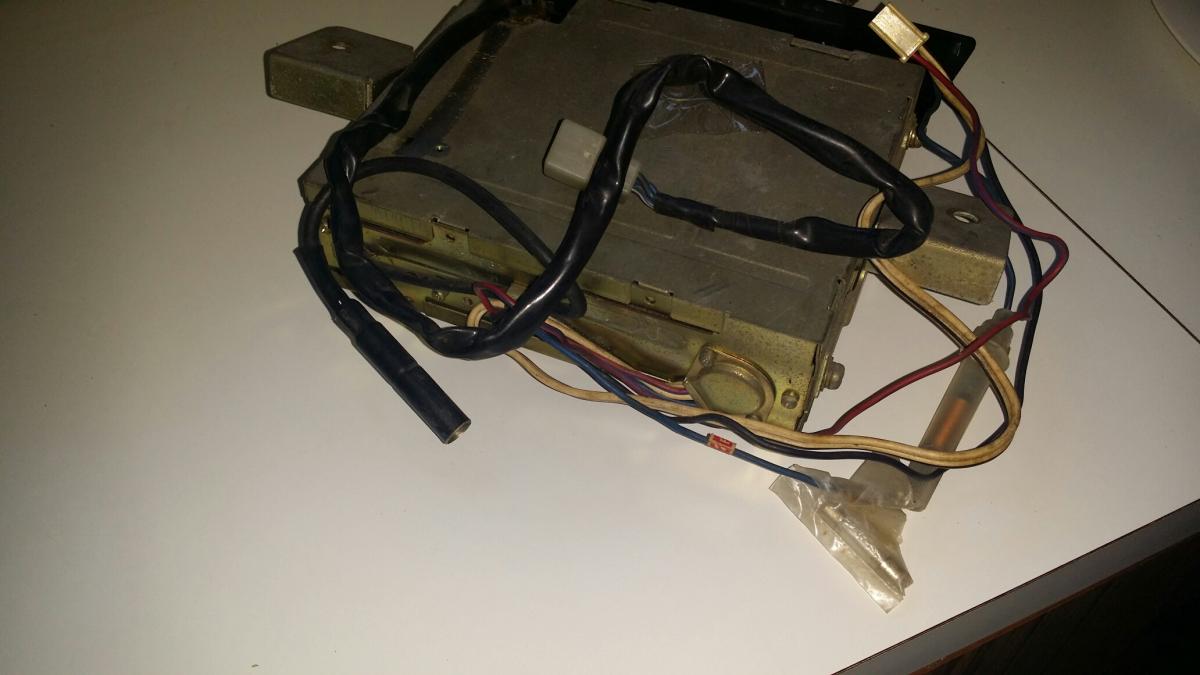

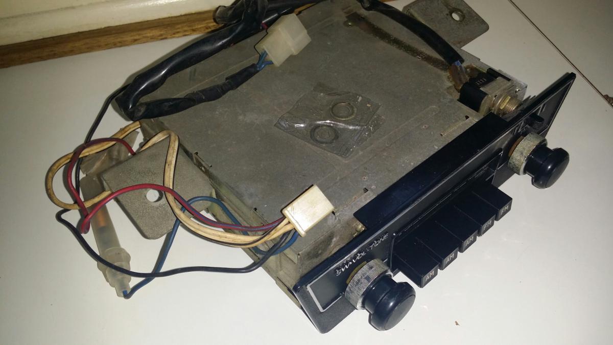

74zzz Posted September 22, 2015 Author Posted September 22, 2015 My radio showed up today and im stoked....this is in immaculate original condition still with original spare fuse taped to the back. Even though i have never used the current cd player i didnt want to cut into the nos console to refit and wanted the interior as it was in 74. All working functions lights and Ariel switch and for not even a third of the price they are charging on us ebay....... interior nearly complete...... gav240z and oldmates260z 2 Quote
Administrators gav240z Posted September 22, 2015 Administrators Posted September 22, 2015 Good score on that radio. Quote
74zzz Posted September 22, 2015 Author Posted September 22, 2015 yeah now the issue is rewiring, when it comes to electronics im a little special....are the connectors easy to come by? Quote
Administrators gav240z Posted September 22, 2015 Administrators Posted September 22, 2015 I'm not sure but the first place that comes to mind to try is JayCar hopefully they have those style of connectors. Quote
74zzz Posted September 22, 2015 Author Posted September 22, 2015 ahhh just assumed they would have been discontinued........makes sense, i guess they would have been pretty common to all cars of that era Quote
Administrators gav240z Posted September 22, 2015 Administrators Posted September 22, 2015 Just to clarify I don't know if they have them, but I would hope they do. Quote

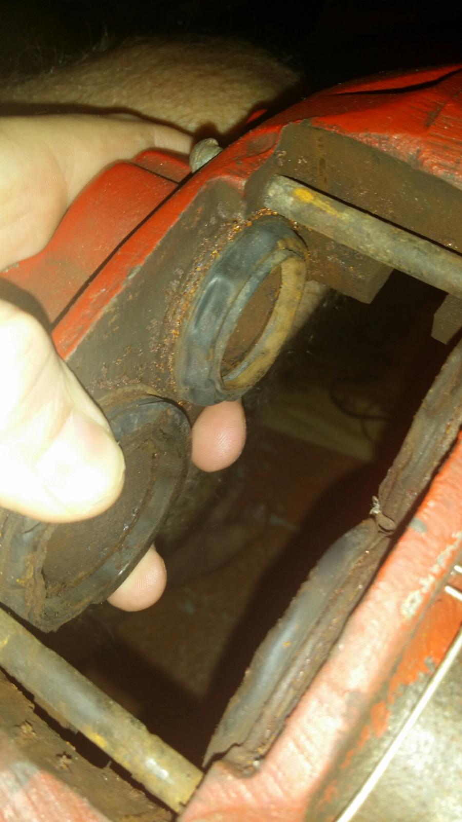

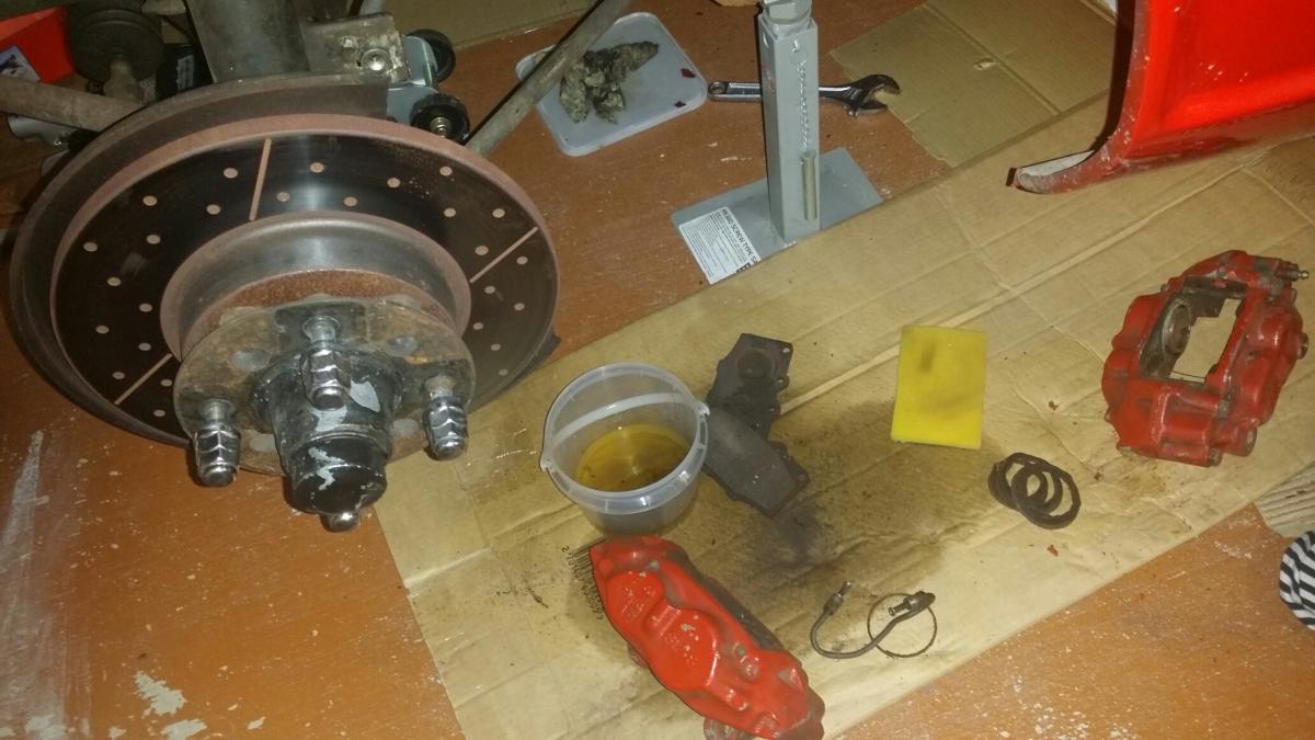

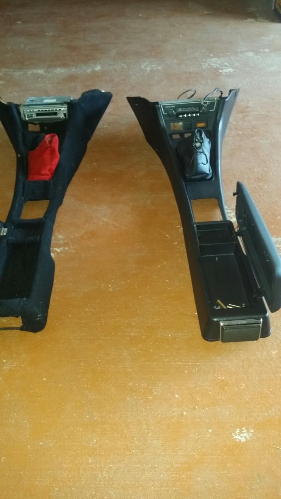

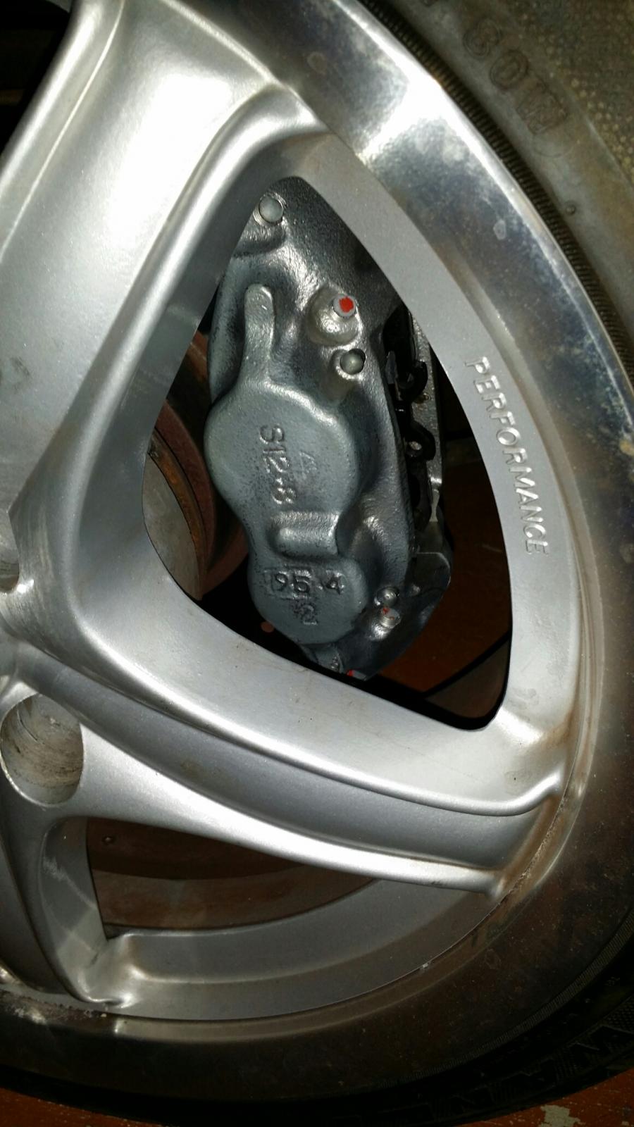

74zzz Posted October 5, 2015 Author Posted October 5, 2015 this weekends job was rebuilding the hilux calipers. was going to take them to a specialist thought id have a crack first. I replaced the rear cylinders last year and redid the hard lines so thought this would be maybe a 2 hours process. Im concerned 2 of the pistons have seized as there is no compression even when using clamps to push them down.....they were in a bad way and pretty corroded with the seals completely shot... not having an air compressor has made getting them out a little difficult.....any tricks? On the plus side the console is all done....was surprised it took so long i didnt think the bits and pieces would be so tricky to find. rewiring the radio and it all goes back in and is a massive improvement over the crappy upholstered one. Also begun suspension part collecting yesterday picking up some of daves rear control arms......and will probably get him to make up some of his falcon castor arms (if he's keen) next purchase will be the mca blues and front control arms Quote
Administrators gav240z Posted October 5, 2015 Administrators Posted October 5, 2015 That console! I want to see it installed though . Those brakes look a bit "how ya going alright". I think without compressor air it's pretty hard to get them out. I recall taking mine to some brake shops in Ireland (for my rx-7) and asking if they could help me get them out. Nobody wanted to touch them, I think they were all afraid of having someone come back to them after touching brakes. Not sure if you would get the same response over here? Someone once said to use a grease gun to pump the pistons out, but I would worry about contaminants, so I don't recommend this myself. Might be best to take it to a specialist brake place though? Quote
74zzz Posted October 5, 2015 Author Posted October 5, 2015 yep might have to...the sealing rings literally snaped in 2 when i was taking them off.....im assuming they will have to hone them if their seized? wondering with 200 bucks for the rebuild kits, blasting, getting new lines made up and putting them all back together i should just shell out for a willwood setup.....seems crazy to spend 100s on hilux calipers.......if i can get a kit from Aus i might do it wildy55 1 Quote
Cozza Posted October 6, 2015 Posted October 6, 2015 You could try connecting the calipers to the car and pumping the pistons out using the brake pedal The trick is to push all the pistons out as far as possible without any one of them actually popping out. You could try a block of wood the correct thickness to act as the rotor if you don't already have the brake rotors. At a guess sounds like you might need new pistons but the caliper will probably clean up ok. Good luck with it. Mick Quote

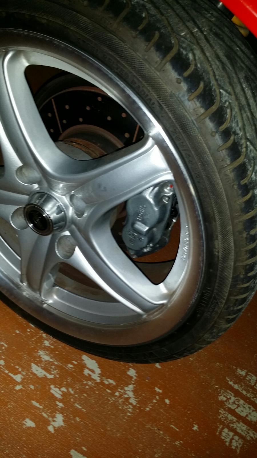

74zzz Posted October 18, 2015 Author Posted October 18, 2015 Got the CALIPERS back in 4hrs rebuilt and water blasted. Was a little scary how little brakes I had after going for a blast round the block with the sparkly ones bolted back on. I now don't come to an intersection white knuckled and praying it pulls up Quote
Moderators PB260Z Posted October 18, 2015 Moderators Posted October 18, 2015 (edited) I now don't come to an intersection white knuckled and praying it pulls upAnd that is what it is all about. Great result. Edited October 18, 2015 by PB260Z Quote
EJ101 Posted November 3, 2015 Posted November 3, 2015 My radio showed up today and im stoked....this is in immaculate original condition still with original spare fuse taped to the back. Even though i have never used the current cd player i didnt want to cut into the nos console to refit and wanted the interior as it was in 74. All working functions lights and Ariel switch and for not even a third of the price they are charging on us ebay....... interior nearly complete...... was this an ebay purchase or one you had restored? Quote
74zzz Posted November 4, 2015 Author Posted November 4, 2015 was this an ebay purchase or one you had restored? No grabbed it from US ebay......after seeing the rusted shells and broken ones needing restoring and replating i wasnt willing to spend the time when there is so much other mechanical work to do and the restored or Nos ones can reach over 1500 landed.....literally not a mark on it and the shell is in amazing condition for age......was a purchase i wasnt expecting to make but like many z owners i troll the sites and if there is something that i need/want for a good price i cant pass up a bargain haha got the bloke to send me a vid of it working and was a great to deal with. Quote
