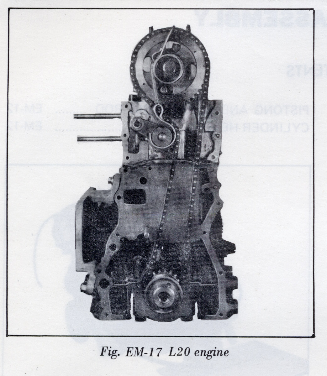

HS30-H Posted April 30, 2015 Posted April 30, 2015 Kameari Engine Works have always warned that their 'Twin Idler' cam chain tensioner is noisier than the stock Nissan arrangement. It's to be expected. Few people realise that the original L20 engine design incorporated a similar principle, and it was changed to the oil-pressure boosted 'foot' tensioner and long rubber-faced guides largely to make it quieter and more refined. KEW have never claimed that the Twin Idler kit is a power-adder per-se. Anybody who thinks it is should read the instructions again... Quote

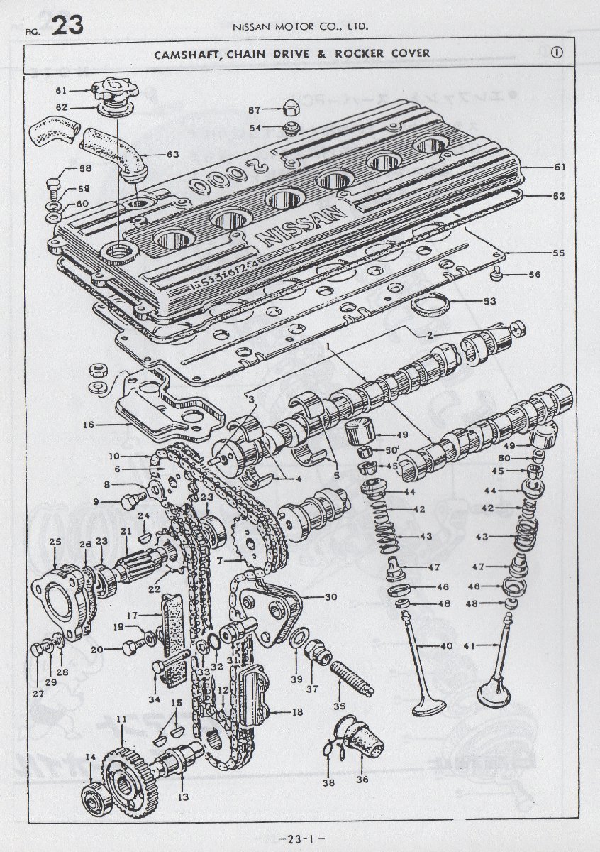

HS30-H Posted May 1, 2015 Posted May 1, 2015 Does the idler pulley sound anything like this? You can hear some kind of idler noise I think on this S20. But I think it might be the straight cut gear driven oil pumps Alan described here. http://www.gtr.co.uk/forum/236658-1969-nissan-s20-twin-cam-engine-rebuild-3.html#post2470802 Gav, The S20 engine sounds like that anyway (late straight-cut gear driven oil pump type or not) because the cam chain tensioning system design is effectively the same as the KEW Twin Idler: It has two small rubber-faced static guides and two jockey wheels - one of which is manually-adjusted from outside the engine to give the desired tension. In one of Prof. Stephen Hawking's parallel universes there's probably a company making and selling simplified oil-pressure and spring assisted chain tensioner conversion kits for S20 engines because the chain doesn't whip around enough and it's too 'noisy'... Quote

HS30-H Posted May 1, 2015 Posted May 1, 2015 . I've seen and heard plenty of people dissing the Twin Idler over the years. Most of the comments wash over me and are easy to ignore because the source is obviously an idiot. But when the barbed criticism comes from someone I have come to respect, it jars. Makes me think there's something else behind it. Loyalty, perhaps? I've had exchanges with PMC Race Engines on HybridZ where Peter implied that the KEW Twin Idler actually cost power. He eventually withdrew the comment, but his reservations are clear. So, you pay your money and you take your choice. The moral is probably that you should go with the Guru of your choice, but don't try to mix parts, data and advice from more than one Guru or you'll end up making a cat's arse out of it all. Quote

dat2kman Posted May 1, 2015 Author Posted May 1, 2015 My incar videos you can hear it, but also exhaust and gearbox. Quite happy at 7800 rpm As said, it sounds just like an old Holden six aftermarket cam gear drive, by Pete Jackson, where they ditched the stock bakelite fibre gear and replaced it with a steel gear. I've suppled a few of the KEW unts to both 6 and 4 cyl cars, mainly race, some rally. It's very easy to get them out of KEW. Before these were around, the likes of Graham and Stewart Wilkins, Les Collins, Murray Coote, and others had a few little well known tricks to offset mount the curved guide and stock oil tensioner plunger block, and increase spring tension, to reduce the prpensity of slack side chain whip. This stuff was done 35 years ago here! Quote
HS30-H Posted May 1, 2015 Posted May 1, 2015 Before these were around, the likes of Graham and Stewart Wilkins, Les Collins, Murray Coote, and others had a few little well known tricks to offset mount the curved guide and stock oil tensioner plunger block, and increase spring tension, to reduce the prpensity of slack side chain whip. This stuff was done 35 years ago here! The same tricks that were being used by Nissan's works race engine builders soon after the L-gata engines debuted. There's very little new under the sun in regard to these engines. Quote
