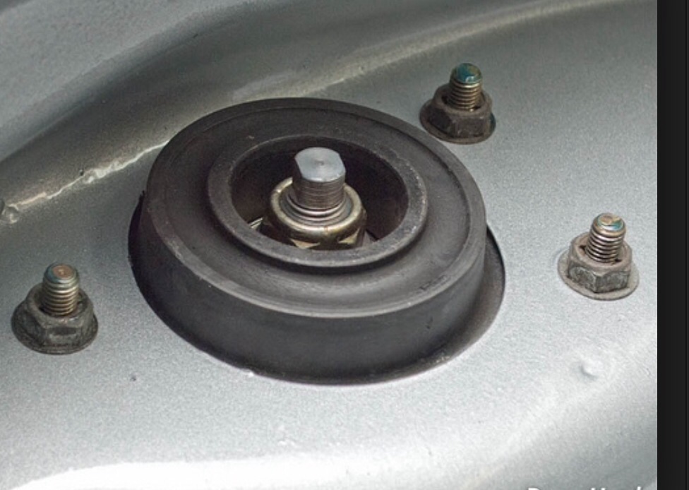

Moderators PB260Z Posted October 6, 2014 Moderators Posted October 6, 2014 Gidday Is the top strut bolt bolt still in place ?, or has the top hat failed ? A picture would really help make it clear. Cheers PB Quote
Cheeky1984 Posted October 6, 2014 Author Posted October 6, 2014 The car is at a friends but ill try and get him to take a pic for me. But from your photo the big bolt through the tower is in & the 3 bolts surrounding it are still in the hat but when we jack the car up the tower drops down. Quote

MaygZ Posted October 6, 2014 Posted October 6, 2014 Come on guys. Stop riding him It is kind of obvious that the metal plate in the rubber top hat has either pulled through or the rubber has separated and allowed it all to drop out (prolapse). You need a new top hat. Pull out the strut, fit the new top hat and re-install. Not a difficult task and probably about an hours work. Quote
dat2kman Posted October 6, 2014 Posted October 6, 2014 Not necassarily! If someone, ie previous owner, could have fitted lowered springs or cut down stock springs. This will cause the upper spring plate to "fall" with the spring, on jacking. Sagged springs can do this too! It may be that the rubber insulated strut top to body shell mount is just fine! Quote
gilltech Posted October 6, 2014 Posted October 6, 2014 I second dat2kman's theory, sounds to me that on full droop the spring is too short for the length of the strut rod, & the top spring retainer plate either drops down with the spring or can be slid down. Meaning that the front spring isn't captured at full droop as it's been either cut down (to lower the car) or replaced by an aftermarket shorter/stiffer item. If so would be the same on the other side. But if it's only one side then MaygZ could be right, that the top shock 'hat' metal/rubber assembly has structurally failed for some reason. Quote
