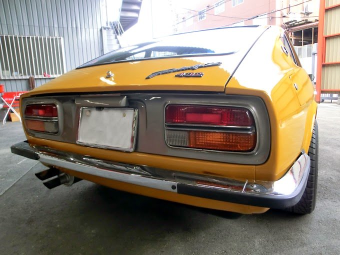

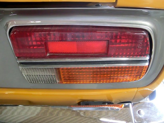

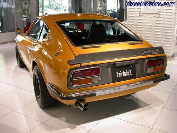

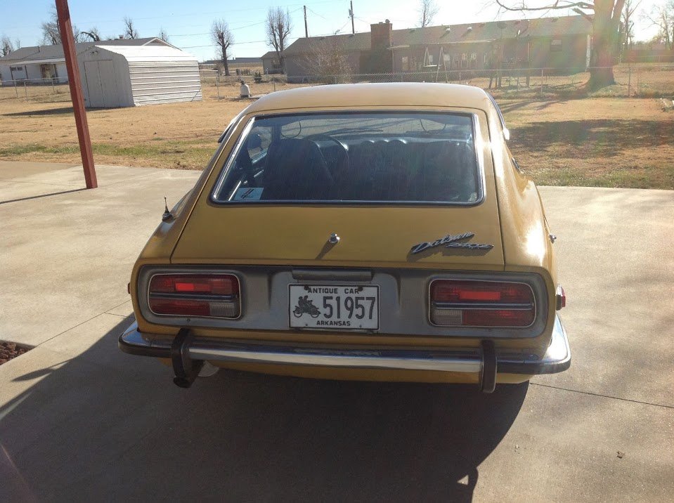

Administrators gav240z Posted July 9, 2014 Administrators Posted July 9, 2014 Hi Guys, Does anyone know where you can get paint that matches the original 'Datsun Grey' used on the rear light panel, front grill, hub-caps etc? Seen here also: I found this comment in a thread here: http://www.classiczcars.com/forums/open-s30-z-discussions/26354-have-rear-panel-painted-leave-black.html#post265331 But I'm not sure if we have those paints available in Australia? Has anyone found a suitable product locally? Quote
gilltech Posted July 9, 2014 Posted July 9, 2014 That grey rear panel on that Oregon car doesn't look at all right..., maybe it's the photo though....but the original colour I'm familiar with is a far darker grey & has a metallic fleck in it, not a solid colour. More of a charcoal than a grey, unless there were variations over the years? Similar with the grille, & again on the hubcaps (yes I had an unrestored set until on-sold a few years ago). Quote

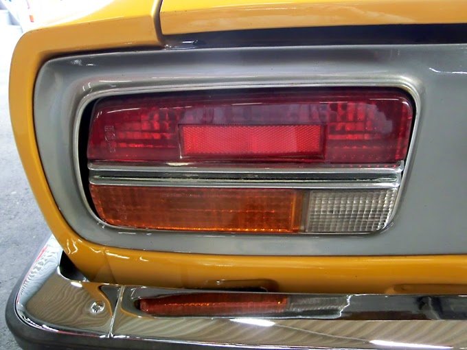

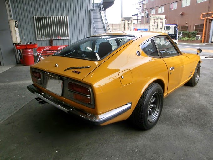

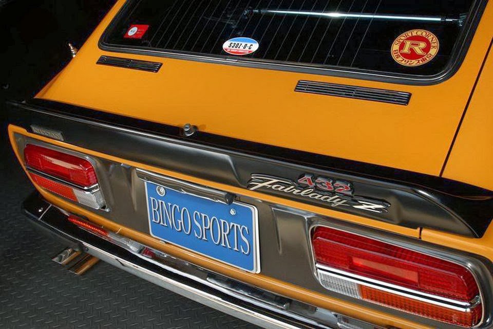

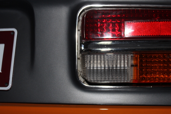

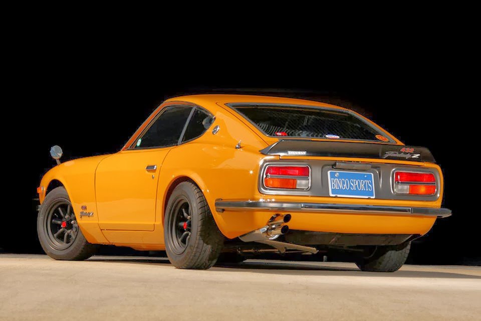

Administrators gav240z Posted July 21, 2014 Author Administrators Posted July 21, 2014 It would seem lighting makes this grey panel look quite different. Here are some examples. But I found this and quite like the way it looks. I'm guessing this isn't original though? Looks like a gloss / sheen to it. Have to say though it looks good against 920 gold. Quote
gilltech Posted July 22, 2014 Posted July 22, 2014 Yes it does look a little too glossy to be original. But if it was in really good original condition or a NOS part the owner might have applied a clear coating over it to preserve it perhaps? Personally I think a low sheen or a satin finish panel across the back looks better. And that was what was typically used back in the day. Quote

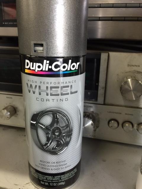

chris240 Posted January 13, 2015 Posted January 13, 2015 It seems the Americans are using this colour for the rear light panel and for the hubcaps. Duplicolour # 102 Graphite... Try image googling duplicolor 102 graphite for images... (Use American spelling for "color") I just compared my hubcaps to the rear light panel and the colour is damn close.. For $20 on evilbay, could be worth a shot. Not sure about the flares, but personally would prefer gloss...the light panel is definetely flat-matte. http://www.ebay.com.au/itm/Duplicolor-High-Temp-Wheel-Paint-Graphite-11-oz-Aerosol-hwp102-/321637505107 Quote

SacCyclone Posted April 15, 2016 Posted April 15, 2016 We have been using this for several years after comparing several different rattle can variants to a couple of original paint cars. HWP102 Graphite. Seems to work well without too much gloss. gav240z and GongZ 2 Quote
Administrators gav240z Posted April 15, 2016 Author Administrators Posted April 15, 2016 Thanks, I still haven't had a chance to use a colour Spectrometer to check what value it spits out. So good to know Dupli-color has something close. Good news is we get Dupli-Color products here. SacCyclone 1 Quote
GongZ Posted April 15, 2016 Posted April 15, 2016 (edited) A topcoat of matte or satin clear might solve the gloss issue too. Edited April 16, 2016 by GongZ SacCyclone 1 Quote

GongZ Posted April 20, 2016 Posted April 20, 2016 Hi ilbert, As Gavin said earlier in this topic, an original tail light surround with the factory paint will have discoloured by now (unless its an unused NOS item). Most of the US 240Z owners use Dupli-Color High Performance Wheel Coating - HWP102 (as mentioned above by SacCyclone) followed by a matte clear paint. For the clear they use Rust-Oleum Painter's Touch Multi-Purpose Paint - 1902 Matte Clear, but I am sure there would be other alternatives available locally. If you want to use a compressor and spray gun, the best advice seems to be to follow the formula given in Wick Humble's book "How To Restore Your Datsun Z-Car" (pp 174-175), which states; "A good match for the original paint is Ditzler Duracryl DDL 2862 Argent with quite a bit of suede additive. The formula is: 1 pint DDL 200 units DX265 300 units DX264 Thin 100-150% and spray on fairly dry. Regulate air pressure to the high side. Swirl paint around in the cup constantly to help keep texture additives in suspension. Maintain spray gun distance and overlap coverage on the final coat, or variations in surface texture may be unacceptable. This paint should have no gloss, so don't expect any! Unmask trim as soon as paint has had a few minutes to flash up." ( Your painter should understand this - I don't - eg. what volume of paint is a 'unit'? ) Most also agree that the same colour (and matte finish) was used on the grille and hubcaps. References https://www.google.com.au/search?q=240z+rear+gray+grey+paint+formula+mix&rlz=1C1ASUM_enAU514AU514&oq=240z+rear+gray+grey+paint+formula+mix&aqs=chrome..69i57.21775j1j7&sourceid=chrome&ie=UTF-8 http://www.zcar.com/forum/10-70-83-tech-discussion-forum/309987-original-genuine-colour-rear-panels-240z-grey-satin-embossed.html http://zclub.net/forum/showthread.php?t=25179 http://www.classiczcars.com/topic/43064-240z-tail-light-shroud-color/ http://www.classiczcars.com/topic/12172-color-for-grillrear-tail-light-panel/#comment-84914 http://www.classiczcars.com/topic/5136-what-is-the-correct-color-for-the-rear-tailight-panel/ Quote
