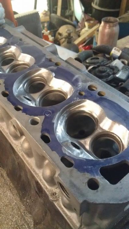

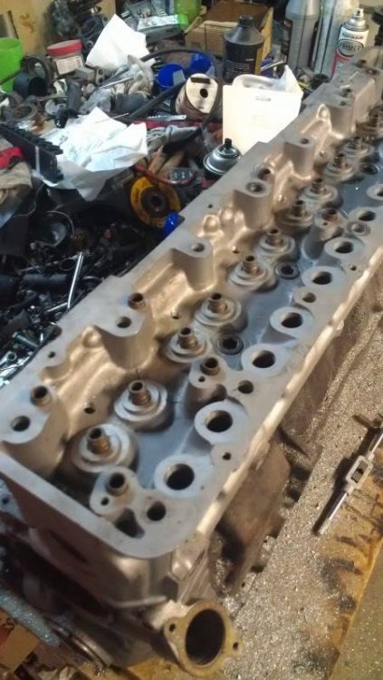

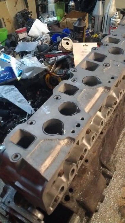

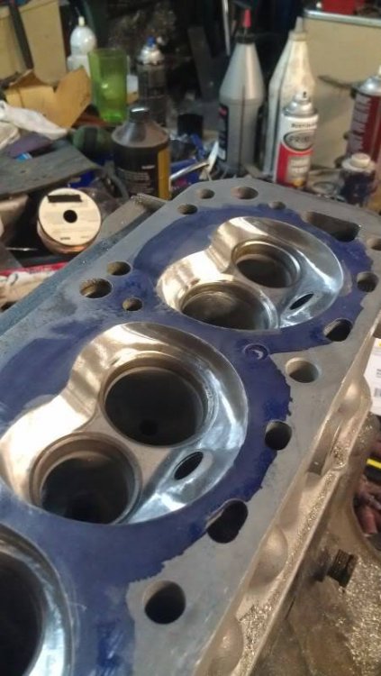

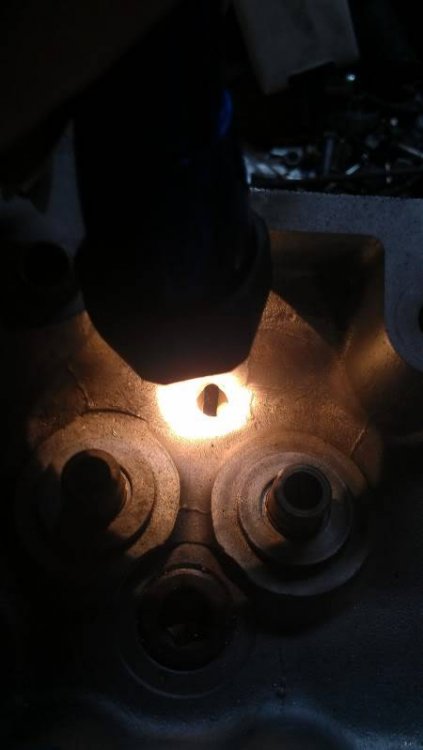

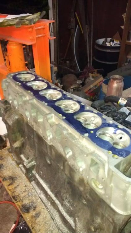

Xnke Posted May 20, 2013 Posted May 20, 2013 Getting started on the P90 head I picked up a while back. This is the beginning of what I would consider a full effort street port, since working the chambers much harder than this results in limited life. I have not started on the ports yet, just worked on the chambers and the water jackets. I'm getting this going now, since i pulled my N42 off to change a suspected blown headgasket, but turned out the head was cracked between cylinders 2 and 3, right on the deck surface. This is for the M62 supercharged engine; I saw 68kpa of boost before I noticed the temps just kept climbing... Valve unshrouding: Water jacket modifications...AKA "Why the hell are you drilling holes in that cylinder head?!?" Because down inside here, the exhaust port and intake port are connected with a web of casting flash. It shouldn't be there...I got in with a small drill bit and drilled and chipped out all the casting flash between the ports. Marking out for the port sizing. Intake valves will remain 44mm diameter, and exhaust valves will be cut down from LS1 exhaust valves, to 36mm diameter. The LS1 valves need to have the diameter reduced, margin thinned, 25* back-cut applied, the stems cut down by 8.3mm, and the keeper groove re-cut lower on the stem. Even with all that work, it's cheaper to buy a set of Manley LS1 exhaust valves, cut them down and re-groove, than it is for a set of Ferrea standard alloy +1mm L28 valves. The circled bolt holes will get drilled and helicoiled, as they often pull out in normal service and the threads gall up occasionally too. I use 2D series helicoils for this as they are twice as long as the normal ones. Quote

Xnke Posted May 20, 2013 Author Posted May 20, 2013 Hate to break it to you Peter...we've been doing this for nigh on 10 years now that I know of... This, combined with external water lines over #5 and #6, are how we on this side of the pond run 680HP turbo motors on the street, daily drivers. It's REALLY effective! My air hammer broke, so I am dropping the head off at my machinist's to have the guides knocked back, this 'un will be getting a TK style port job. (Last one of his datto heads I read on saw him make 204CFM intake at 400 thou lift!) It doesn't look like a US port when he's done, but I can't argue with the results. Valve guide boss removed, guide tapered, ports worked to 40MM...I'll be stopping at 38mm. Quote

Xnke Posted May 20, 2013 Author Posted May 20, 2013 Interesting. I have two heads that this was done on, plus I do it on all my "more than street work" heads. Granted, I don't do much for many, yet. I learned about the casting flash from Rebello Racing, back when I first started in Z cars. having a hard time deciding if a 36mm exhaust valve is the way to go. The seat inserts will barely hold the bigger valve, but the ID of the seat insert is smaller than the port by more than I am comfortable with. Stock valves will have the best curtain area and be the least shrouded, +1mm exhaust will be acceptable in the chamber, but only just. the larger valve will allow me to open the seat up more and remove most of the raised lip under the insert, though. Any pointers there? Quote

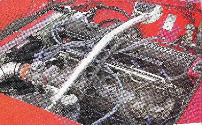

redrbzed Posted May 21, 2013 Posted May 21, 2013 Hello one and all, Here is a pic of my old L28T engine from 1995, notice water manifold (black with blue lines feeding it). This mod was done by a gentelman by the name of John Bennet. cheers, Sinisha Quote
luvemfast Posted May 21, 2013 Posted May 21, 2013 Geez Sinisha. You print that pic out on a dot matrix printer? On a side note. I'm actually quite famous in my primary school for inventing the "head lock". True story Point being. Just because I'd never seen it before, doesn't mean it had never been done! Everyone keep posting. You're all beautiful, ladies. Quote
Administrators gav240z Posted May 21, 2013 Administrators Posted May 21, 2013 Hello one and all, Here is a pic of my old L28T engine from 1995, notice water manifold (black with blue lines feeding it). This mod was done by a gentelman by the name of John Bennet. cheers, Sinisha I can definitely confirm this, I know that engine went to a guy by the name of Jack Kuzior who I haven't seen or heard from in years now. I recall him talking about the custom head re-drilling and cooling mods due to cylinder #5 (my memory here) getting hot under the collar. The head was N42 casting. This is the car the engine was in last I knew of. http://www.autospeed.com/cms/A_108383/article.html Quote
