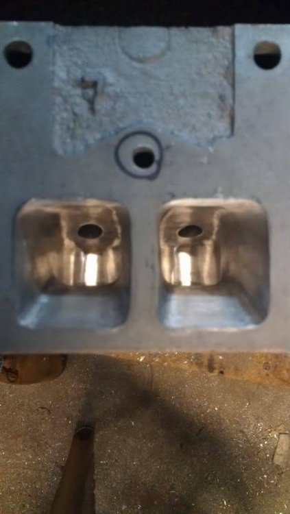

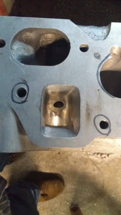

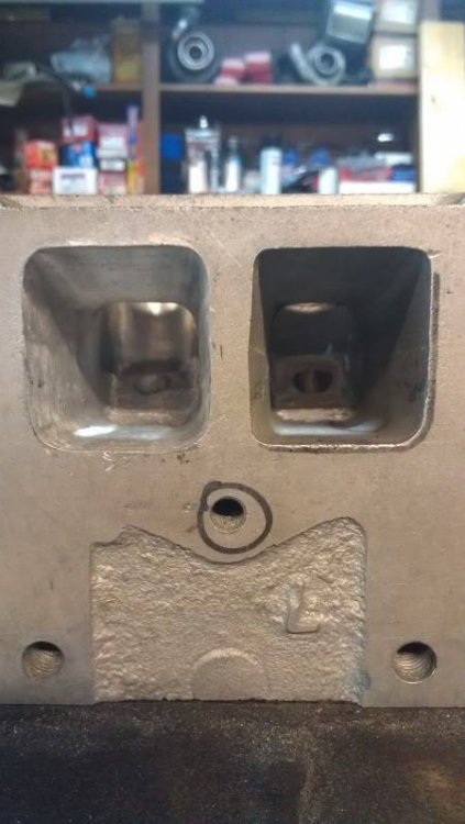

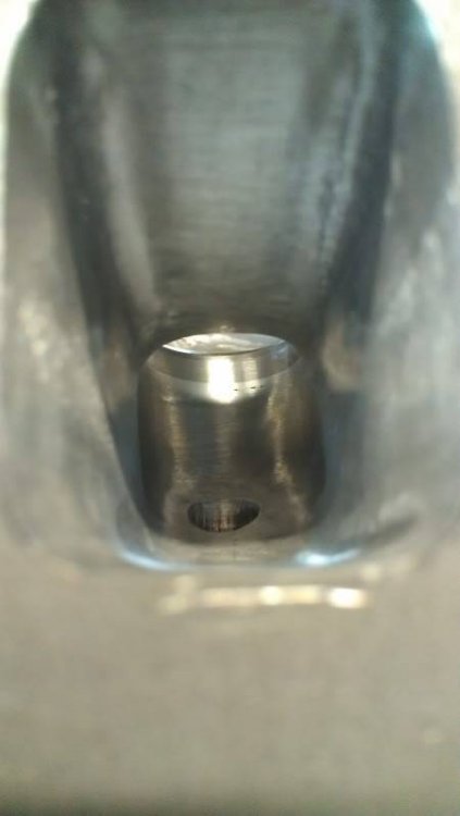

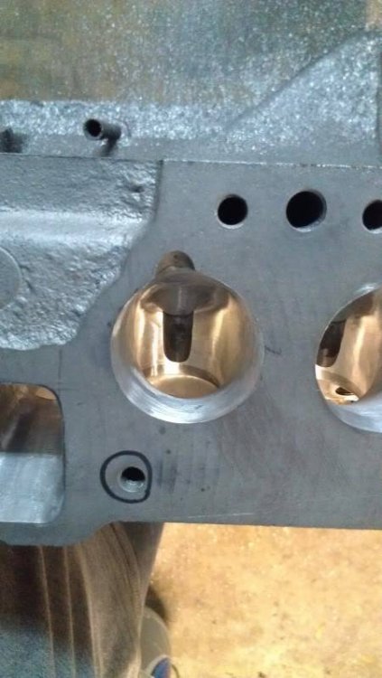

Xnke Posted June 5, 2013 Author Posted June 5, 2013 Porting updates: Exhaust ports are finished, will get a final 120 grit finish before the flowbench and will get polished after. I have one intake port roughed in at 37mm, finished port will be 38mm. Progression of an exhaust port: Good shot of a finished port: I swear this port isn't as wonky as it looks...the port floor is level with the deck surface. I went and checked twice after taking this photo. Quote
d3c0y Posted June 5, 2013 Posted June 5, 2013 Nice work! Get that sucker to the flow bench on a couple of finished ports to see if it's working maybe? Quote
Xnke Posted June 5, 2013 Author Posted June 5, 2013 It's a known good template set that I am working from, the flowbench is just to equalize the ports. Even though the ports are worked to match a template, it's possible to have them off as much as 30CFM from each other. Quote
peter mc Posted June 5, 2013 Posted June 5, 2013 Man if i ported a head and it had 10 cfm different between ports Les would kick my ass, i flow every port and 3 cfm is the max I'm aloud , Quote
Xnke Posted June 6, 2013 Author Posted June 6, 2013 Yep. That's why I'm trying to find a flowbench to balance them out! I'm not THAT good...I don't get to do this every day. Every couple months I do a few single-cylinder and two cylinder engines, sometimes a set of VW heads. I have done datto heads a LOT, but it's a cut-and-try thing. As it is, I use templates to match the ports up as close as I can get them, but even then I have a long way to go before I can really skip a flow-check. The exhaust ports I have pretty damn tightly matched, volume and shape wise. Each port matches the templates within 0.040", and that's just one port that is out that much...the rest are half that out. One of the combustion chambers has a small casting error, the exhaust valve seat is a little closer to the chamber wall than the others, and the intake is a little further away. Can't move them as much as I need to...the port wall would get into the valve seat area. I'd need to go to a slightly larger valve to get the seat pushed out enough. If this was a race car...I'd already have fixed the issue. It's not a race car...it's my daily driver, that I've been without for nearly a month now. I'm getting impatient and it's getting harder to convince myself that close enough is not close enough. Quote

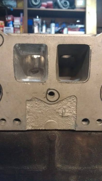

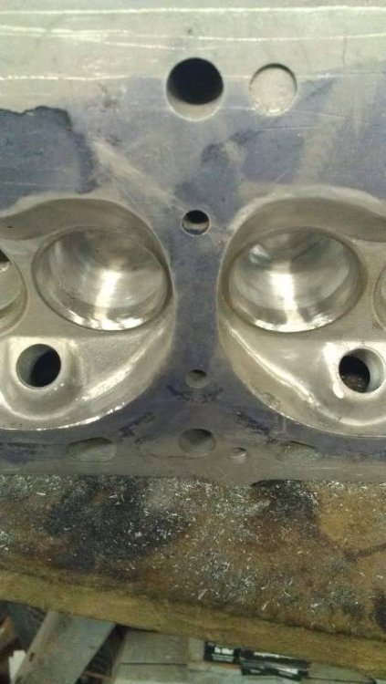

Xnke Posted June 14, 2013 Author Posted June 14, 2013 Had a bit of mixed luck this afternoon! I missed a buy of a 1976 Toyota RA22 Celica by fifteen minutes...the car sold for scrap metal to a dealer. I have called said dealer trying to throw money at him to get it before he crushes it. BUT! I found a local flowbench and slapped the currently-37mm-ish ports on it, and did a little flow work! This is with what's left of the old valve job, on used, but clean, stock-sized valves. I lapped the valves in to get them to seal up closed, but that's about it. The top angle of the 3 angle job is still there, but a lot of the bottom angle isn't or is modified from the die grinder. Lift - Intake Flow .1 - 62.4 .2 - 117.1 .3 - 157.8 .4 - 199.1 (FIGJAM!) .5 - 214.1 Lift - Exhaust flow .1 -- 51.4 .2 -- 80.3 .3 -- 102.1 .4 -- 128.8 .5 -- 134.1 Not too bad! I have no idea how this compares to a stock port; as I don't have any heads with stock ports except a Maxima N47. I also have no idea if this bench is padded/accurate/garbage...it's an old garge-built unit that seemed pretty consistant, though. I was getting very close to the limits of the bench, I had the air valve wide open to get the full 28"WC for the upper end of the intake flow. A guy in the back of the neighborhood has it, but he's moving out this week. I saw it in his garage and asked if I could borrow it for a few minutes. An hour later, I was done and helped him load it into his moving truck. I asked...he didn't want to sell. I have a very good idea of how to copy it though... Quote

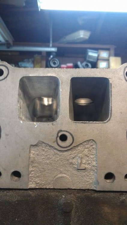

Xnke Posted June 19, 2013 Author Posted June 19, 2013 That's a finished intake port, The flow at 37mm was good enough that I blended the roof and sides into the 38mm intake manifold and called it done. The head goes to the machine shop for a proper valve job, S3S, and a second pressure test to make sure this one isn't cracked or ported badly...It happens. Quote
