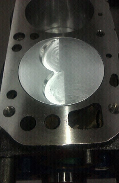

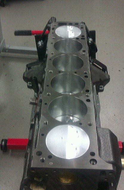

peter mc Posted May 16, 2013 Posted May 16, 2013 BEST we start over was all i could say , Owen had a friend build his stroker and had used all the cool parts ,but things did not go to plan , The new pistons were damaged because the block was not as clean as it should have been , so the bottom end needed to be rebuilt from scratch with new pistons and a re-bore specs , for the build pistons forged sps 90+mm crank 83mm stroke kemeri rods 138mm head to be built by Les and me , with 46mm inlets full race port and will be a P90 comp will be 10.5 induction is EFI hardwere itb exh will be SW race pipes and 3in magaflow this is the block as it is today pics to come as it get built and there will be a dyno vid as we tune the ECU Quote

Gordo Posted May 18, 2013 Posted May 18, 2013 Owen, saw your engine yesterday , Peter tells me your block has a special quality for a big bore. Well done with that one. Also saw the 3.5lt block and crank. The work that these guys do is amazing. To get that crank to fit inside with the clearances . They have to grind out the oil line in the block and rebore another one! Cutting edge stuff. Way ahead of other engine builders, they wouldn't touch that stuff. If you want the Best Engine. Take it to Peter and Les. They relly know the craft. I just want one.( but you already have one) yer another one! Bigger and better. Cheers guys ,great work. Quote
ZED83 Posted May 18, 2013 Posted May 18, 2013 Yeah It can go out to 91mm! Very lucky I guess. The guy at the machine shop that done first bore out to 89.5 was freaking out, wait till I tell him it can go out this far. Did you see the water mod? that things unreal, it's a work art! Quote

DatPilot Posted May 27, 2013 Posted May 27, 2013 Lovely stuff! Is it 'sonic testing' to check how far you can bore? Quote

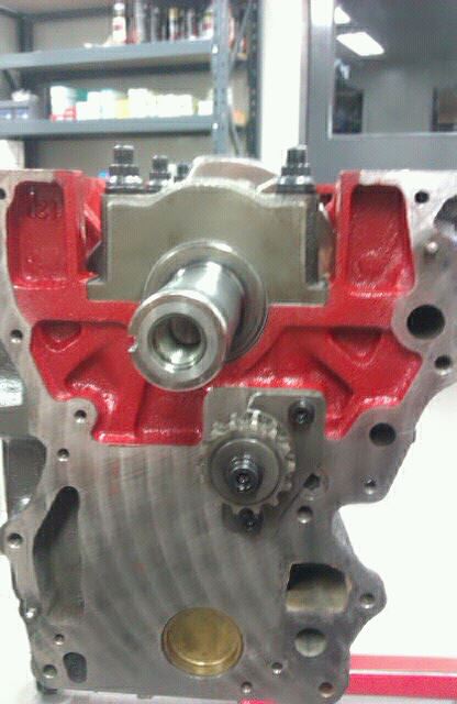

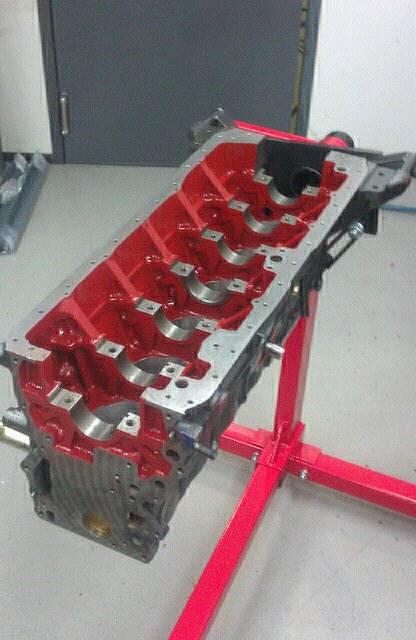

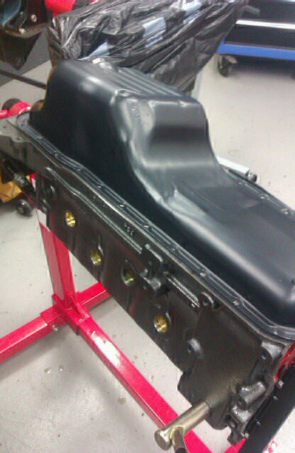

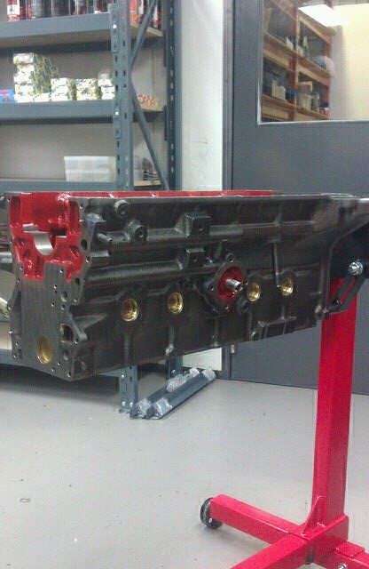

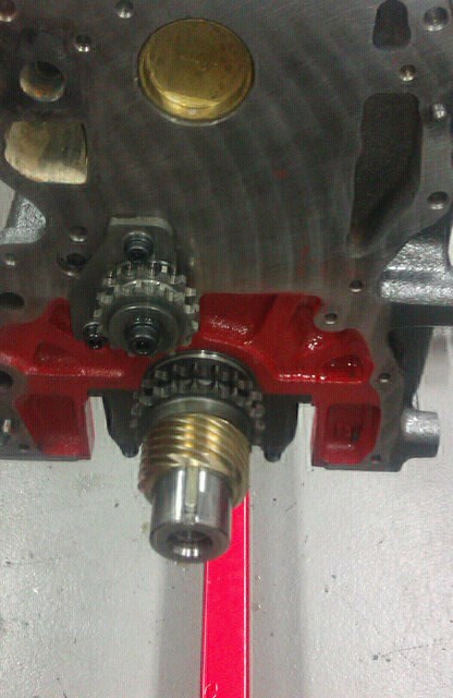

peter mc Posted May 27, 2013 Author Posted May 27, 2013 Hi Owen More pics off the bottom end, its all together now, looking good , i removed all the old paint off the sump and parts that were painted blue and removed the paint from all the bolts to get a better finish , next will be setting up the head with the new springs and cam , And yes sonic testing is to see if its safe to bore , as this block was 89.5 it was realy close to getting a new block , but after sonic testing it was found to be a very thick casting Quote

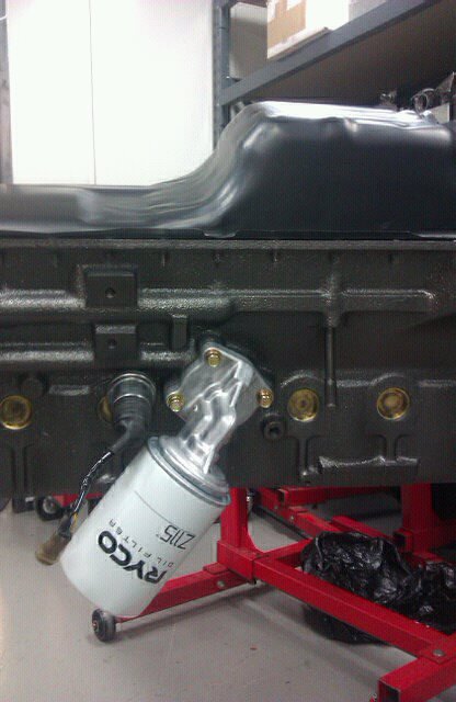

peter mc Posted May 27, 2013 Author Posted May 27, 2013 Just 2 more Also soda blasted the oil filter adapter so it looks a bit cleaner Quote
