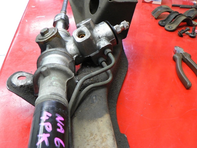

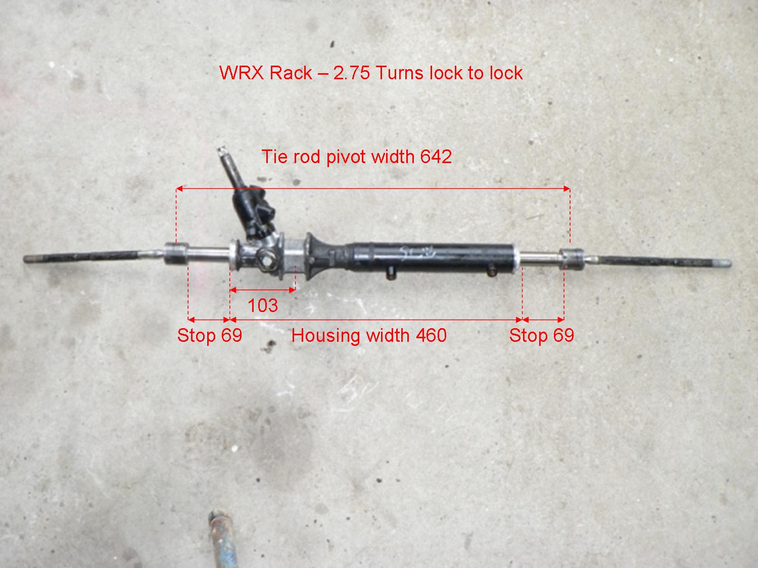

Firstly the racks themselves:
Subaru - did a lot of research on the interweb and while it sounds like most suby racks look the same they come in many different ratios. Most shopping car subies are 3.2 - 3.5 turns lock to lock. The standard Z rack is 2.6 turns so I was looking for something closer and WRX's are 2.75 or STI's 2.5 and a thing called Spec C is 2.0 turns (but very hard to find). Found a WRX rack for $200.
MX5 - Have to use the first generation NA model rack as the NB went to a completely different mounting method. Good news is they are 2.7 turns lock to lock, bad news is I was told they are sought after as many NA's didn't have PS originally. but i paid $250 incl hoses and uni joints from All maz in Clayton.
I spent some time measuring and comparing dimensions.

Now this is where the fun starts....and time for all you suspension guru's out there to chime in!
My biggest concern is poor steering and feel so bump steer is going to be a factor. The centre to centre width of the LCA mount holes on the Z cross member are 600 mm apart and the standard Z rack measures 610mm between the pivot points of the inner tie rod ends IE the rack is 10mm wider than the LCA mount points. Both the Suby and MX 5 rack are significantly wider at 642mm and 650mm respectively at the pivot points. Surely I'm headed for bump steer city?
It looks like its possible to move the LCA points up and out quite some way to compensate but then I'm looking at too much neg camber. Anyone know what sort of camber you get from relocating the LCA points? The car will need to be engineered for rego so I'm hesitant to go with mods like camber plates and adjustable LCA's at the moment, once its rego'ed then yes.

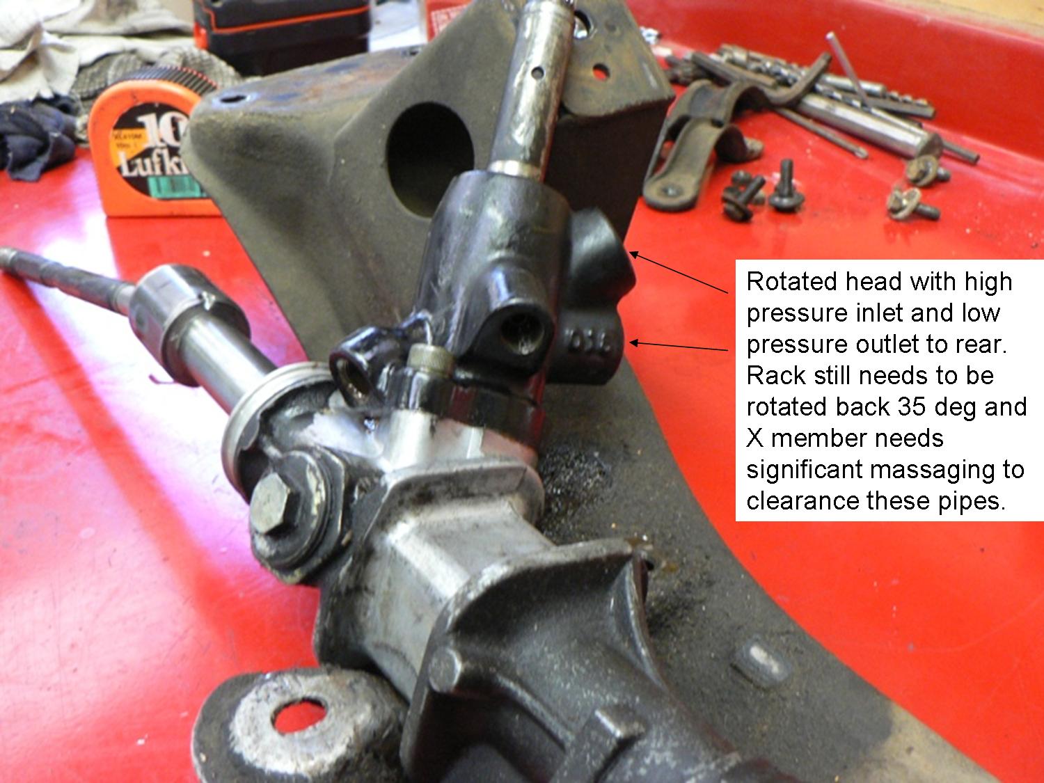

Installation:
The Suby rack really needs the power head rotated 180 deg so you get better clearance between the pipes and the X member. Ive done this but as per the photo below, once you rotate the rack back you're still going to have to modify the crossmember to provide clearance for the low pressure outlet on the back side, additionally you will need to make up new lines from the power head to the rack piston as well, all no big deal but not really neat and sure to attract the attention of the engineers at inspection time. Also the Suby rack has more total lock than the Z rack (69mm's each side from centre to full lock compared to 60mm for the Z) this may cause clearance issues at full lock for maxed out wheel/tyre packages.
The MX5 rack is a much tidier and neater installation. The lines to and from the pump are well out of the way and the lines from the power head to the rack only slightly interfere and will only need a slight tweak by hand to clear everything. both racks will require a notch and reinforcement of the engine mount, but one specific issue for the MX5 rack is that it sits 10mm off centre to the left, not too big a deal as it only needs the tie rod lengths to be 5mm shorter/longer on the respective sides to bring the rack back to centre and equidistant from the LCA points and don't think it will result in clearance issues on full lock.

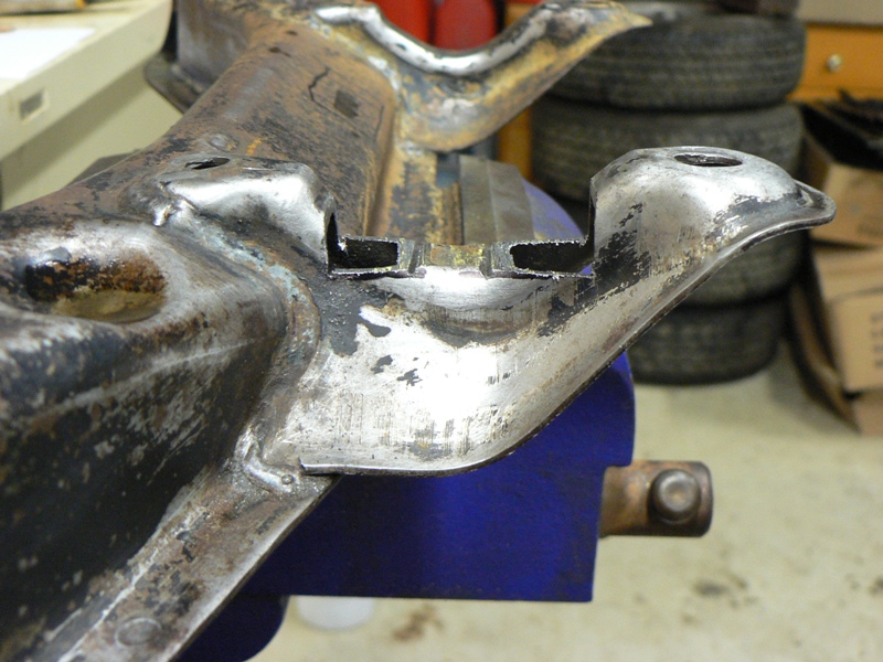

Mounting the MX5 rack requires a small amount of modification to the original Z cross member mounts and use the Mazda rubber isolators.
Im going to wait for comments before going any further but Im pretty keen on the MX5 option so far.

Last for now...basic cut to test fit MX5 mount

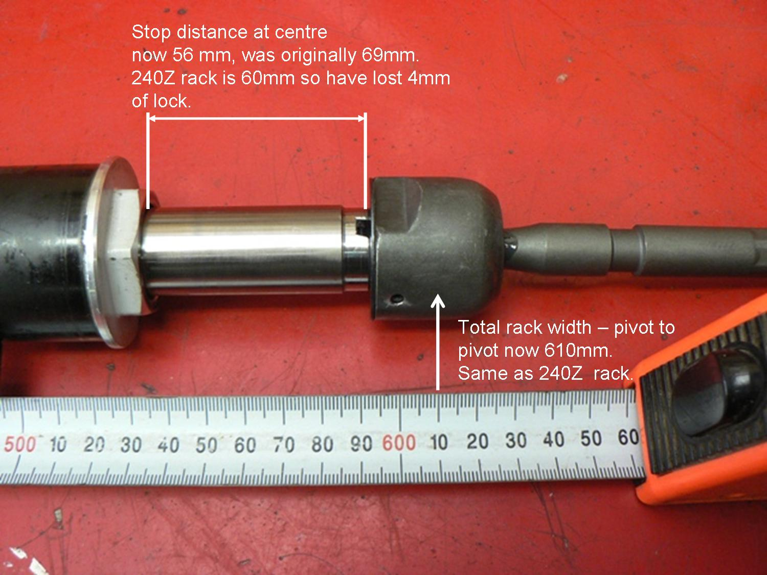

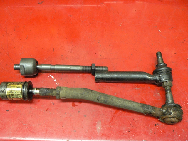

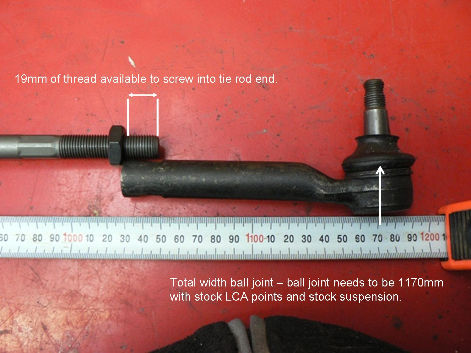

Ive decided to go with WRX rack in preference to the MX5, primarily because I want to ensure I don't aggravate any bump steer issues. (My car will need to be engineered for rego so the closest it is to stock geometry and look the better, I can change LCA position and fit adjustable suspension once its regoed).
While the MX5 rack is a far easier and better looking installation the inner tie rod pivot to pivot distance is 40mm more than the standard Z rack and will definitely cause bump steer issues...and the rack cant be cut down without loosing a significant amount of your steering lock meaning you will be doing 3 point turns everwhere. Too many compromises in my book.

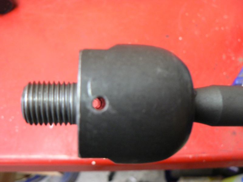

The Suby rack is 32mm longer (inner tie rod pivot to pivot distance) than the standard Z rack... but it can be cut down because it has 9mm more travel in each direction from centre than the Z rack (see my first post for "stop" measurements). Essentially you can cut 9mm off each end and still have the same turning circle as a standard Z. However taking the 9mm off each end will still leave the Suby rack longer than the Z rack so I'm going to take 13mm off each end which will sacrifice a small amount of turning circle but this combined with the shorter inner pivots (explained below) will end up with the rack being the same pivot to pivot length as the Z rack. All good.
Courtesy of Hybridz and others there are a few alternatives for tie rods:
1. Cut and re-thread the Suby inners and use N14 Pulsar outers.
2. Use Volvo S70, or 82-88 Tercel or 91-95 Camry inners and use standard Z outers but you will need to have  two of the RHT Z outers as most modern stuff is all RHT not a combination with LHT like the original Z's.
3. Use the standard Suby outers (same tapper as the Z steerring knuckle so it bolts up) with 84 Celica (model code RA65 for the Aussies) inners.
Ive chosen to go with option 3. as I can use the Suby outers that came with the rack and one of my inners was worn and had to be replaced anyway so buying the Celica inners was easiest. The local powersteering shop I went to was very helpful (Supasteer in Bayswater), they had the Celica inners on the shelf and they were exactly what I needed. Reality is that there are hundreds of inners made and if you need something slightly shorter or longer it will be easy to find as there are many cars that have M14x1.5 thread at both the rack and outer end of the inners.
I took the rack to Robco Engineering this arvo and explained what I needed done and Rob C was very helpful, in fact he can cut the rack down without disassembling which saves on the cost of new seals etc which you would need to replace if you do disassemble it. Will post some pics when I get it back.
Pics below show how the distance from the base to the pivot point of the inner pivot is shorter on the Celica compared to the Suby inner...bonus as this effectively shortens the rack another 2 - 3mm each side. Also pics of the Z tie rod compared to the Suby/Celica version.
Cheers.
