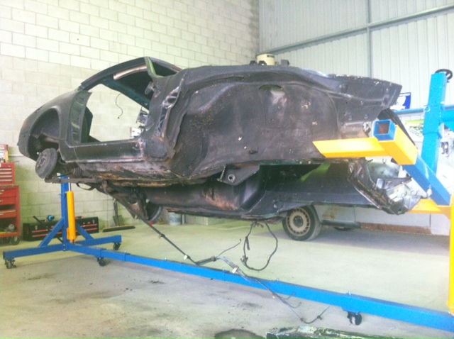

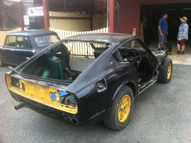

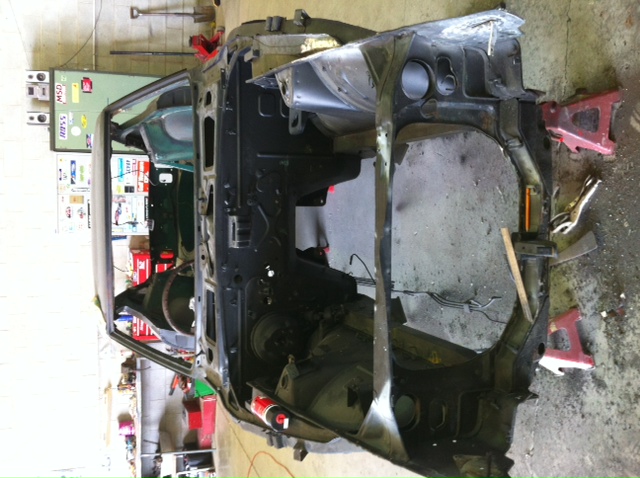

potter260 Posted April 8, 2011 Author Posted April 8, 2011 Heres some of my radiator support at the bottom does any one think thats bent ? The chasis rails dont look the best either?? Quote
peter t Posted April 8, 2011 Posted April 8, 2011 Doesn't look too straight, might have hit a speed bump by the look of it. The rails look a bit flattened by speed bumps or tyre jockeys. Not that big of a job to fix, just check for bog by scraping with a sharp object to find out. Rails are easy to fix just check out my build thread. Quote
Wayne G Posted April 8, 2011 Posted April 8, 2011 Chassis crushed like that should not be an issue, providing that the rails are intact ie not full of rust/bog etc. The radiator support panel however needs to be straightened, even if just for appearance. I wish my 2 seater had only those issues!!!!!!! Quote

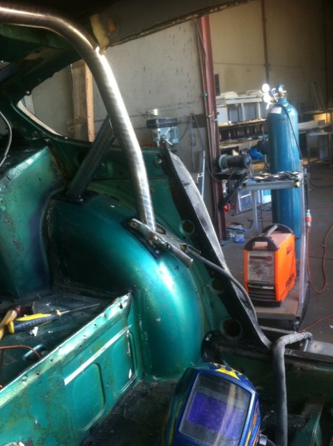

potter260 Posted April 8, 2011 Author Posted April 8, 2011 Cheers guys yeah no bog in either rails or radiator support the rails are just very flat in some places. How would you guys straighten the front attach something to it and pull it forward?? Welding up my bond roll bar today so I don't have to stuff around with it after its painted (and hopefully get it painted the same time as the car). I with be bolting it to the floor and strut towers so it is removable. Quote

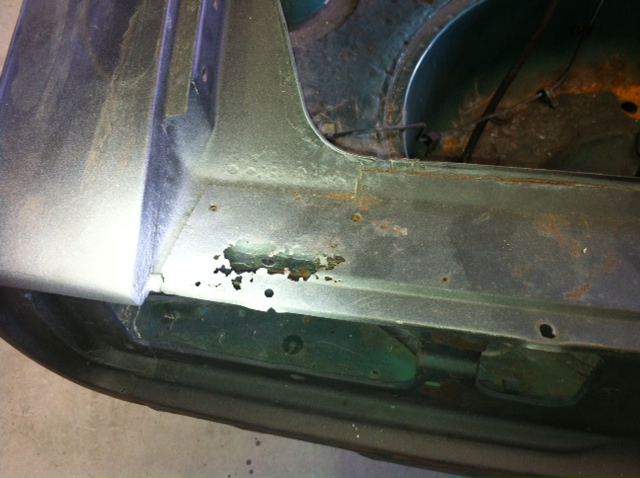

potter260 Posted April 12, 2011 Author Posted April 12, 2011 Found some plates the previous owner popped in at the end of the chassis rails under all the body dedener. No end to the rail, all missing about a 100mm of it. Finished half cage for now till its all registered then i will bolt in the front cage. Quote

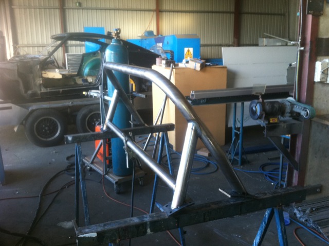

potter260 Posted April 12, 2011 Author Posted April 12, 2011 Where i work at a metal fabrication shop (about 1.5 hrs south of brisbane) they have a turret punch, a laser cutter (does full sheets up to 10mm thick), guillotines, press brakes folders and nearly all the gear (except tube benders, have been trying to convince the boss but no luck yet ) to make stuff out of any metal (stainless, aluminium, steel). If anyone needs a hand or something made up? As i have the key and the bosses permission for the workshop and full use of the equipment in my own time. Built the roll cage above at work on a Saturday. just putting it out there Quote

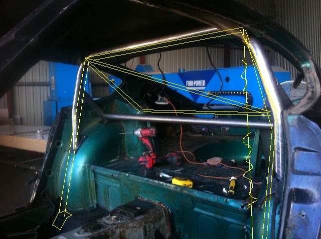

C.A.R. Posted April 12, 2011 Posted April 12, 2011 Neat job, but the front leg of that cage needs to be on the floor - not on the wheel well... Quote
potter260 Posted April 12, 2011 Author Posted April 12, 2011 Needs to be on the floor or has to be? I had it to the floor but the seats would have hit and hoop would have been on an angle or is there no way round that? I also looked at half cages on the net and that's where they have gone to. Quote
potter260 Posted April 12, 2011 Author Posted April 12, 2011 pretty much copied that cage above Quote
Moderators Zedman240® Posted April 12, 2011 Moderators Posted April 12, 2011 Here's a pic of my cage compared to yours but drawn in thin yellow lines to show the difference. Ignore the line with the zig-zag! Just for a reference if you want to alter as mine is CAMS approved. (yours may be too but just in case) Quote
peter t Posted April 12, 2011 Posted April 12, 2011 CAMS approval is a must for roll cages if you want to race or another form of motor sport. Do it right the first time to avoid disapointment in the long run. Good on you for offering your services to fellow Z car people. Quote
potter260 Posted April 15, 2011 Author Posted April 15, 2011 Thanks Dimitri yeah i had the initial thought to build it similar to what yours shows but then i was worried i wouldn't be able to get it in and out of the car so i changed it to one i found on the net. I ordered a weld in CAMS approved full cage from Bond Rolls Bars and changed it slightly so i could bolt it in so i might have to order another one later to change it. Peter T whens your car going to come cruising down to the tweed valley so i can get a good look at it Thanks everyone Quote

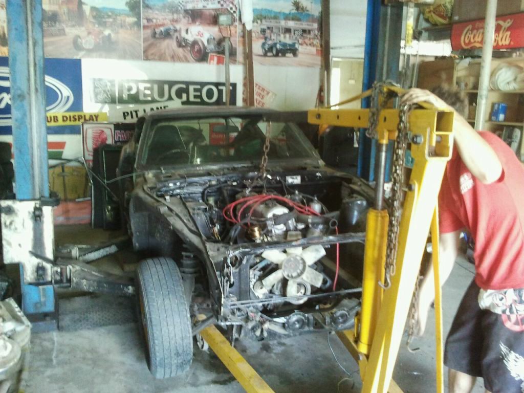

potter260 Posted April 28, 2011 Author Posted April 28, 2011 Hey everyone cars at the sand blasters. The bonnet has a few rust holes in the front and a ding that had a fair bit of bog hiding it. The car should be heading to to painters next week while Im leaving to go on holidays for 3 weeks tomorrow night. There is always something happening when i go away and all i can think of is the project sitting at home and not the holiday! Found a couple of photos my mate had of when we were taking the engine out. Hope you all had a good Easter I will have to see how the paint looks when i get home and put some pics up See you all in 3 weeks i hope Quote

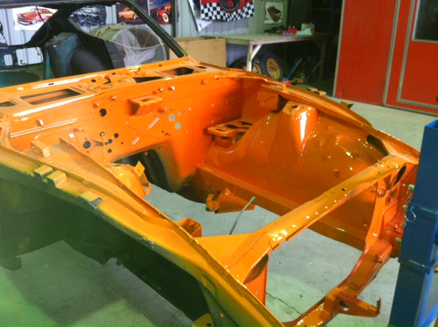

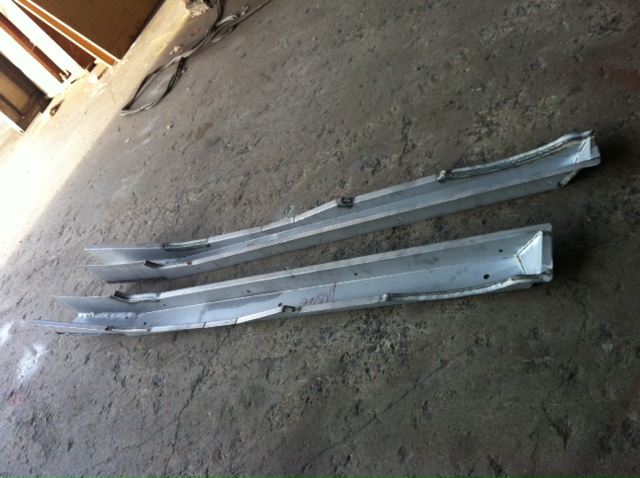

potter260 Posted April 23, 2012 Author Posted April 23, 2012 The panel beaters moving along. Its great to finally see some progress. He has put it up on a rotisserie and removed the chassis rails as they were pretty rusty an knocked up and split on some edges. The underside of the car looks like its had a hard life like its been in a few rallies. So he asked me to make some new rails for it as it would be quicker and more cost effective for me. The one in the pic was the better rail but this was after he had knocked it all back into shape. Quote
potter260 Posted June 1, 2012 Author Posted June 1, 2012 New rails and good to see some colour finally in the car Quote
thriller Posted June 2, 2012 Posted June 2, 2012 Rails look good. Color looks good. Car looks good. Orange seems to be the new in thing for Z's! Can definitely see why. Quote
luvemfast Posted June 2, 2012 Posted June 2, 2012 Loving the colour. Agree with Thriller. Orange is the new black Quote
