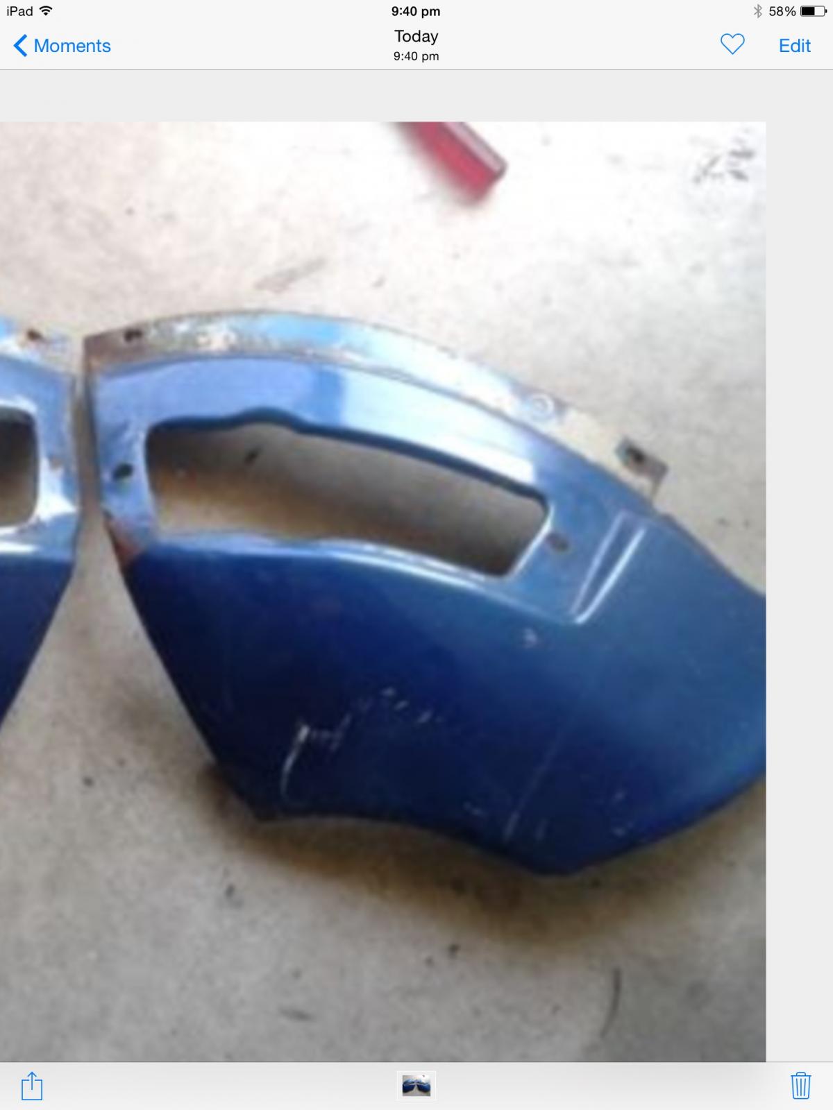

  3. Not sure of the name of it but the metal panel that houses the indicator. Getting ready to paint panels and this one is worse than I remember... Anyone have a decent one they'd be happy to sell? Cheers

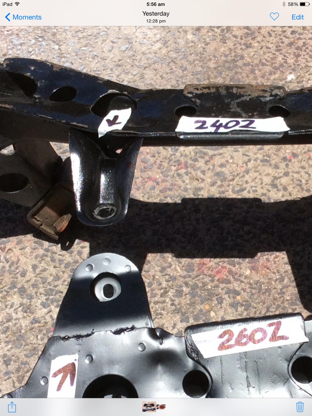

  6. So got the 260z xmember off Garvice and they do bolt straight on to the 240z. Only difference I could see was the extra strengthening around the steering rack front mounts, as in pic.

  8. Hope the holidays are finding you all well and spanner are finding projects... As per the title I'm chasing the front cross member for a 71 240z. I just need the bare centre pressed metal section, not arms, steering or suspension. Not sure if the 260 items are the same or not, perhaps someone can let me know? Pls let me know if there's one out there someone wants to sell. Cheers Martin

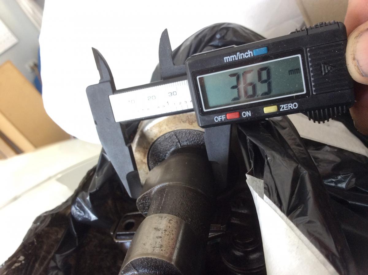

  13. Hi Jason/all Here are the dimensions of the cam lobe. Quite a bit smaller than stock!

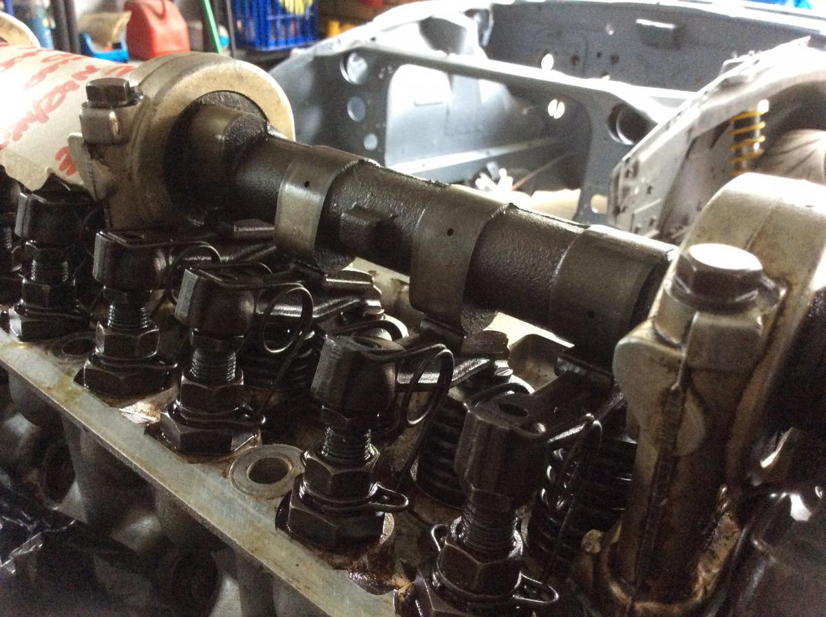

  14. Thanks for the info, Jason. Will measure cam later today. Looks like the cam's re ground rather than welded? When I put the head back on, do I time-up as per normal on an std L28 and what in and ex valve clearances would you suggest? Thanks again Martin

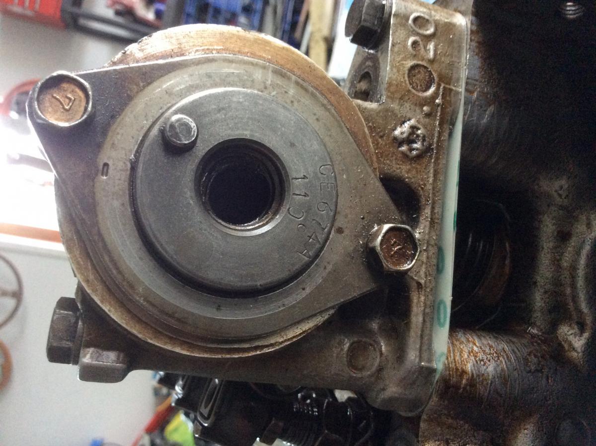

  15. After finishing the bottom end rebuild, I'm now looking at which N42 head to bolt on top. One is completely standard but the other has th following mods; Head skimmed by 0.9mm Cam towers shimmed by two 0.01 gaskets ( front and rear towers), no gasket in the middle tower and one on the others An E30 cam with CE674A and 110 degree ( well the symbol for it anyway) stamped into the end of it Standard 1.2mm head gasket, rocker arm adjusting screws have about 10mm of thread visible. Does anyone know what the number relates to ( did a search and nothing came up) and what sort of grind the cam has? It's a street car on SUs and extractors. When I dismantled the engine, all six of the top piston rings were cracked. Was told that was likely due to detonation. Does that make sense and is that a timing fuel error or something else? There were no marks on the valves or piston crowns. All help appreciated Cheers
