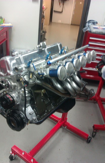

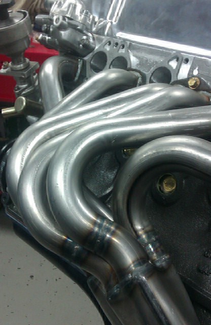

  1. We can make your pipes the same Gordo , but its easier to start with a new set , the new pipe has a shorter primary pipe buy 150mm and fatter second pipe that is shorter as well , when we did Jake's we made 3 sets of pipes and tryed new lengths and size and these pipes are what we cam out with .
  2. Yer there the new race stroker SPEC pipe, we got sw to make them to our 3.4 SPEC. let's the big motors rpm

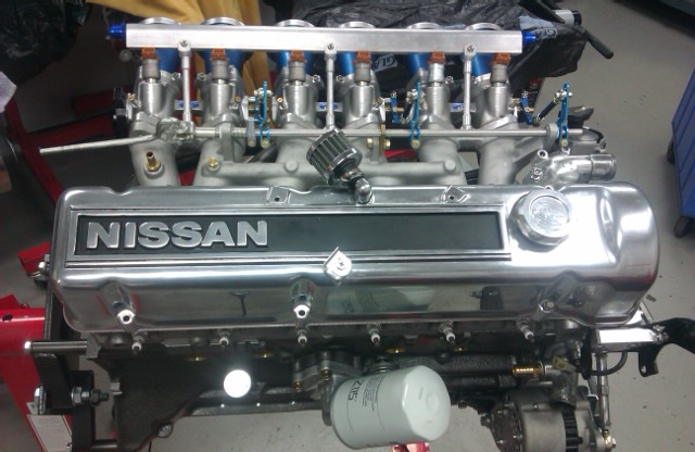

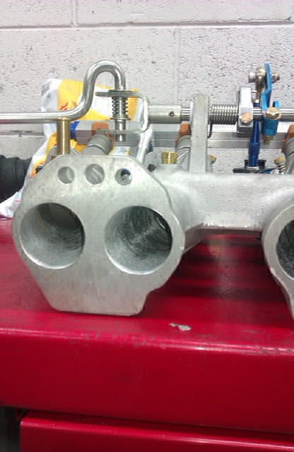

  9. I finished the intake today ,port matched to the head

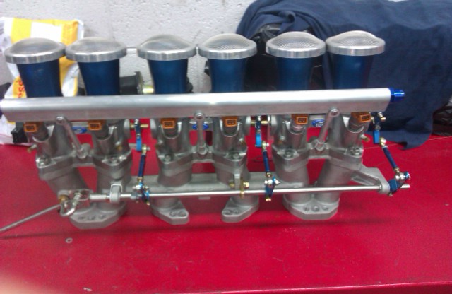

    ITB's
    I'm fully up for injection , love it and gives great results , but I'm really into the carbs for a classic car feel and look .its so easy to just fit a new LS or Rb and have them run smooth , but that's not what people fall in love with, driving a classic with the sound and smell and feel is just so cool I'm thinking if you really want a smooth car and great economy and good power best buy a new car , L motors were never built for clean burning and smooth running , no matter how hard you tune , most want a cam that feels and sounds strong , never good for economy , i will let you drive a good injected 320hp car and a 310hp carbed car and we will go thou all the costs and then make a decision , i love both but the cost of the injection is hard for some
  11. peter mc
    ITB's
    The 5% that you feel is in the drive from idle to 3000 rpm , the EFI starts better and idles better if its done right , and drives better around town if you have a real cam , but it takes some time to get the tune spot on , its never cheep .With a good set of carbs it will be 1/4 the cost if you do it right from the start , i think you should drive both and make a decision , I'm shore i could get two cars with the same spec engines one with EFI and one with 45 Weber's so you can try them and then spend your cash
  12. peter mc
    ITB's
    ITB,s are very cool and great when setup , but a well setup set off carbs can be dam hard to beat , 44 solex carbs on the road are so good , and the sound is hard to beat as well .EFI is great but need to be tuned buy someone who gives a shiver , or you might as well stayed with stock carbs

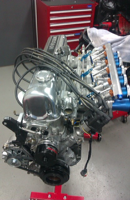

  13. There will be Heep's off pics this week , should have the new pipes and i will be finishing the inlet manifold , will be a cracker road race engine , can not wate to get it on the dyno

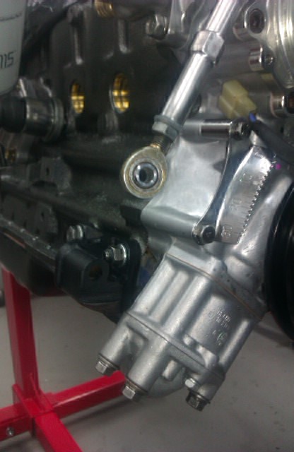

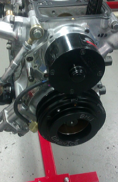

  14. Just 2 more Also soda blasted the oil filter adapter so it looks a bit cleaner

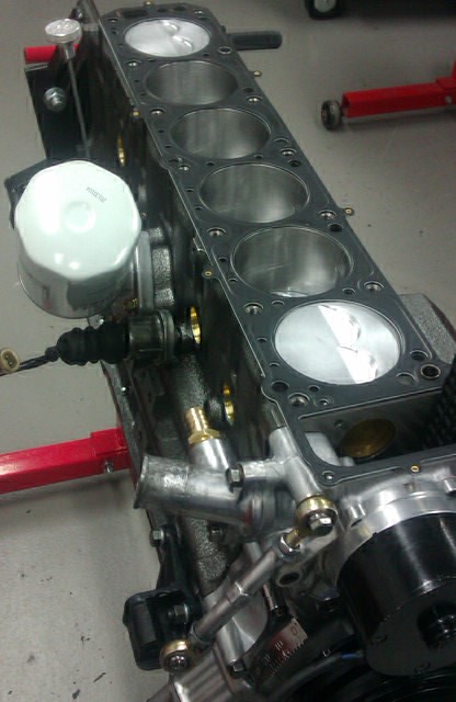

  15. Hi Owen More pics off the bottom end, its all together now, looking good , i removed all the old paint off the sump and parts that were painted blue and removed the paint from all the bolts to get a better finish , next will be setting up the head with the new springs and cam , And yes sonic testing is to see if its safe to bore , as this block was 89.5 it was realy close to getting a new block , but after sonic testing it was found to be a very thick casting

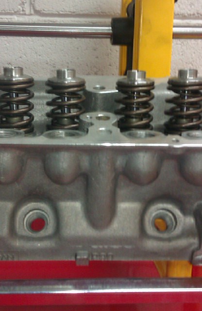

  18. Hi Owen Les has finished porting your head this was a pic i snapped while he was at lunch , he was half way thou the inlet port and starting on the chamber , looks real nice port size is 39mm so it should rpm well to 7500
