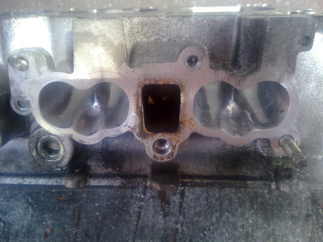

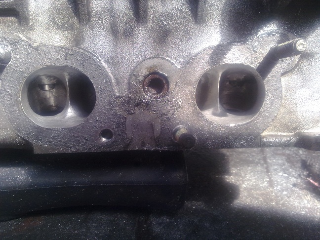

    well big weekend in the shed some pics for the l28t people out there

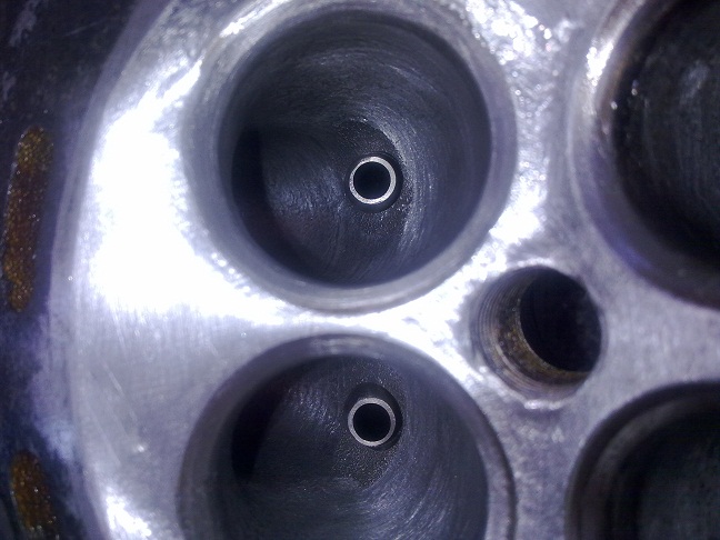

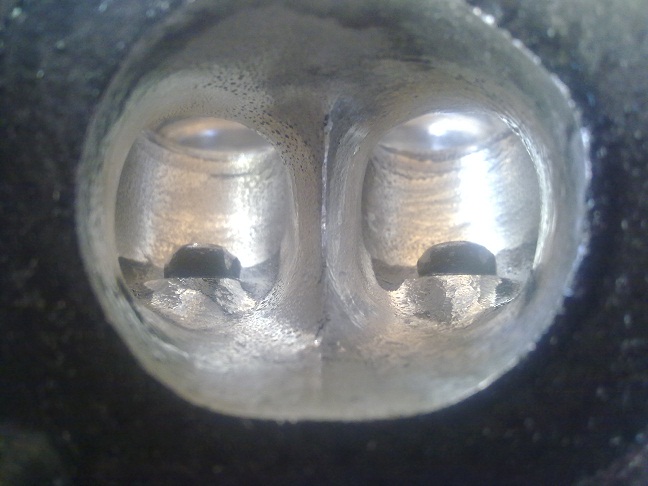

  6. peter mc
    RB 28 BUILD
    hi garvice first pic is a comp head with big valves and flows 310 cfm and will go on my NC28 as for the compression yes is lowers it, the step in the chamber helps turbulence at low rpm and boost ...but as things get going it can overheat the intake side of the piston and u will see det marks on all gtr pistons on that side, so this mod helps remove det that you can not hear and you can run more timing and make more power for the same psi,,,, if you wont you can buy pistons that will bring the comp up for race fuel with a 9.1 ratio with the mod to the chamber with the stroke and bore and the piston i have ordered this motor will be 8.5 /1 and will take 20deg timing at 20psi on pump 98 without the mods to the camber you can not get 14 degs timing

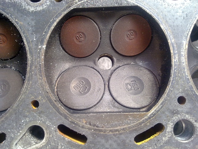

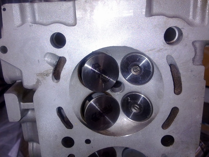

  10. peter mc
    RB 28 BUILD
    more pics just a note that the chamber mods for mild motors 15psi you can do the inlet side and race motors do both sides for high boost 20 +psi on 98 pr fuel this mod will let you run up to a extra 6deg timing....
  11. peter mc
    RB 28 BUILD
    this is the mod on the chamber ......i will remove the steps on both sides of the camber

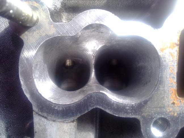

  16. peter mc
    L28T build
    well iv finished the porting and now it off for new guides and seats and some work in the chamber
