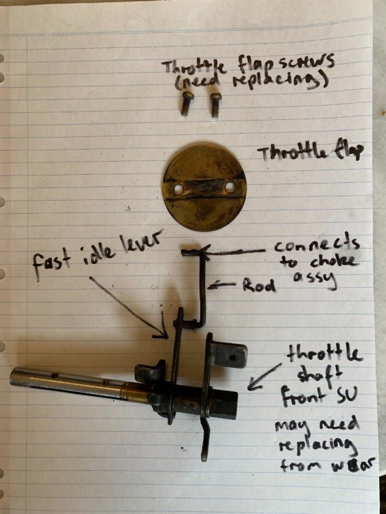

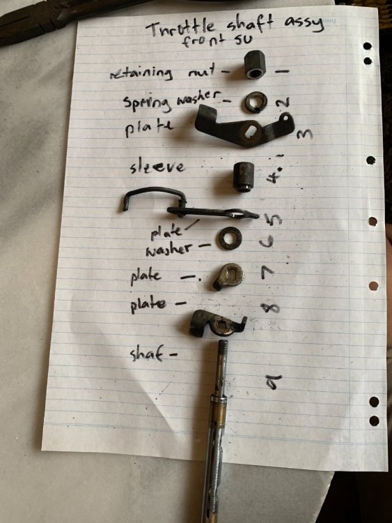

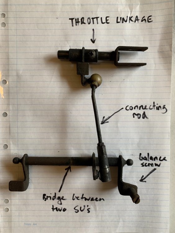

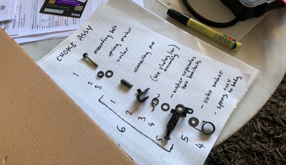

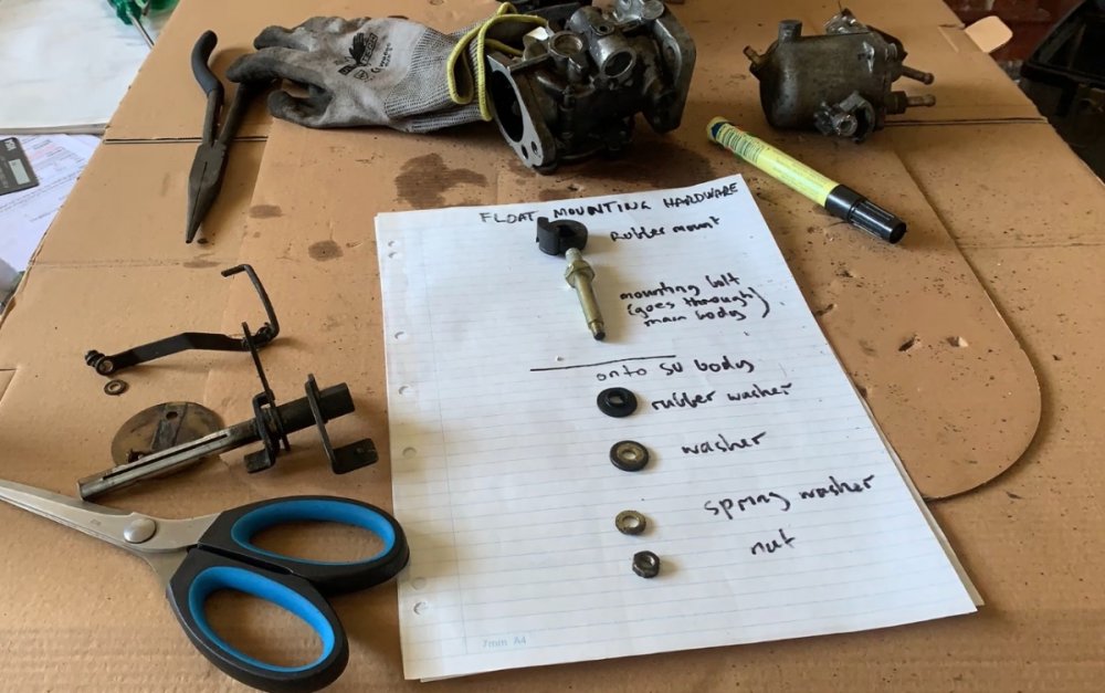

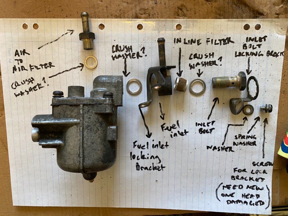

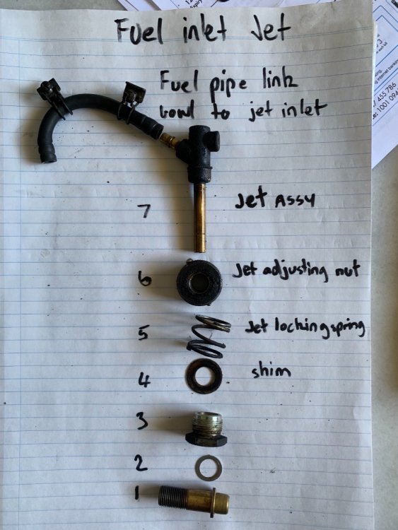

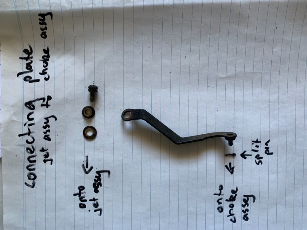

My Haynes service manual photos were terrible and unusable so I made these to remember how everything goes back together when I rebuild everything Maybe this might help someone at some point
