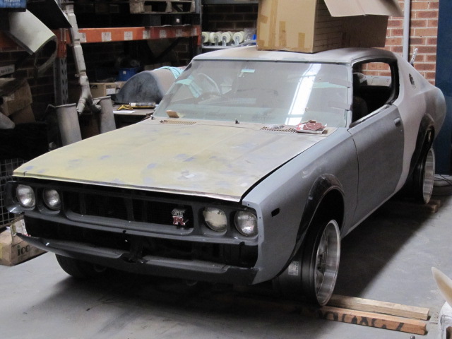

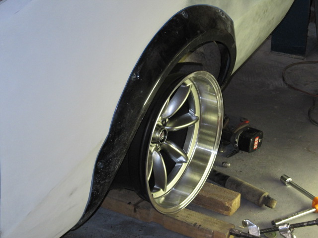

  24. BenZed
    KHGC110 project
    Trial-fitted the flares and wheels today. I'm going to run 17x8.5 +4 at the front and 17x9.5 -19 at the rear. The C110 flares don't give you as much room at the front as you get on a Zed, so the 17x9 -13 wasn't suitable. Once it is lowered this combo should sit just nicely inside the flares without too much tyre stretch.
