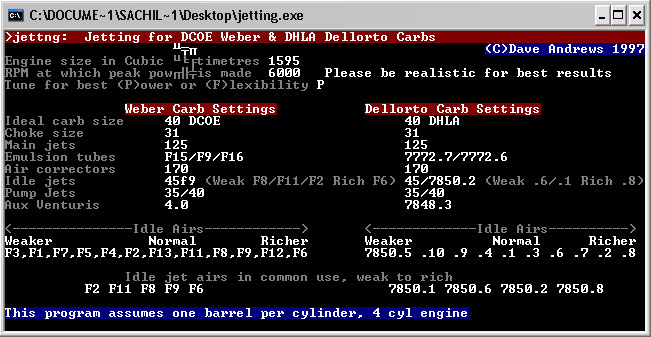

These are the ideal jetting sizes... I will wait for some input from members before i go out and buy these jet. I can fine tune the Carbs from the ideal setup.
Hey everyone On Saturday (6/12/08) at the Z car BBQ/Photo shoot, i was asked by a couple of members what my jets where, because i'm having some trouble with my Dello's. I couldn't remember of the top of my head but found the sheet where i wrote it all down. I'm missing some information but pretty sure got the main ones. L24 DHLA40 Chokes : ? AUX Venturi : 7848.1 Main Jet : 200 Air Correctors : 110 Emmulsion Tube : 7772.5 Idle Jet : ? Idle Jet Air Corrector : 7850.1 Accel Pump Jet : 40 Cold Start Emmulsion Tube : 7482.1 Cold Stat Jet : ? Also thanks to all the members who offered to help me with this problem, this is why Auszcar is my fav. forum . I think I might use the "Jetting" program that Sulio posted in another thread, as he said he got pretty close sizes from the program compared to his final setup. I'll post up the ideal jetting sizes from the program later today. Sach
