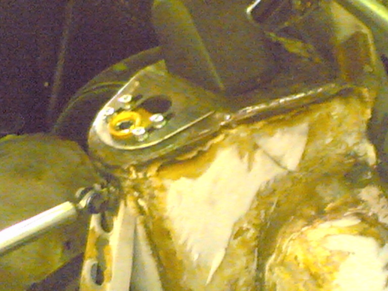

  13. Just one thing, has anyone else had the top flat section where the seat belt bolts into the top of the strut tower held in by about 6 small screws? We ended up tig welding it so its strong as, but it might be worth while people having a look, cos it wont hold in an accident.

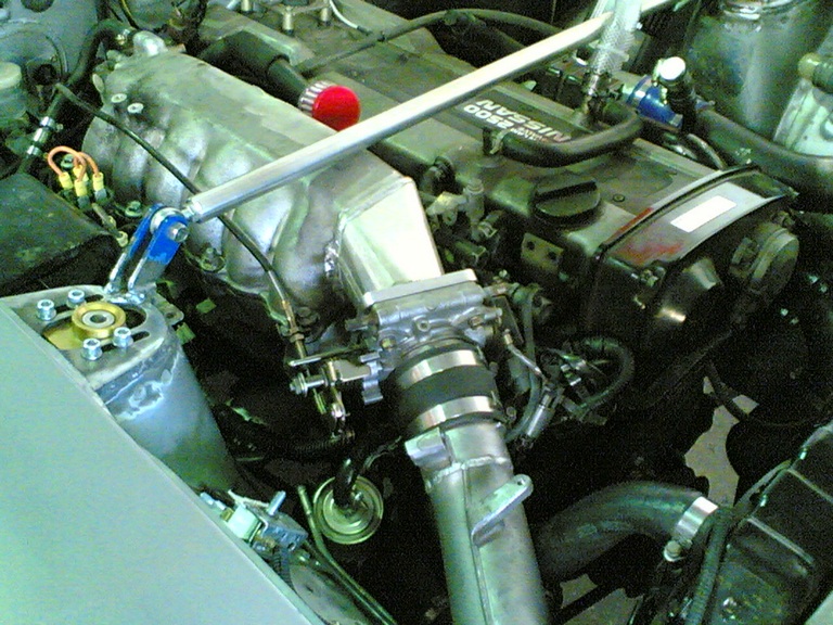

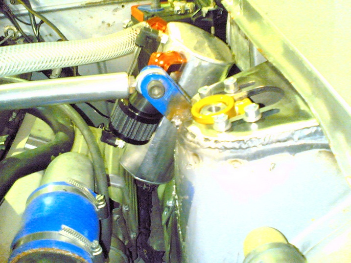

  14. Well after all this I have learnt a great lesson, don't rush and talk to your suspension guy first. All the equipment is available in oz to work except for the adjustable camber tops which I got from T3 in the states. Unfortunately these have to be welded in therefore you loose the top bolts that the strut brace would bolt to. Also, we weighed the car in all for corners at once to see what the best spring rates were for the car and are nothing like what I ordered from the states, so now I will be running dual stage Eibach springs. So here is what has ended up happening. Note the new strut brace.
