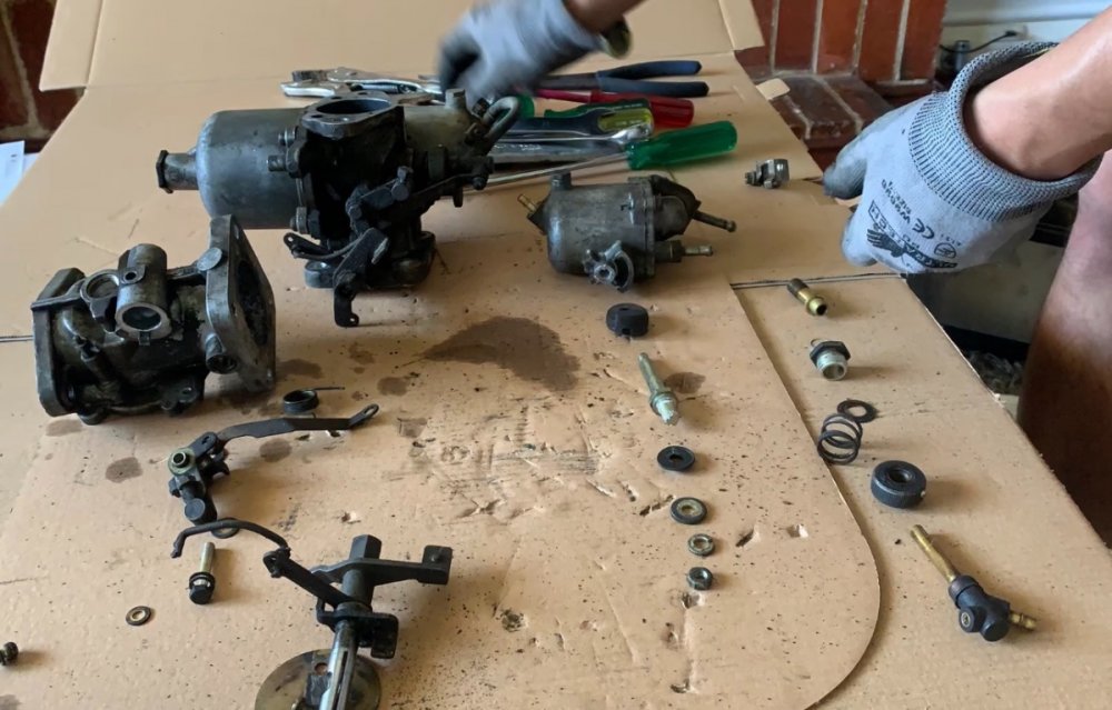

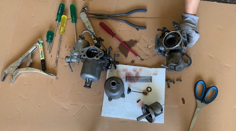

  3. Getting the needles out can be a pita. I was gonna check you removed the grub screw. Basically what's holding it in is a bunch of carbon build up (probably from the PCV being fed into the intake). You could try soak it in kerosene or use lots of carb cleaner on it and let it sit for a while. I butchered my needles getting them out (with pliers) because I ran out of patience. I kind of regret doing that too! Z-Therapy will give you new needles but the original L24 sized ones are hard to find now and generally the Z-therapy ones are SM needles which are a bit rich..from what I've seen. You won't regret getting Z-therapy rebuilds. I had a bunch (4 sets) done a while ago. I think I sold 2 sets and kept 2. Can get a little expensive.

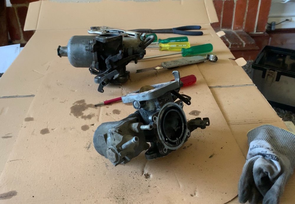

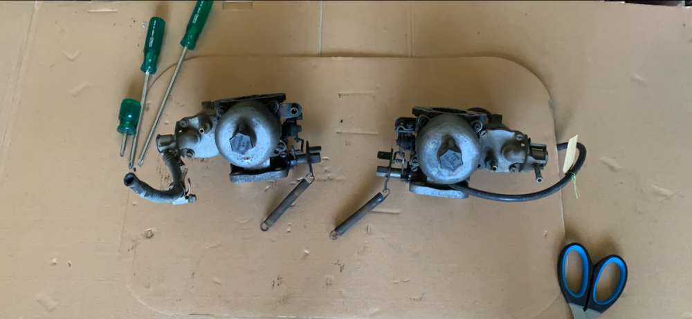

  4. As you all know I’ve never done any of this before so I’m relying on you wise sages to correct my mistakes and give your worldly advice... I was thinking about doing one SU at a time just to have one to reference off when rebuilding but I’ve taken a lot of photos and feel confident I can put them back together using those. Let me know your thoughts. Planning to: -order a Ztherapy rebuild kit -vapour blast intake manifold, bodies and dome -replate hardware -new hoses let me know if I’ve missed anything critical few photos of dismantle on front SU
    1 point
