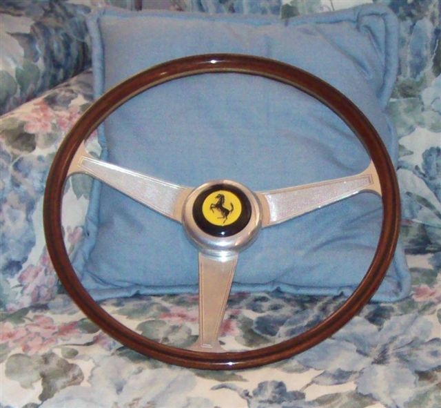

PeterAllen Posted January 7, 2013 Posted January 7, 2013 why no wood? is it soft or something? On the contrary, it's brittle and will snap when a force is applied resulting in a jagged edge, just right for impaling a chest. Here is my beautiful, gorgeous, seductive, Nardi Anni 60... A wheel to die for! Quote
Brabham Posted January 8, 2013 Author Posted January 8, 2013 Cheers guys will opt for the 260Z wheel then. Peter that is indeed a nice wheel, is it a replica of a GTO wheel? Cheers. Quote

PeterAllen Posted January 8, 2013 Posted January 8, 2013 ...Peter that is indeed a nice wheel, is it a replica of a GTO wheel? No, it's the real McCoy. I picked it up off the Italian eBay... They were also used on Lancias in the 60s. To be honest they are not very comfortable to race with (too thin and too slippery) and a lot of historic drivers replace them for actual racing. Quote
