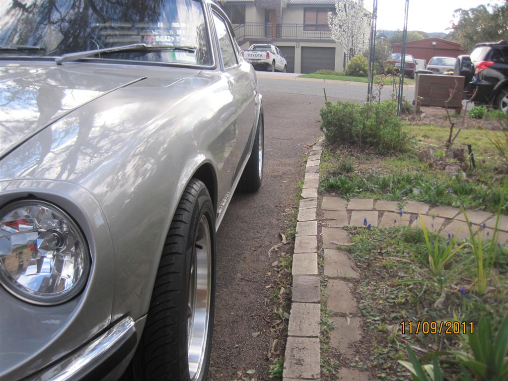

well I finally got around to rolling & folding my inner guard lips including the front which meant the 225's dont touch anywhere.
Ive got 16x8 (+4)  running 225s all round..If I had my time again I defintely would have bought 16x7's for the front with 205 or 215s'...
8's give you a bees dick in tolerance, but it works.
fyi ...Ive wound the konis to about 70% hard & Ive got 2" lowered Kings and the tyres havent touched.

I wouldnt be game to go lower...the Kings with 16" & 50 series rubber is just about perfect. seems the older you get you tend to want more clearance  ::)

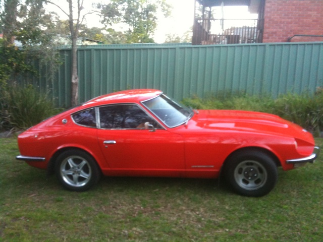

I recently bought some 16x7s +20 from Tim (RB30X). 2 of the rims came with 225/50 tyres on them the others were wheels only. I have found that the 225/50 tyres just scrub on the lower perch when on the rear of my 240z 9/72 but foul so badly when fitted on the front that you can barely rotate the wheel. I contacted Tim to find out what suspension he was running and if he had had any problems. Here was his response.
"Hi Mick,
Yeah I had coil overs on my car but they weren’t any where near the spring perches.
I’ve heard the wheel hubs between models can make wheels stick out more, for example the 16 x 8’s I bought fit mine no worries but wouldn’t fit another fellas with the same mods because he had 260 hubs and not 240 or something.
You could try getting some 2nd hand 205’s fitted and see how they go.
Some say to avoid wheel spacers, but they would solve your problems and make the wheel sit out more with the guards, and you aren’t racing it??
Maybe pop the question up on the forum and see what people say.
Tim"
As Tim suggested, I have bought some 205/50s but haven't fitted them yet, hope to get that sorted over the weekend.
Anyone have ideas on different hub geometries pushing wheels in or out?
Mick
PS Here's a pic of the young Fella coming for his first cruise, you can see the new wheels fitted on the back too.
Mick
its the 20+ offset thats killing you.
It will be interesting to see what happens with 205's.
I previously had 16x7 also, with 205's and I could have built a block of apartments under there I had so much clearance. But the difference was the rims had the correct offset for a 240z.

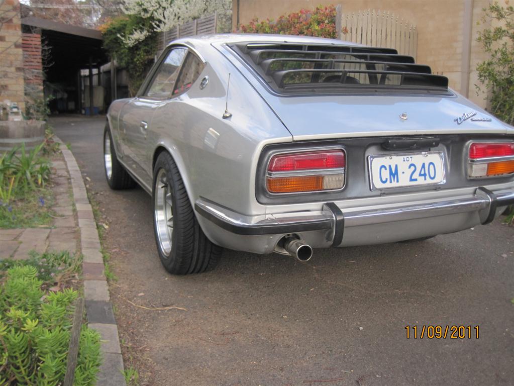

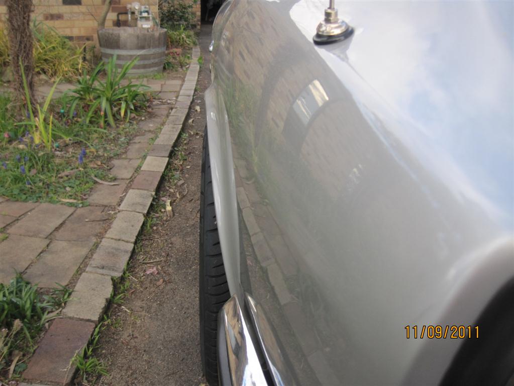

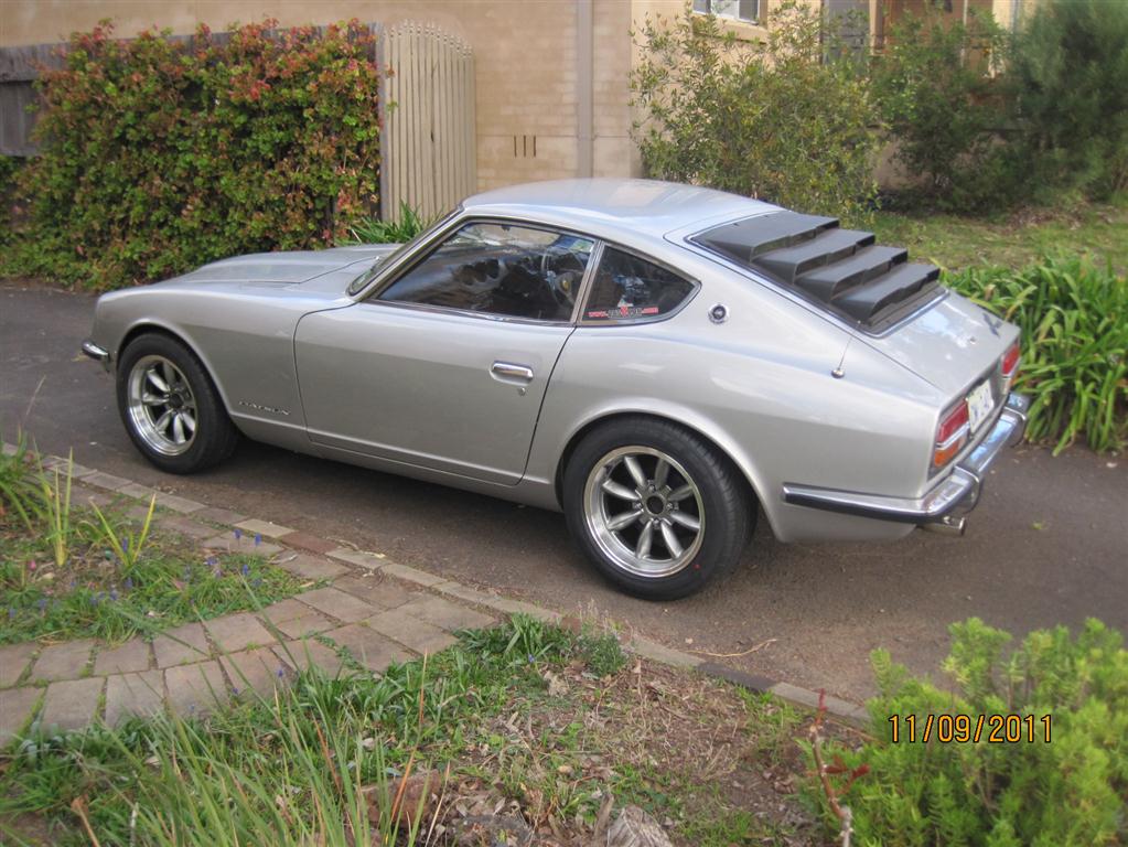

Couple more pics, I definitely need some lowered springs to get the look I'm after but still undecided on shocks. Ho-hum :-\
Mick

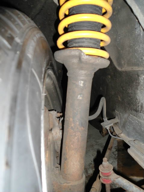

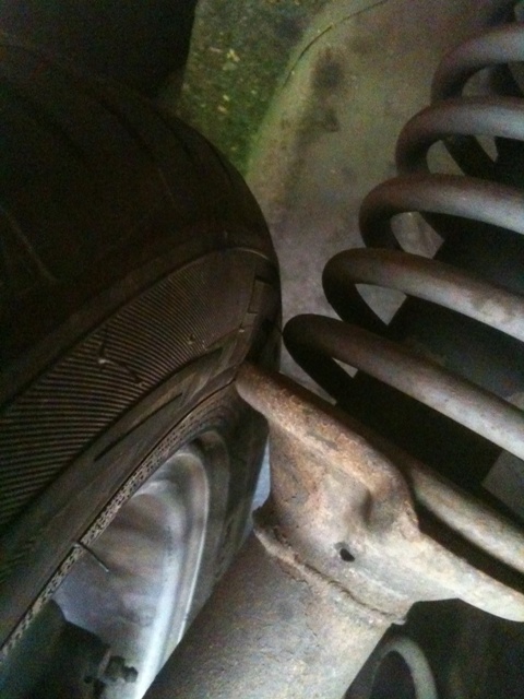

16x8" +4 on a 240Z front strut
hmmm interesting pic of your strut/perch. looks like an easy inch youve got there. I definetely havent got that much clearance with identical rims & offset & struts.
You definetely have a touch more camber than me.
Are you guys running the same Tyres too?

That's not my car - it's a guy on hybridz with an orange 240Z. He has a few good pics of 16x8 +4 RB-R fitment on there. Just search in google "rota 16x8 site:hybridz.org" and it's like the second link i think only 2 pages.

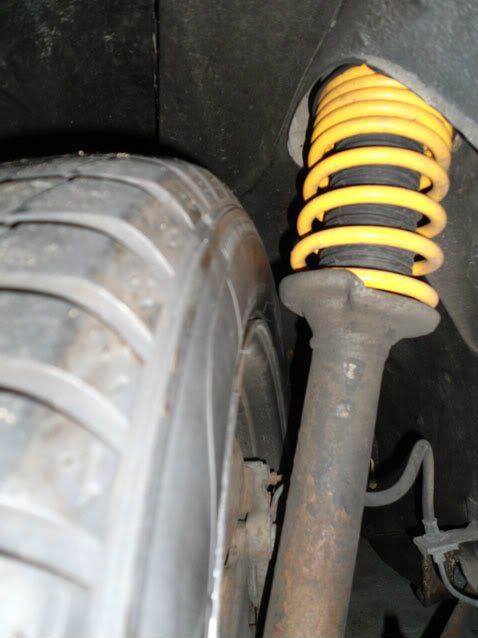

I agree about the tyres, if you have tyres with buldgey sidewalls it will cut down your space by a lot. I feel inspired now I'll take a photo of my perch clearance tomorrow morning just out of interest.

Haha - bee's dick in it but no marks on the tyre from rubbing. I reckon it is the same as the car above with the red springs.
