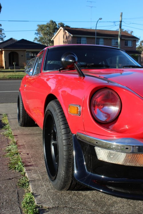

53-681 Posted July 29, 2012 Posted July 29, 2012 You park the car at maccas, get your friend to get out and twist, slide in the mirror cups until you can see the golden arches Quote

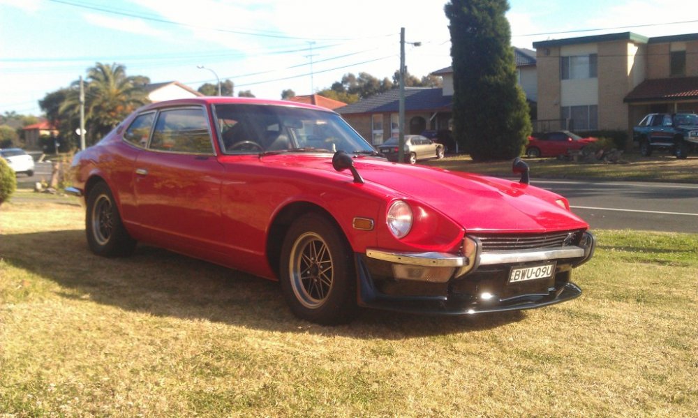

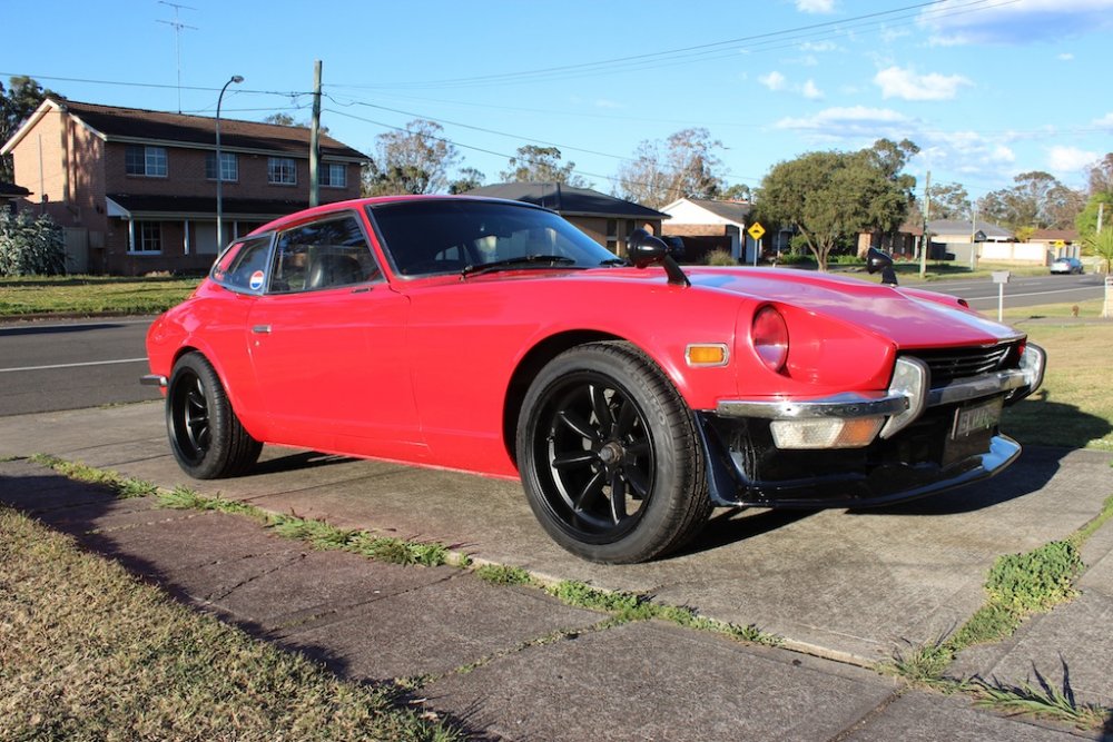

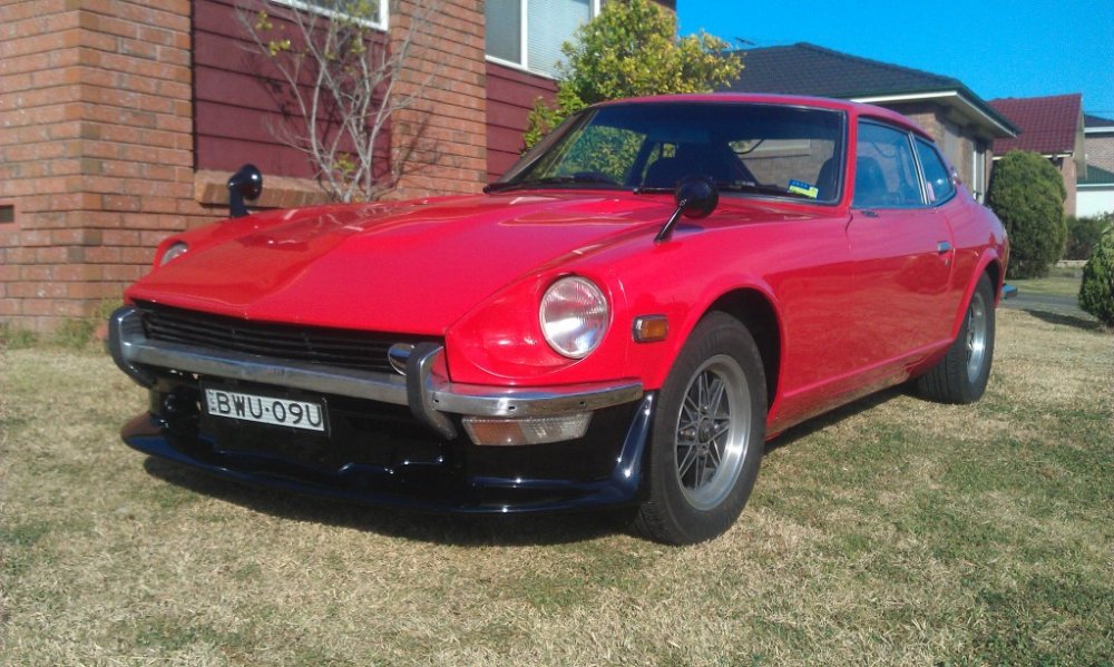

Administrators gav240z Posted July 29, 2012 Administrators Posted July 29, 2012 Looks great actually, I vote for re-chrome of front bumpers (not painted) and consider a small lip front spoiler over the big air damns. (BRE type spook). Those wheels look good (the ones on there), why don't you have a go at polishing up those alloys to a mirror finish? I think they would look fantastic. Quote
Tj Posted July 29, 2012 Author Posted July 29, 2012 Adjusting them is a bit of a stuff around. There's a screw in the back of them that you loosen that let's the mirror itself move kinda like a knuckle joint inside the mirror stalk. You loosen it, aim it roughly where you think it should be, get in the car and have a look, get back out and adjust it again, get back in the car, wash rinse repeat. Once you tighten the screw back up it should be pretty difficult for the mirror to be accidentally knocked out of whack, someone would need to deliberately stuff about with them. Once I had it right I took it for a drive up the freeway just to make sure and then made a few more adjustments but they're spot on now. They look straight down the sides of the car (i can actually see the guards in them) so I can see a long way behind. Just as a car passes me on either side and becomes out of view of the rear view mirror they're already in the fender mirrors and then they're in my peripheral vision before they're out of the fender mirrors. I actually took it up Parramatta Rd into the city this weekend (THE worst road in Sydney for those that don't know. Narrow and overcrowded) and I thought it would be a hassle but it was actually great. The mirrors are always in your line of sight so you're not taking your eyes off the road. It does take a bit or relearning how to use mirrors but I think they're great. Quote

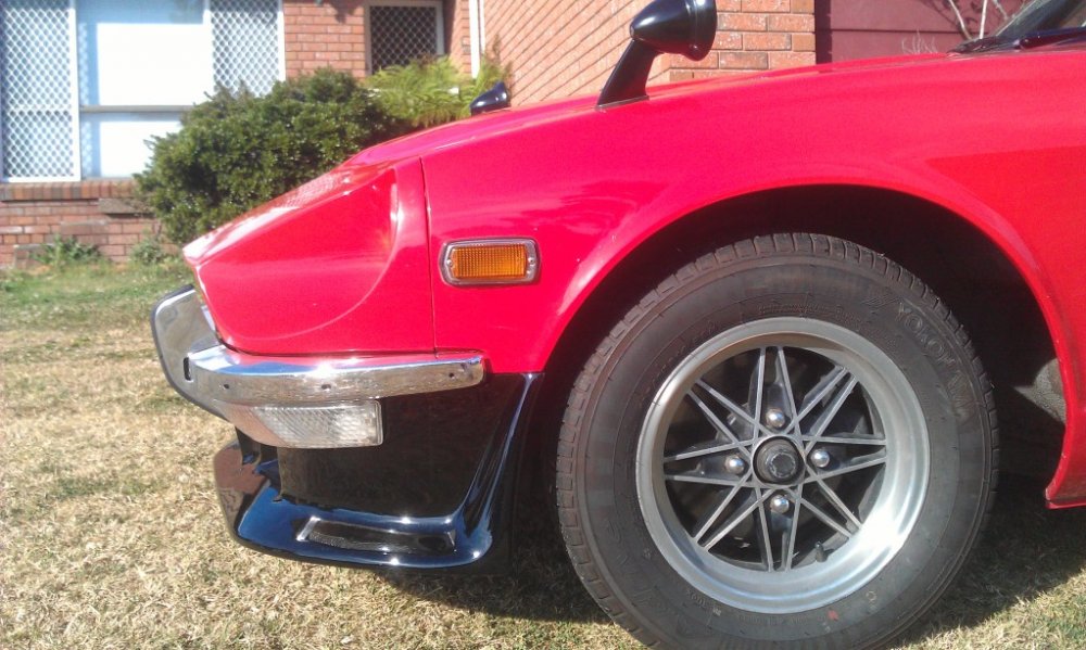

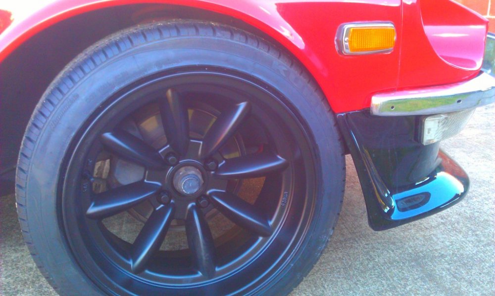

Tj Posted September 16, 2012 Author Posted September 16, 2012 Ok quick update. There was a bit of an issue getting the flares on so they've been put on hold for a little while however they were able to paint and fit the airdam which i think came up real nice Only crappy phone photos at the moment. The fit and finish is real nice. I took a punt on a piece on ebay from a seller called "mybodykits" and I'm pretty impressed. It feels nice and sturdy too. It seems to take the attention away from my bent front bar too which is a good thing. Hopefully the flares will get done soon (it was more of a time issue really) so I can get rid of these fugly wheels. Oh and if you're wondering what the chrome disc on the grille is, my JAF badge fell off :-\ Luckily I found it a few days later on the lawn Quote
Riceburner Posted September 16, 2012 Posted September 16, 2012 Looks great TJ I like the color choice, it'll tie in nicely with the flairs and breaks up the color on the car. Quote
Tj Posted September 16, 2012 Author Posted September 16, 2012 Thanks Gareth. Now the Jury's out on whether or not I still want to paint the bumpers black too. I'm thinking that they'll need to break up the black a little by being chrome Hmm... Quote
Riceburner Posted September 16, 2012 Posted September 16, 2012 +1 for chrome can't beat good chrome bumpers, stainless are the ultimate if you have the cash. You could try black on a spare bumper if you have one, it could look great too. Quote

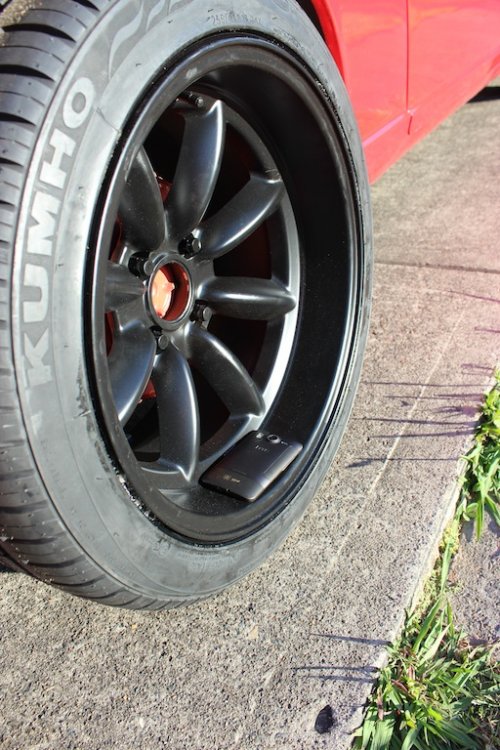

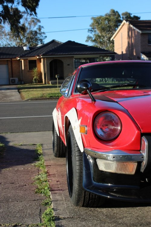

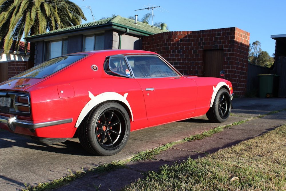

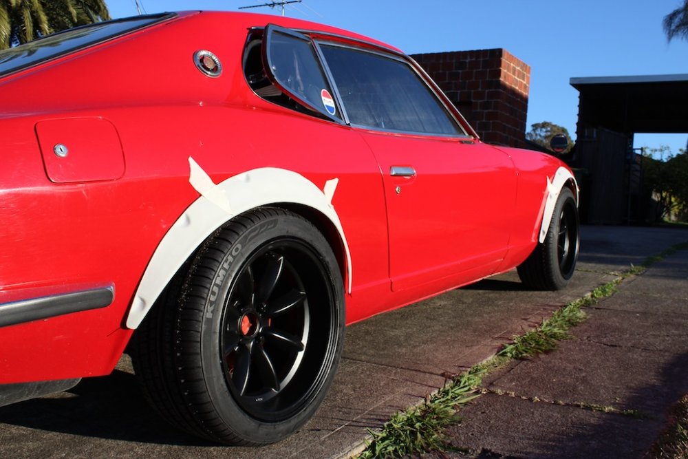

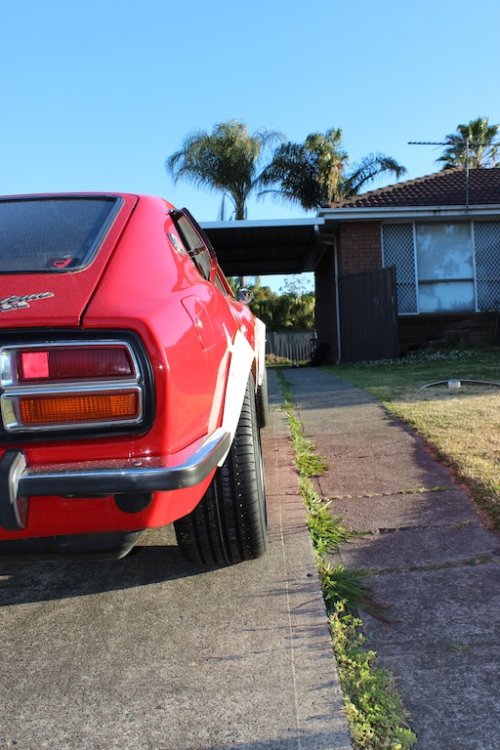

Tj Posted September 21, 2012 Author Posted September 21, 2012 BULK PHOTO DUMP (In case you were wondering why your computer just started swearing at you ) SO after a bit of a wait my wheel nuts finally arrived. The cruddy wheels I have at the moment have gawd-awful shank style nuts whereas the new Rotas use acorn nuts so I had to wait for the set I ordered to arrive (Side note: has anyone else had similar problems dealing with VisionR in Perth?, I mean, I don't want to write them off but there was a hold up both times I've ordered from them. First the wheels took a few weeks longer to an email blunder and now the nuts took a few weeks extra because their web store filled its shorts :-\ ) I took a few shots with and without the flares bodgily taped to the car. Now, does anyone think my Castor is out in this photo? Have a good look at that front wheel, I think it's way too far forward. I noticed this back when I replaced the shocks and redid all the bushes. Is it possible that the poly bushes I put on the castor rods is too thick and its pushing the whole lot forward? It's actually making the fronts foul on the bottom (front) corner of the guard where the apron meets it. The bushes that were in there were already poly but they were much softer so I swapped them out anyway, I think I still have them so I might swap them back. I got a little concerned at this point. The wheels were sitting too far outside the guards to not run flares, but I didn't think they sat out far enough to fill flares. But I needn't have worried, they sit real nice with the flares, not flush with the edge of them but I don't mind (oh and I will be painting those drums black too when these wheels go on) And one more shot just for poser-points Sorry for the swarm of photos but I'm really excited about how it looks and I can't wait to get it all finalised and get these flares on properly. Still can't make up my mind about bumpers though, can't decide between chrome or black.... I've got some photoshopping to do. Quote
Linton Posted September 21, 2012 Posted September 21, 2012 I would leave the bumpers till you paint the flares, black I presume, it will make a difference to the overall appearance. Damn I been looking everywhere for my phone Good work!! Quote

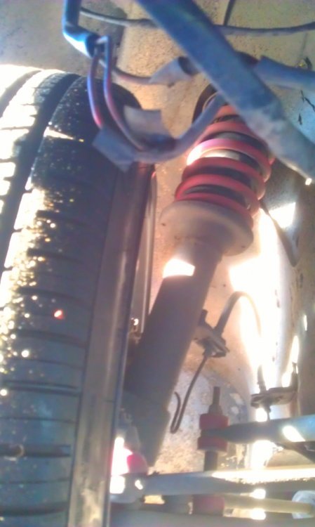

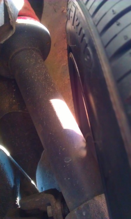

Tj Posted September 21, 2012 Author Posted September 21, 2012 Oh, I forgot that I took a few more photos. For those of you curious about strut perch clearance here's the front: And rear: Heaps of room. To recap, the wheels are Rota RB-X, fronts = 17x9 -13 offset, rears = 17x9.5 -19 offset. Heres another shot of that front wheel. Again, not quite square on and the wheel is tuned slightly but it does show where it's fouling on the guard: Quote
Riceburner Posted September 21, 2012 Posted September 21, 2012 The front clearance problem is common with bigger wheels. Shave a tiny bit off the inner edge of the spoiler and you should be ok. Looks great, blacks wheels make the red really pop. Where'd you get the flares from? Quote
