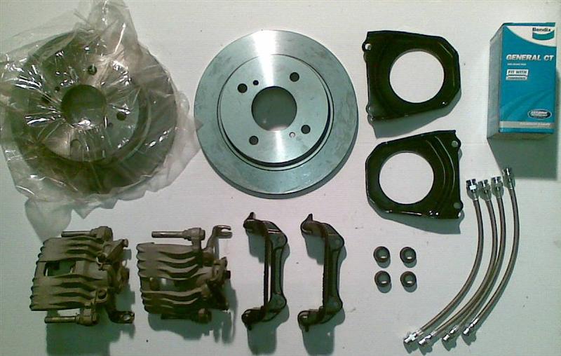

Sirpent Posted April 10, 2011 Posted April 10, 2011 Just wanted to say thanks to Lurch and his family for the hospitality once again. Great day and always great catching up with you guys, the exchange of ideas info and general advise at these days is always fantastic and made the 280 km round trip worth it. Thanks to Scoota also for putting forward the idea. Dimitri, I left at 6.00pm, everything fitted up well in the end but the boys were having an issue with the "NEW" master cylinder assy. Cheers John Quote
MaygZ Posted April 10, 2011 Posted April 10, 2011 John, the master cylinder was fine. We had a problem with the rear bleed nipples being on the bottom of the caliper! :'( Quote
Sirpent Posted April 10, 2011 Posted April 10, 2011 John, the master cylinder was fine. We had a problem with the rear bleed nipples being on the bottom of the caliper! :'( ???????????????? What the "F" ? How did that effect the back surge? Quote
MaygZ Posted April 10, 2011 Posted April 10, 2011 Most of the rear calipers were air, so when the pressure was released the air would expand faster than fluid would - as air compresses much more than fluid and then rapidly expands to take up much more volume. Thus a roster tail of fluid back in the reservoir. The calipers need to be bled while unmounted or have a bleed valve tapped into the top of them. I know I'd tap in a new valve as it means they could be bled easier and more often: ie after/before each race. Quote

Scoota G Posted April 11, 2011 Posted April 11, 2011 I can now confirm that there was No problem with air in the system, seems the 'NEW' Master cylinder was faulty and caused all the drama at the end of the day. I replaced it with my old Tokico one and now have a Rock Hard pedal. Quote
