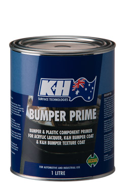

53-681 Posted March 26, 2011 Author Posted March 26, 2011 I think I should man-up and just attempt to repair it myself... I have been doing quite a bit of research recently, soooo we'll see :/ I'm not too sure of what kind of primer to use though... Is there a such thing as interior primer out there??? Quote

Sirpent Posted March 26, 2011 Posted March 26, 2011 I think I should man-up and just attempt to repair it myself... I have been doing quite a bit of research recently, soooo we'll see :/ I'm not too sure of what kind of primer to use though... Is there a such thing as interior primer out there??? K&H although I don't like a lot of their gear do make an excellent bumper bar primer filler, I have used it and was very impressed. It dries hard, is designed to spray onto PU plastics, is heat tolerent flexable and sands fairly easily wet and dry. I will try and find a link to the product. Cheers John Quote
53-681 Posted March 26, 2011 Author Posted March 26, 2011 Oh sweet, thanx Sirpent bro! Hmmm I'll PM you soon Lurch bro Quote
