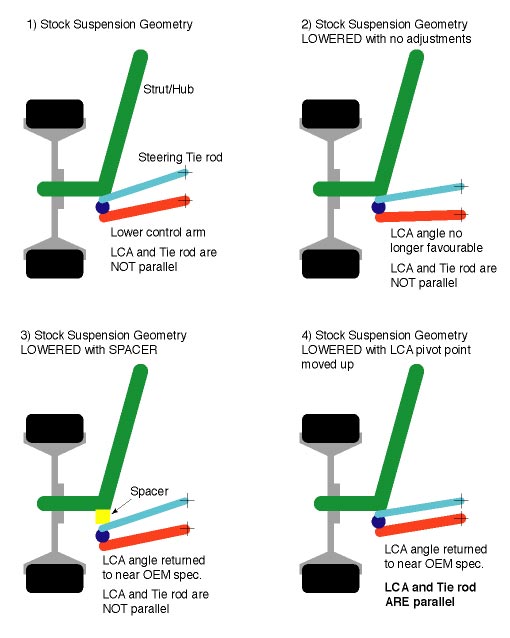

sco_aus Posted January 23, 2007 Posted January 23, 2007 Really clean mate. I thought it was my car at first, exact same colour but yours is cleaner. Bump steer can be done a couple of ways. You can go power steering which isnt too expensive really: http://www.viczcar.com/forums/viewtopic.php?t=1050&postdays=0&postorder=asc&start=0 or http://www.technotoytuning.com/productdetail.php?p=599 The roll centre adjusters keep the car at the same height, but lowers the control arm. I just put these exact ones on my car and it took 5 mins, so easy to do. Quote

Toecutter Posted January 24, 2007 Posted January 24, 2007 ZD44TT, nice buy, congrats, nice colour too! It's good to buy a car thats running and all you need to do is jump in and drive. With that coil over set up you'll be able to get thye car sitting exactly the way you like it. Really looking forward to the transformation you have in mind! Will you be attending the Nationals this Easter with your new purchase? sco_aus, have you got any pics of the bumpsteer spacers installed, I'm trying to get my head around how they fit!? Quote
NZeder Posted January 24, 2007 Posted January 24, 2007 sco_aus' date=' have you got any pics of the bumpsteer spacers installed, I'm trying to get my head around how they fit!?[/quote'] This might help but please don't call them bumpsteer spacers as they don't really correct the bumpsteer issue just move it - this is why technotoyturning call them roll center spacers as they effect this more than bumpsteer. I have been told the can alter the C of G (and some time too much). I have a set that I was going to install but as I am also running adjustable lower control arms my tierod end only just catches on the rack end. So I plan on making a new tie rod end setup to correct this thread issue and the bumpsteer issue at the same time (you notice that Zed tie rods bend down which is part of the problem on a lowered zed - so my fix will be to use a straight threaded bar on the end of the rack and then a flater tie rod connected to that and the steering arm - I just need to find a tie rod that will do the job) Hope this helps anyway. EDIT:Forgot to add that even the stock suspension still has the non parallel issue but you never notice as the suspension never travels through this bumpsteer issue - this is not the case with a lowered zed as the lower arm can travel through this region. The real answer is to get both the steering arm/tie rod and lower control arm parallel. Thus endth the leason - and yes I have learnt all this but talking to people and reading. Quote
Toecutter Posted January 24, 2007 Posted January 24, 2007 Thanks Mike, great diagram. I've noticed the problem quite a bit in my car especially when driving fast through round abouts when nobody is around. I'll have to install em! Quote

sco_aus Posted January 24, 2007 Posted January 24, 2007 Another thing to note with the RCAs is that you will need to wear 16's at least. I swapped my rims from my datto to my R31 and vica versa and we could only rest the datto on the 15's but wheel it with the jack or swap back. Hope that makes sense but 16 inch wheels is the main point. Also I used to have a 240k box on my L28 (blue_leaf has it all now). It wasnt the best for highway, but it made a difference with the shorter gears. Quote
