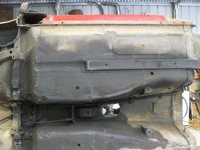

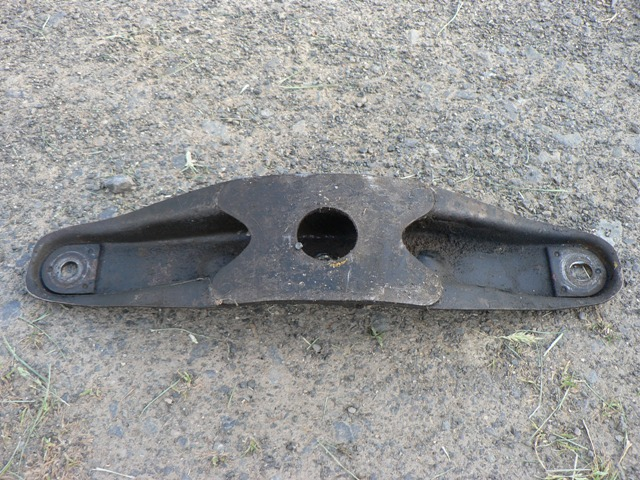

PeterAllen Posted October 25, 2010 Posted October 25, 2010 Hey guys, Saw someone mention that a sticky on this topic would be useful so here it is. I've stolen the posts from a wanted thread to fill out this one. I'd appreciate any other contributions for different years' mounts that we don't have pictures of yet. Cheers, Steve My car in a 3/72 build. It came with no motor or gearbox but a few boxes of assorted items. This looks like the gearbox cross-member (Edit: This is the early 240z auto transmission cross member) and I've included a photo of the body mounts before I cut them off. Quote

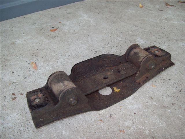

nat0_240_chevZ Posted October 25, 2010 Posted October 25, 2010 MMM Peter that one is different again to the stock vert bolt up i have ie a 3/71, exact tunnel as pictured, but the oem item is very different, ill try get a pic & share any how. Its info like this that needs a sticky, ie the difference of said items along the years, ie 'check out my ......' model year liklyhood of being altered along the way scale. Your mount looks like a transition mount from the tunnel as pictured to the later style long bolts from front to back ie the later 'ear' type mounts, My oem item is only a '1-piece'. nat0 Quote

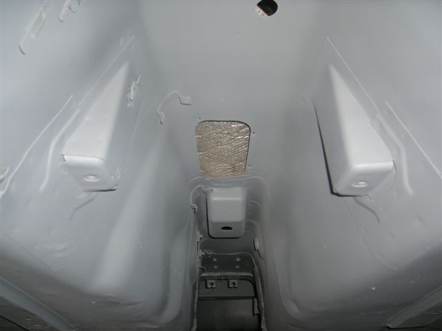

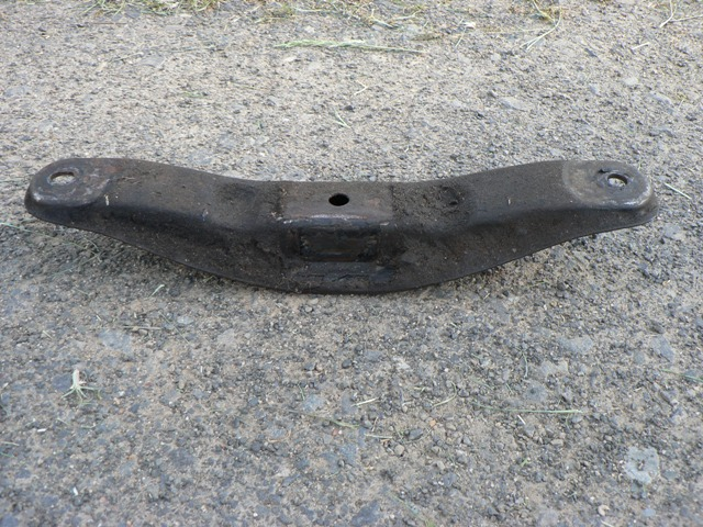

KatoKid Posted October 25, 2010 Posted October 25, 2010 I'm with you Nato......need to sticky this sort of stuff. Here's photos of my 4/71 #728. Mounts built into the tunnel look the same but its a very different X member. Quote
nat0_240_chevZ Posted October 26, 2010 Posted October 26, 2010 YEP Same as katokids, is the one i have..... well had, as like i said i made my own ones. nat0 Quote

NZeder Posted October 28, 2010 Posted October 28, 2010 The pic of the different cross member is for a 240z early shell with the mounts on the body as shown but not the manual that is the auto cross member Quote

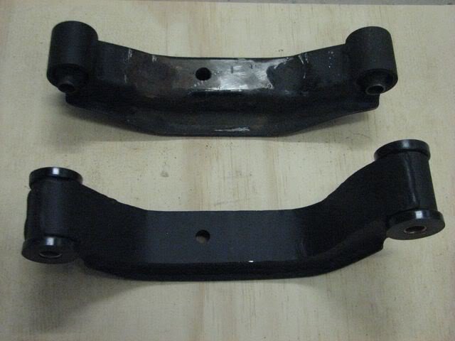

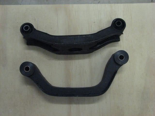

garvice Posted February 20, 2011 Posted February 20, 2011 I didn't take any photos of the mounts before I cut them off, but here is a shot of the crossmember from an 1976 (Nov build) 260z 2+2. (top crossmember in each photo) Quote
