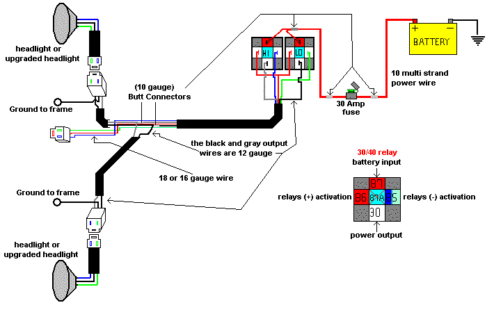

Nacks Posted May 17, 2005 Posted May 17, 2005 Hi, I used to be an Auto Electrician, a good bet is to get yourself a pair of H4 quartz halogen headlights and install a twin headlight relay. You'll love them. I fitted 130/100 globes to my H4s and they're mint. I also fitted a relay to the (+) side of the lights to eliminate any voltage drop to either side of the globes. A relay really is needed, otherwise you run the risk of crap headlight performance due to serious voltage drop over a 30 year-old wiring system and possibly melting headlight/dipper switches due to the increase in current draw. Put simply, it just bypasses most of the wiring system and gives you a feed pretty much straight from the back of your alternator to the headlights. FWIW, 260Zs have a 12v(+) feed to one side of the headlight globe and switch earth (-) to swap high/low beams, instead of most normal cars that switch the 12v (+) side of the globe. Nacks Quote

Rod F Posted September 7, 2005 Posted September 7, 2005 I just installed a Narva headlight upgrade kit from Bursons for around $80. It included new lenses and a pair of 55/100 watt globes. Although the standard beam (55 watts) isn't very powerfull, over my standard sealed beam lenses (which were 55/60 watts) they make a world of difference. I also installed twin relays and drew power from the + terminal of the alternator. Definately recommend this upgrade for anyone with stock headlights as crap as mine. Quote
Natez Posted April 30, 2006 Posted April 30, 2006 hey i will be upgrading my headlights tommorrow, one sealed beam is out, and can't be botherd fixing that, so i want new everything up the front to be able to see, and doing a double relay upgrade... wiring diagram here, stole it from Dave, on classic Z cars, http://www.classiczcars.com/forums/showthread.php?t=20016&highlight=headlight+harness Quote

Bruce Posted April 7, 2011 Posted April 7, 2011 Following on from the seperate recent thread on HID upgrades, I thought I would revive an old thread on a similiar topic. My 240z is still running the sealed beam original headlights, before upgrading to HID I thought it would be appropriate to upgrade to some H4 headlights as described above. The link above (to classiczcars.com) showing the wiring diagram doesn't appear to be working. Does anyone have this documented anywhere that they would care to share? thanks Bruce Quote

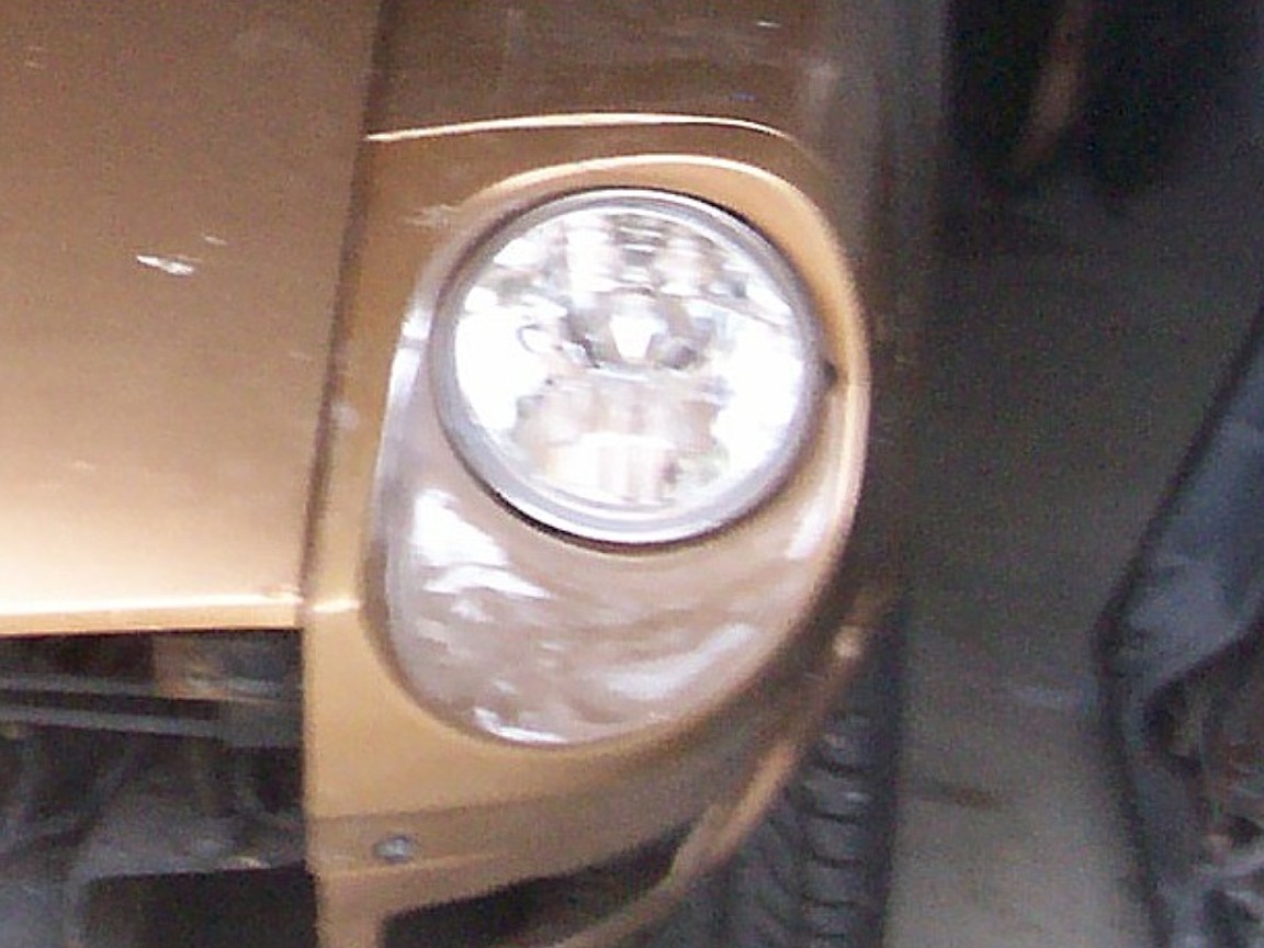

benny Posted April 29, 2011 Posted April 29, 2011 Well Just finished bruces headlight upgrade!! Ill let him post back the results after his drive home!! They looked a whole lot brighter then his old sealed beamers!! Quote
Bruce Posted April 29, 2011 Posted April 29, 2011 Benny upgraded my headlights to halogen inserts yesterday arvo. Comparison between orginal sealed beams and new lights is like chalk and cheese. great job Benny!!!! Quote
