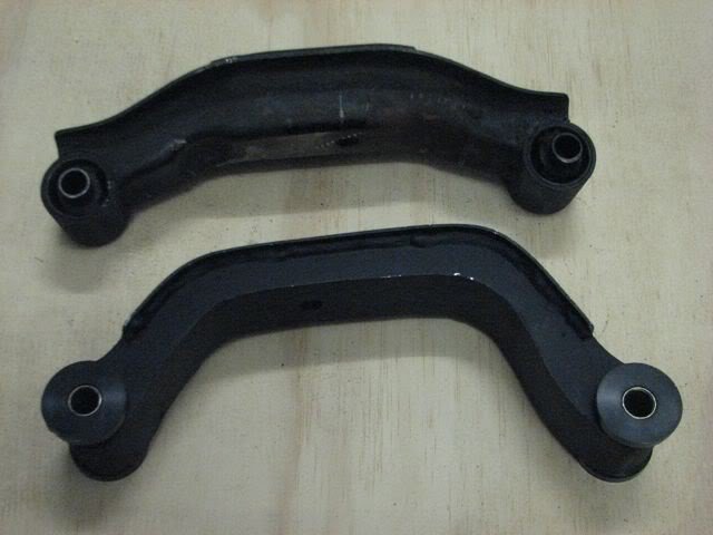

Grandad Posted February 28, 2013 Posted February 28, 2013 Well progress is slow but at least it's progress. The original supports that hold the door window glass were severely rusted so rather than try to repair them we went looking for replacements which raised some challenges because being a late 260 these parts were upgrades and not compatible with earlier cars also by the end of the 260 model run the 2+2 significantly outsold the coupe so we found locating coupe window supports somewhat challenging but heard that 2+2 supports could be modified to fit, Dim came to our rescue (thanks mate) with a 2+2 set which only required a little shortening and some new holes. Dad Original Coupe top 2+2 bottom Modified 2+2 top original Coupe bottom Modified supports good to go Finally got all the paint and undercoat off the underbody componants ready for powder coating and delivered them to the powder coater today sadly the plastic tail light surrounds were rejected so will have to be painted were also having the grill done in expectation of it withstanding track conditions better than paint, time will tell Quote
