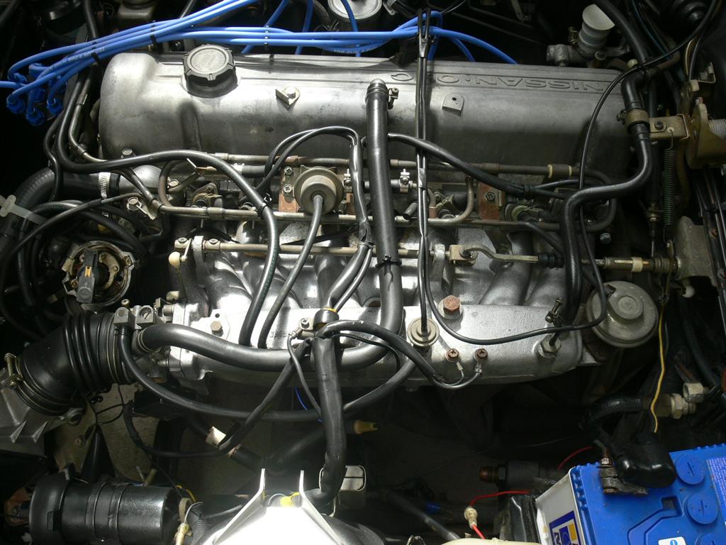

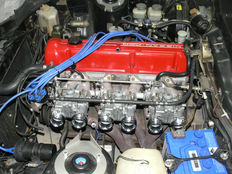

luvemfast Posted November 23, 2009 Posted November 23, 2009 I am in the final stages of getting the car back on the road, or so I thought. I have discovered there is more work to convert to triple Mikuni's that I first thought. Here's a list of things that I have been advised to do- Replace EFI fuel pump with lower pressure one Replace Cam Lash pads Re-Grind rocker arms Then Dyno tune for timing and jetting. Not expecting any change from $1000 for all that. This all takes time and money. Or I can just replace the old factory EFI set-up. Since I have been working and a GTR individual throttle body set up for the future anyway. So any advice, opinions or offers of help? Simon Quote

luvemfast Posted November 23, 2009 Author Posted November 23, 2009 The final decision could come down to legalities. I can go to carbs as its only on CH plates. I've always wanted triples, since I was a kid. Can't beat the sound. Here's a comparison pic between the two set-ups. Not sure why the cam needs changing either, but to my mind, if you are going to put individual throttles on later anyhow, why put the triples on at all? This could take me a while to do as I just want to get it on the road/track again and enjoy it for a year without any more 4 week projects that turn into 10 month projects. Quote

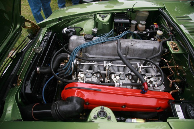

260Coupe Posted November 25, 2009 Posted November 25, 2009 The airbox is the rarest part of the whole setup.......it is off a '66 Prince Skyline GTB which had triples fitted as standard. It need some minor modifaction as the Prince carbs are stargard in height so there was some welding and realignment of holes to get it to fit. These are very hard to find and I came across the last in existance (or so it seems as we have tried to find more) The airbox boost mid range power, looses no power at top end and is quiet and EPA friendly as I have the crankcase and rocket vented to it reburning the gases. The front filter housing is from a US spec 280z (S30 260z fitted with the fuel injected L28 ).........bolts straight into the existing mounting holes. Quote
Administrators gav240z Posted November 26, 2009 Administrators Posted November 26, 2009 Simon Go the triples, when set up properly they will feel just like injection. If you are coming to the NDSOC Xmas party then you can have a drive of my Zed and see for yourself..........throttle response is instant and as smooth as silk ............(Lou knows his stuff) Alan Looks great, I'd say any parts for a Prince GTB would be impossible to find now. Do you know if Gavin Strongman ever made more of the Airboxes he put on his 260z? Quote
260Coupe Posted November 26, 2009 Posted November 26, 2009 Not sure..........I did try and contact Gavin some time back but did not get a response.........and then I came across the GTB airbox which is factory tested and really works (and I tested it on the engine dyno as well) We proved that it helps and doesn't hinder performance.(as some airboxs do) The GTB air box is flowed and tapered to enhance air flow........not sure how well the others actually work Steve Newing also had an airbox he was working on some time back. Quote
Moderators Zedman240® Posted November 26, 2009 Moderators Posted November 26, 2009 Steve Newing does have airboxes ready for sale now. I think they are going for around the $300 mark but apparently work very well; look very similar to Gavin Strongman's airbox. I intend to get one but firstly I need my engine built first! Quote
