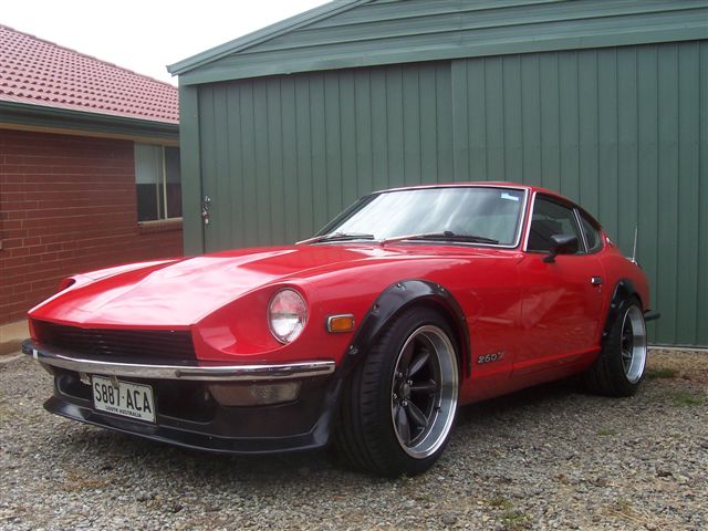

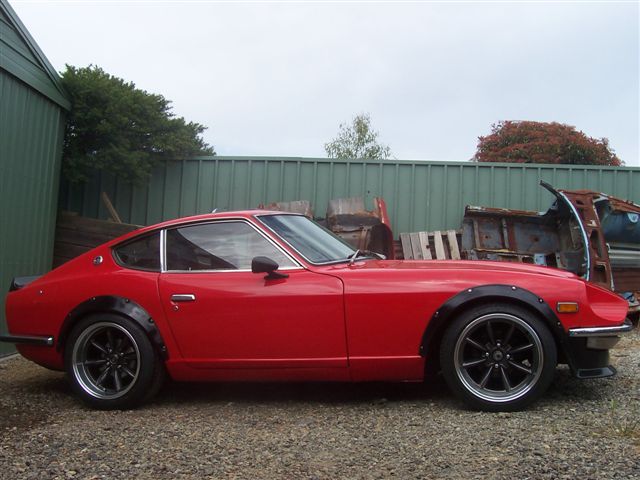

jeff43 Posted October 24, 2009 Posted October 24, 2009 Here is my 260 2 seater. Just finished cutting the rear quarters and putting some coil overs in. Pretty happy with the stance now. Next steps are bitter brakes up front, disc's in the rear, adjustable control arms and radius rods, an LSD, an engine that pulls somewhat harder and some motorsport style seats. Quote

dazzed Posted October 25, 2009 Posted October 25, 2009 when you say that you had finished cutting the rear quarters , is this a procedure for fitting the flares , to accommodate the larger wheels? i had the idea they fitted over the top , is this a big job to fit these flares, do you have to cut the front also? cheers Dazzed Quote
jeff43 Posted October 25, 2009 Author Posted October 25, 2009 when you say that you had finished cutting the rear quarters , is this a procedure for fitting the flares , to accommodate the larger wheels? i had the idea they fitted over the top , is this a big job to fit these flares, do you have to cut the front also? cheers Dazzed G'day Dazzed. If you want to run wide wheels to fill the flared guards and lower the car you will need to cut the rear quarter guards. The fronts may need to be cut also. I still need to ascertain if I need the fronts cut with the 225 tyre size I have on the front, I may get away with rolling the lip. There is a good guide of at hybridZ.org if you do a search it is a sticky by a guy from the states named Austin Hoke. That is what I used for inspiration. Hope this helps. Quote
dazzed Posted October 25, 2009 Posted October 25, 2009 ill have a look, just looking at your wheels again , yeah geez theyre huge , i can see how you will have to make it all fully adjustable , be like a train on rails once you have done all that , looks tuff , thanks Dazzed. Quote

Scando Posted October 28, 2009 Posted October 28, 2009 That looks awesome, nice work! Are the front wheels 8.5 inch? If they are then I reckon you might get away without cutting the guards with the 225's depending on how much camber you run. Quote
jeff43 Posted October 28, 2009 Author Posted October 28, 2009 That looks awesome, nice work! Are the front wheels 8.5 inch? If they are then I reckon you might get away without cutting the guards with the 225's depending on how much camber you run. 9.0 inch on the front. I think I may get away with just rolling the lips. I drove it to work yesterday and did get some rubbing on the front left. Might have to lift it up a little too. I am getting a slight rub on the rears when cornering. Thinking about 10mm all round. Quote
Scando Posted October 28, 2009 Posted October 28, 2009 Ah, ok. The offset on the 9's isn't quite as nice as the 8.5's for the front which makes things a bit harder. I wanted to put 9's on the front of mine too but it wasn't going to work without doing some serious hacking! Managed to get 245's on the 8.5's with heaps of clearance. What are the rears rubbing on? The flare or the guard inside? Quote
jeff43 Posted October 28, 2009 Author Posted October 28, 2009 The rears are rubbing on the guard inside. Only just I think. A little more ride height I hope will sort that out. At worst I will cut the front guards as well. Quote
