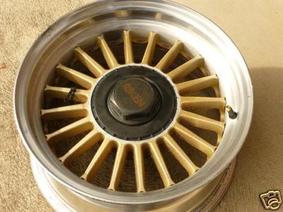

nice car. very clean interior expecialy for light coloured.
the rims should look good. i had similar ones on my tX5 years ago.
as long as offset i sok should be ok.

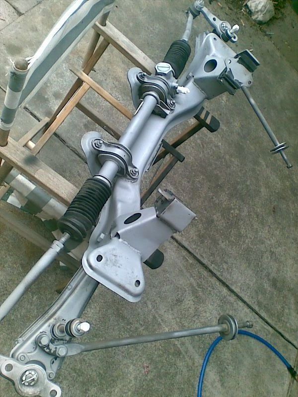

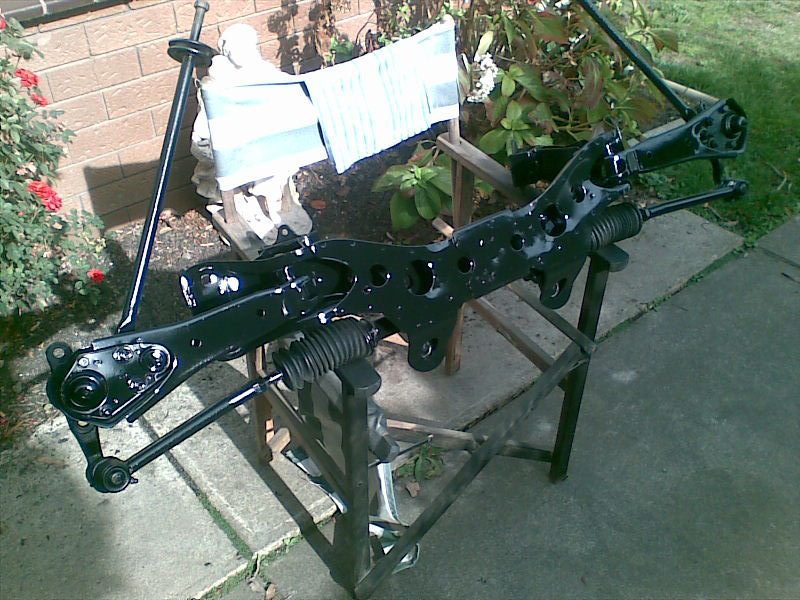

Got a bit done this weekend. Engine out and gave the block a bit of a clean. Removed the front cross member and attached bits to take to work tomorrow and give them a blast ready for paint.
All rubber and joints have been done, except  lower c/arm and rack mount. They are good already. I have shimed the rack mount rubbers just to make it even more tight.
Looks good Thomo :)
While your at it, pack the Radius Rod out with some thick washers to gain some more castor... ;)
Looks good Thomo :)
Funny thing you say that Lurch, as it was already done. Bonus

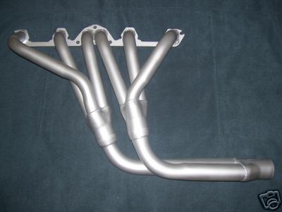

Also ordered these while I was at it. Got to be easier with the engine out than later on.
