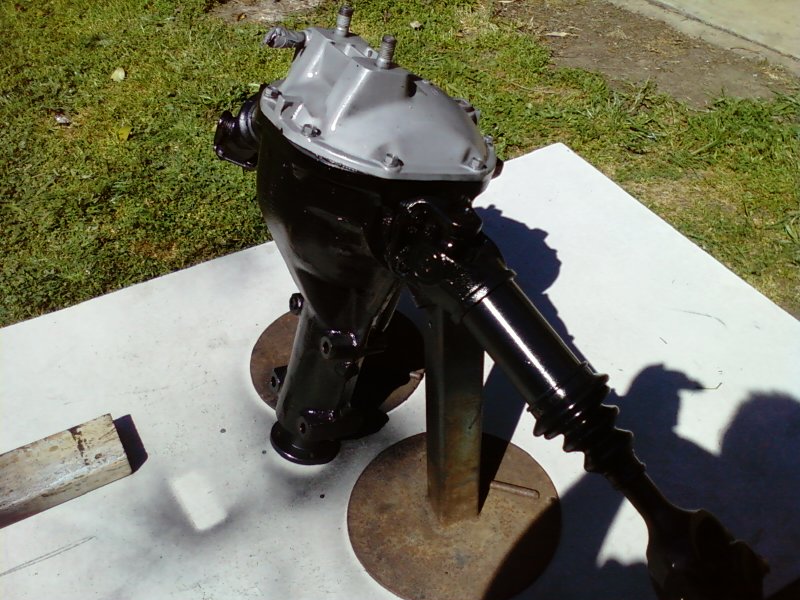

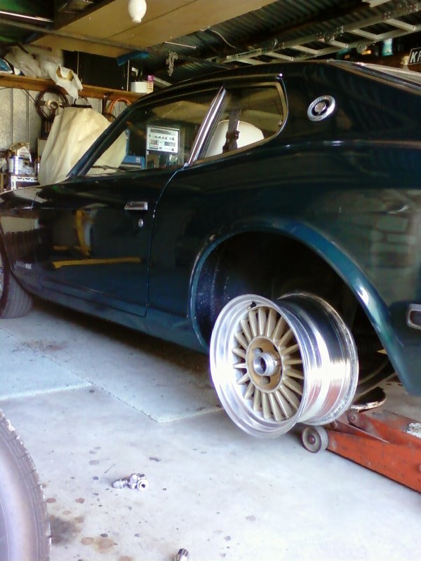

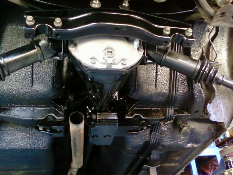

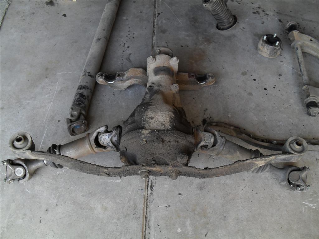

Thomo260 Posted October 20, 2009 Author Posted October 20, 2009 Well I have finally made a start on getting the rear end refurbished and detail it a bit as I go. Lowered King spring going in and will be fitting the Riken rims that I got off eBay for a bargain. Quote
Scoota G Posted October 20, 2009 Posted October 20, 2009 Wow... I think someone will be busy with the sand blaster at work!!! Shhhhhh! Quote
zedevan Posted October 20, 2009 Posted October 20, 2009 nice wheels, looks like they fit quite well! Quote
garvice Posted October 21, 2009 Posted October 21, 2009 can get this in 100mtr lengths if anyone else is interested. Looking good mate. I am definitely interested in the rubber material for the door (2+2) and rear window. Let me know how much you want for them. Brad Quote

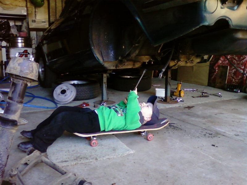

Thomo260 Posted October 22, 2009 Author Posted October 22, 2009 Wow... I think someone will be busy with the sand blaster at work!!! Shhhhhh! Yep, sure am. Only got the diff and trailing arms to blast then paint. I have had the apprentice on the job today, he is good at getting in where my hands don't fit. Quote
FuzzyDropbear Posted October 23, 2009 Posted October 23, 2009 Haha, child labour, love it Looking good mate, love those wheels. I gotta get around and actually have a gander at your Z. Maybe a chance for another ballarat mini-meet (this time I'll actually come )? Quote

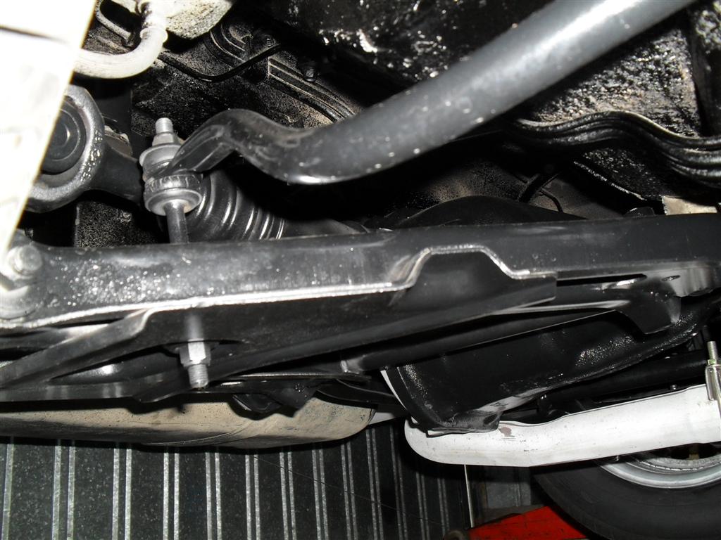

Thomo260 Posted October 24, 2009 Author Posted October 24, 2009 Some pics of how it looks now. Still waiting on new springs to arrive so for now only the diff and tail shaft is back in. Quote
Thomo260 Posted October 28, 2009 Author Posted October 28, 2009 Looking good mate. I am definitely interested in the rubber material for the door (2+2) and rear window. Let me know how much you want for them. Brad Have got a price for the pinch weld/door seal. I can get it for $9.00 p/mtr so all you would have to do is tell me how much you want and I can post it off. Postage cost will vary. 10 mts will do both doors and both rear hatch windows or 7.5 for just the doors, BUT you should measure yourself first to be sure to be sure. Cheers Simon. Quote
Thomo260 Posted October 28, 2009 Author Posted October 28, 2009 And i forgot to add that the springs are all in the car and the wet legs have been redone. Ride hight is perfect dropping it 30mm all round. I am waiting for the tyres to turn up for the rims before I post a finished pics. Quote

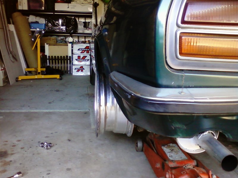

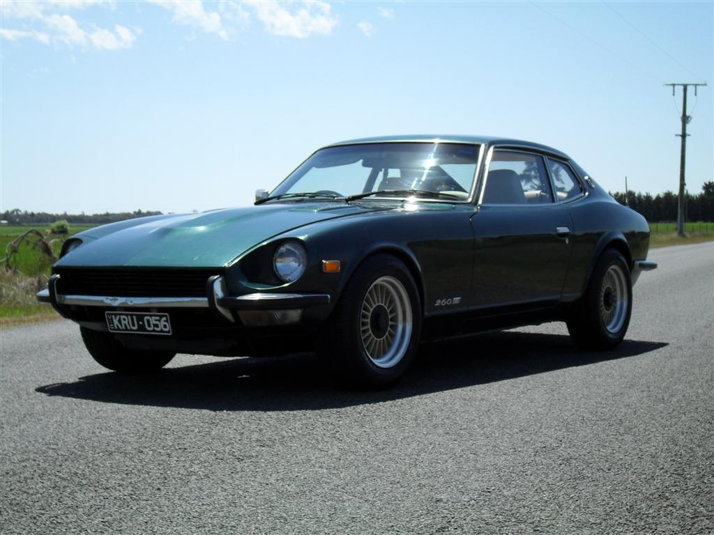

Thomo260 Posted October 31, 2009 Author Posted October 31, 2009 Got a quick pic today when i went for a spin. Will have to get some decent shots tho. Very happy with how the wheels sit under the gaurds but i need to roll the front lip just a tad. Quote
C.A.R. Posted October 31, 2009 Posted October 31, 2009 What a difference! How does it drive now, Simon? Quote
Scoota G Posted October 31, 2009 Posted October 31, 2009 Oh ah that's the ticket. Currently 75% of Ballarat Z club members working on their cars... C'mon FuzzyDropBear pull your finger out Quote
Thomo260 Posted October 31, 2009 Author Posted October 31, 2009 What a difference! How does it drive now, Simon? Drives great. Doesn't skip into the lane of oncoming traffic now . The auto trans fluid in the wet legs combined with the King springs work well together. I have only done a string line alignment atm, but i am usually only a mm or 2 out. Quote
