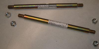

herrods Posted February 4, 2009 Posted February 4, 2009 Hey all, I have gotten a little stuck dismantling the rear suspension components on my 260. Im trying to replace brakes (conversion to disc) springs, structs and the bushes. So I need to pull the whole thing apart. I have gotten to a point where I have to pull the strut/brake assembly out of the car. I have the service manual and teh Haynes book as well, but neither are helping me. There is a spindle that connects the bottom of the brake/strut assembly to the lower control arm. The books both say to undo the bolts on both ends, and the locking bolt in the middle and release the locking pin, (all done). Then it says that the spindle can be pulled out. Pulled out turned to tapped out, which turned to belt out, it moves about half an inch in either direction before it stops like its hitting something, but I cant figure out what it is. Can anyone think of a way to remove this piece, without doing so i fear my zed will be in pieces for ever!!! Quote
Administrators gav240z Posted February 4, 2009 Administrators Posted February 4, 2009 This is a real pita on early Zcars. The spindle pin is often not easy to remove and many use a "spindle pin puller" to remove it. I think some guys at hybridz.org were making them up a while ago. I would pull the whole strut assembly and take it to a suspension shop and ask them to press it out. You might need to buy new spindle pins from Nissan if you have damanaged the thread on them trying to smash them out. Quote
Moderators Zedman240® Posted February 4, 2009 Moderators Posted February 4, 2009 The problem is if somebody doesnt install the locking bolt correctly, and they end up hammering it into place, it burrs the sides of the flat part of the spindle pin making it bigger meaning when it comes time to remove it, it moves back and forth but not out! When I removed mine, it just needed extra brute force to hammer them out with a suitable drift to "extrude" it through the smaller hole of the a-arm. I think new pins from Nissan are around $120 each....I think.. Quote
Scando Posted February 4, 2009 Posted February 4, 2009 Yep, mine just took a lot of brute force to get them out. As Zedman240 said, make sure you use a suitable size drift so you don't damage the thread. Quote
Moviefan Posted February 4, 2009 Posted February 4, 2009 If all else fails get a bigger hammer. The Threads are probably stuffed by now so swing away. It took my copper 2 lb hammer to persuade mine. Last price i was quoted in September from Nissan was $80.00 each .If that's still the case try MSA. $28.40 Us each http://www.thezstore.com/page/TZS/PROD/SSSC01C02/23-4240 . last time they sent me some they charges $31.00 Us Postage. Quote
zzzzed Posted February 5, 2009 Posted February 5, 2009 It didn't mater how bigger hammer i used mine would not budge, so i took it to a machine shop, they could net get it to move either so the cut it out Quote

JP Posted February 5, 2009 Posted February 5, 2009 A propane torch was the best investmant I made in disassembling the suspension and steering in my Z. Everything is so much more cooperative when hot. Penetrating oil or a WD40 overnight bath has also helped on occasion. Make sure not to damage the thread if youre bashing away too hard! Quote

herrods Posted February 5, 2009 Author Posted February 5, 2009 Well soon after posting this i found several posts covering the same thing. my seach terms (thingy, stuck, pole, arrrrrgh) werent accurate enough anyway, i pulled the whole control arm out and intend to bash it out with it off the car as i have already stuffed the threads so i need new ones anyway. As i was looking at it, i would say a threaded cylinder that can be screwed on, with a loop welded into the end of it, and then the use of a slide hammer may also work, not sure if that would work or not, but but in my head it sounds more simple than the thread pulling idea. Quote
