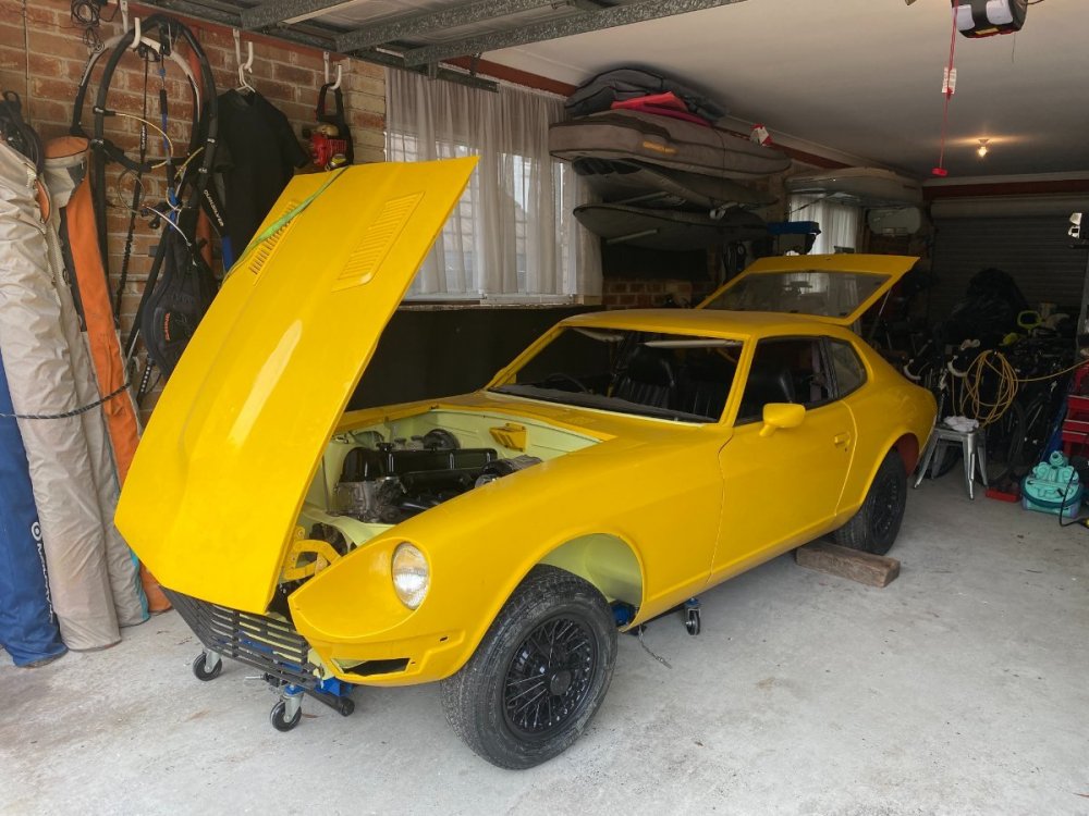

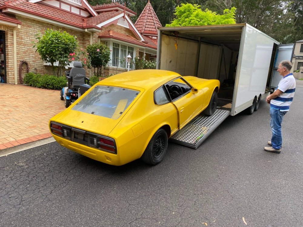

vosadrian Posted January 19, 2022 Author Posted January 19, 2022 So our car arrived in Sydney: We were expecting a few surprises and there are a few, but nothing major. I think this is part of being annointed into a S30 restorer! We will be on the lookout for a few bits but it seems to have the hard to get bits. I can see we are missing some large bits: * Fuel tank * Bumpers * Windscreen * Hood liner It has a partially dissassembled L26 (with turbo and manifold), but no gearbox. It seems to have a rear diff upgrade but we need to work out what it is. Our current plan is to get a RB25DE neo engine and a matching 5 speed manual (R33 RB25??) and fit that and get it running as stock initially. We have plans for RB30 hybrid and cams/porting etc later, but I think it best to debug the engine management and everything on a used engine rather than a new build. We will have to talk to an engineer first and see what we need to do that. The car has no rust which is great. It has a few knocks that will need some minor repairs and panel alignment and it will be getting a respray at some point, but probably we will get it all sorted and registered and then in the running state we want it in, and then dissassemble for painting as a final step. Seats and dash are in good condition. Just one minor crack in dash. ScottyD and gilltech 2 Quote
