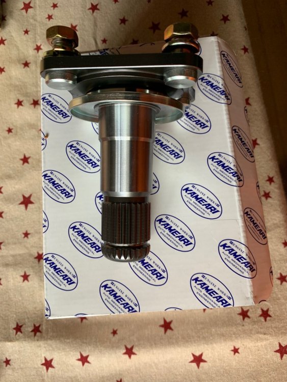

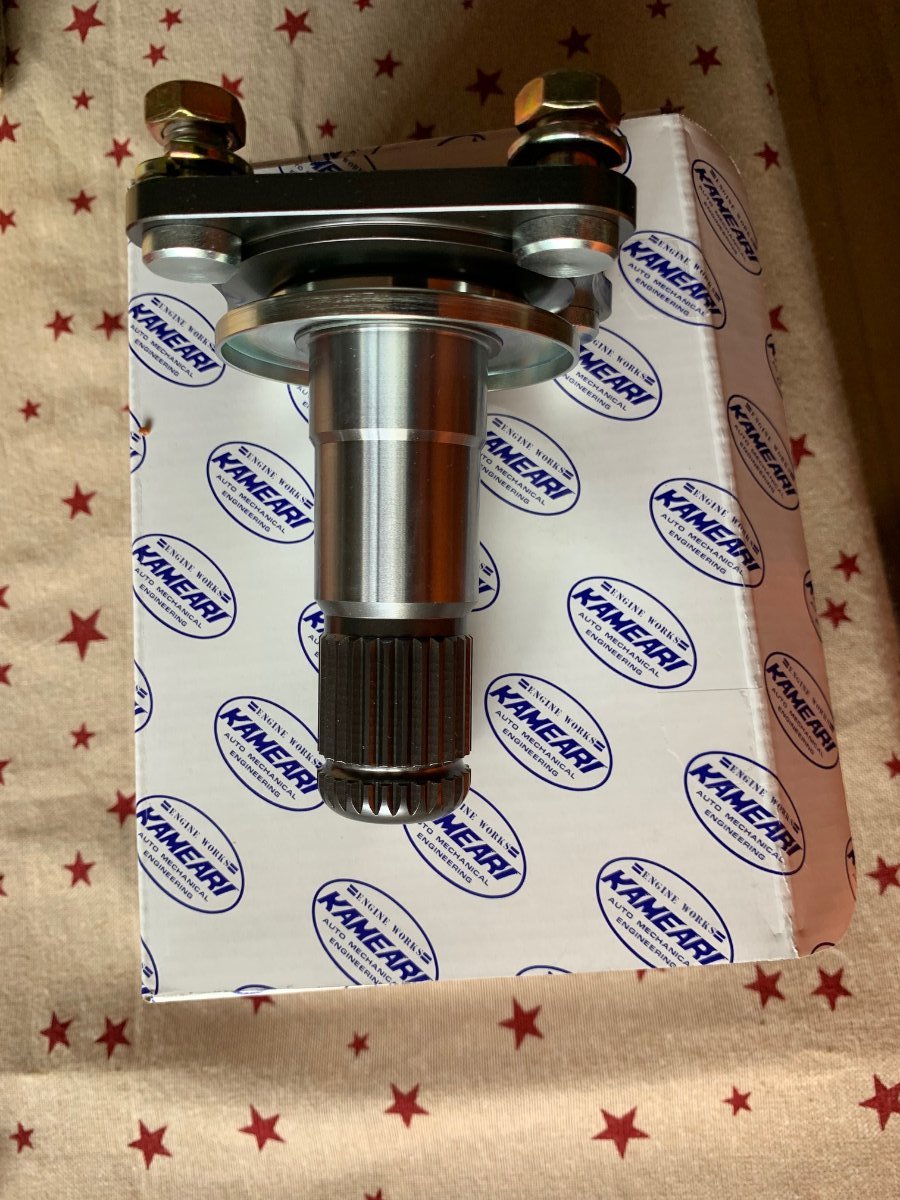

1600dave Posted November 16, 2021 Posted November 16, 2021 I'm in need of a new diff, looing at Subaru R180's. Going back thru old threads, I haven;t been able to confirm for sure what R180 the stub axle adapters fit ?Do any / all of the readily available stub axles adapters to run standard Datsun halfshafts fit both clutch plate and torsen diffs ? Or just one or the other ? And what are the current options for the adapters ? Kameari / USA / ???? My old diff was an RX turbo R160, bolts straight in, but sadly I've broken the LSD housing itself. RX turbo diffs are impossible to find nowadays so I'm thinking if I lash out on a pair of the stub axles, next time I break it I can just grab a new R180 and chuck it in. Quote
1600dave Posted December 29, 2021 Author Posted December 29, 2021 (edited) To answer my own question - yep, seems that both Subaru R180 clutch and torsen type LSD centres utilise the same output shafts. Or at least the Torsen style R180 from a 2018 manual WRX works with the Kameari shafts. And a plug for Kameari (and Fedex I guess) - ordered Xmas Eve, arrived on my doorstep this morning, $550 all up including post. Add in the $125 for the diff and the scrooge in me is very happy ! Edited December 29, 2021 by 1600dave Ponyo240z, 260DET, C.A.R. and 3 others 5 1 Quote
1600dave Posted January 30, 2022 Author Posted January 30, 2022 And done. Ready to hit the track in 2 weeks time. Enzo, gav240z, hmd and 2 others 5 Quote
