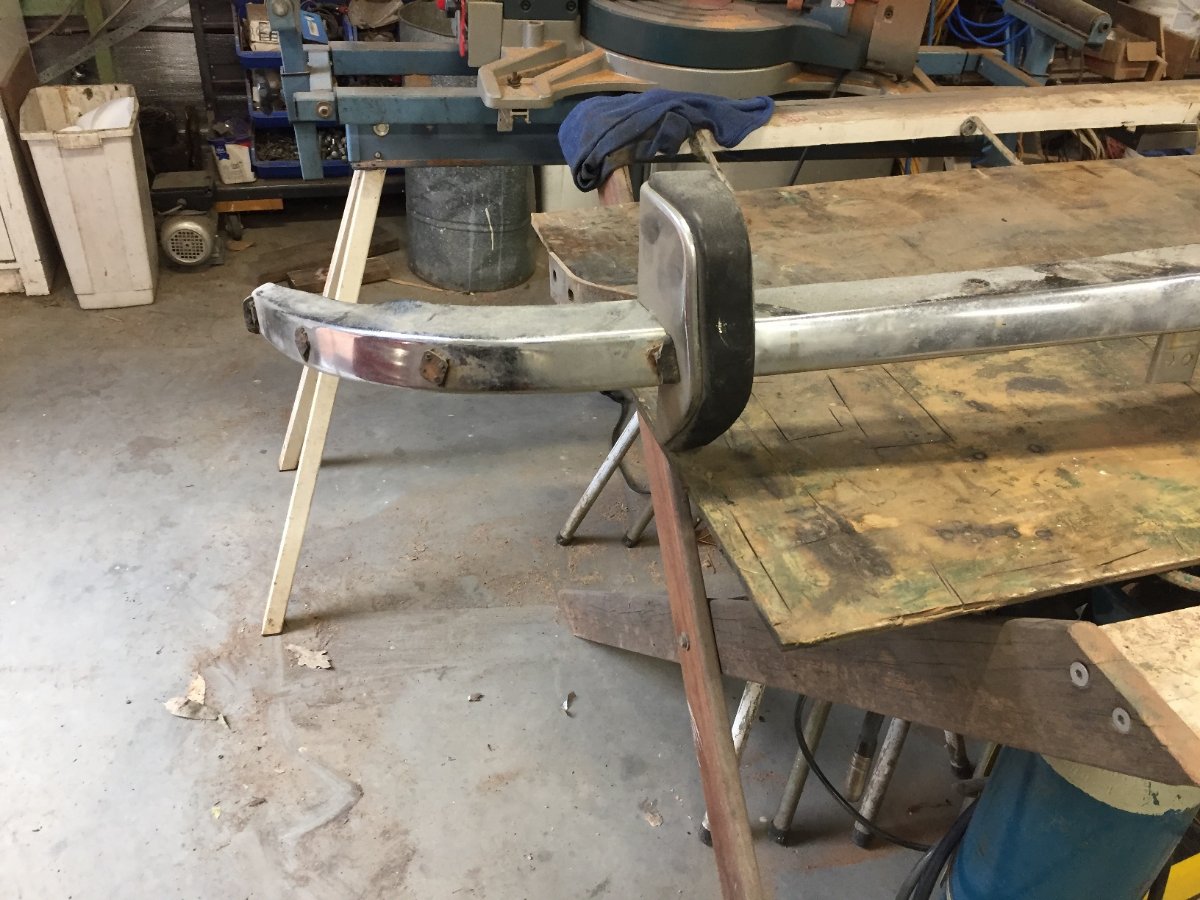

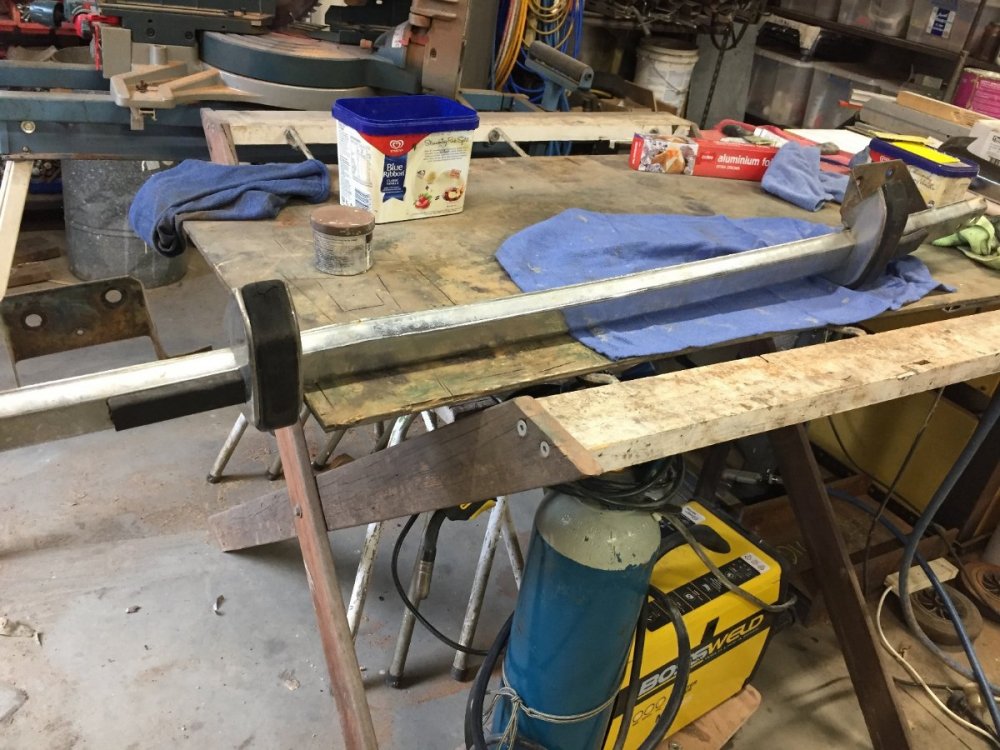

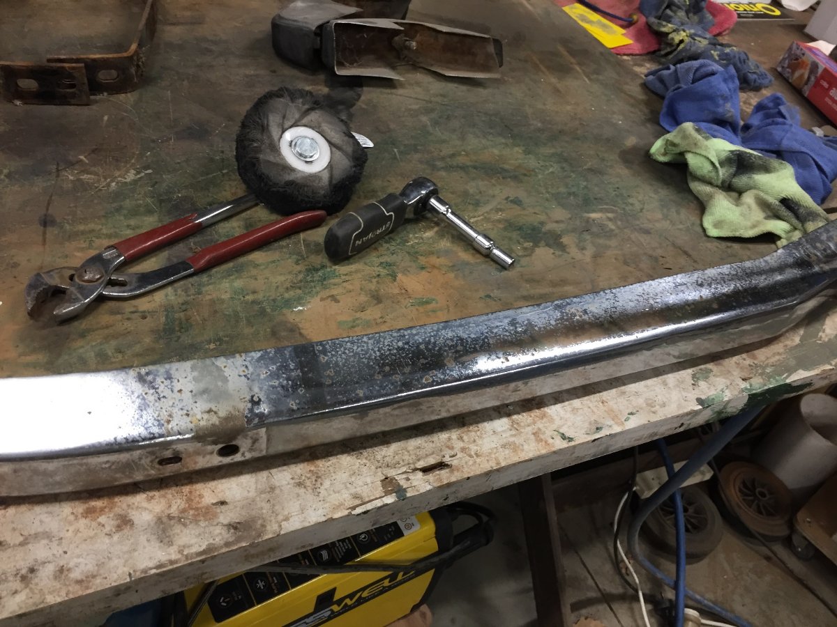

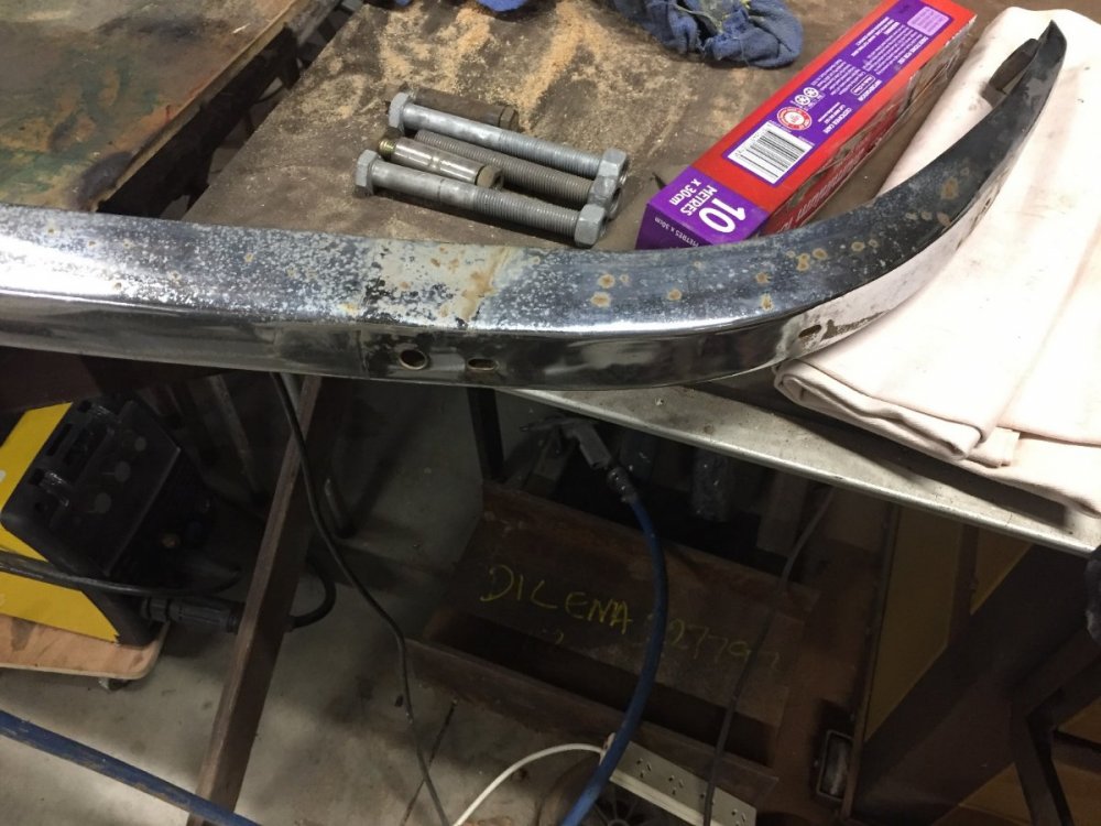

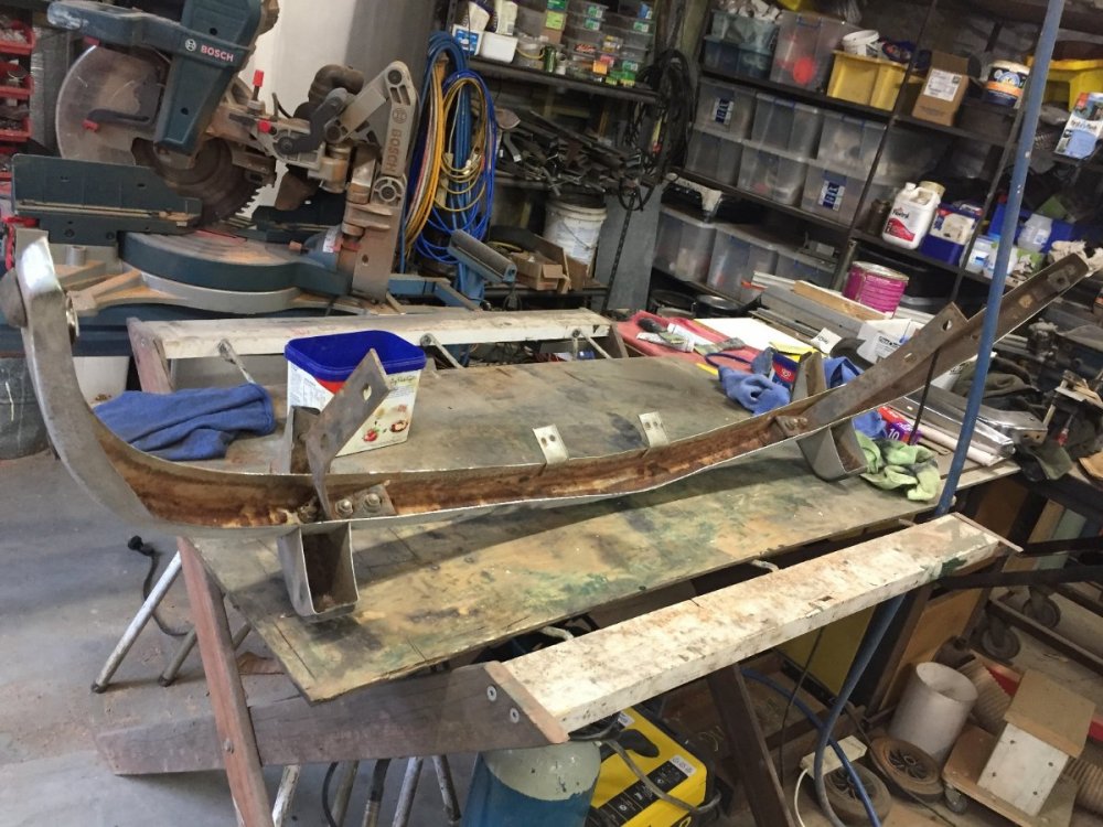

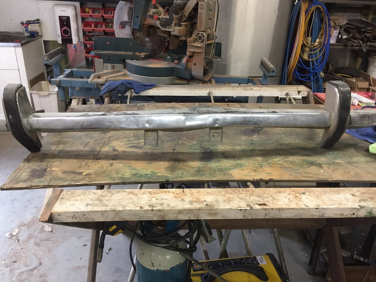

One of the things I'm starting to look at is my front and back bumpers. The ones on the car have a number of dents and have been taken to with a big hammer at one stage in an attempt to straighten out the result of someone's inability to reverse (and drive forward) without hitting things. It is possible they could be resurrected, but am looking for input as to what others may have done.
As I see it my options are: 1) Try to source a second hand set of front and rears in good nick, 2) Purchase a new set, 3) See if someone (ideally in WA) is capable of fixing and re-chroming what I have, or 4) Strip them back myself, try to straighten them, strip 'em, fill 'em and paint 'em to match whatever body colour I decide to go with. I don't want to do a bumper delete, so have discounted that.
Have attached some snaps of the front and centre section of the rear bumpers below. The centre section of the rear bumper took a big hit (see photo below to the right of the left hand over rider) and this has put a sway in the bar which puts everything out of alignment.

Have tried a couple of things - had to try the alfoil thing after seeing it on YouTube - fail. A gentle buff with a buffing wheel on the grinder - some improvement, but not enough and of course the dents are still there. And finally used a bit of metal polish which gave a slightly shinier finish than the buffing wheel. Either way, none of these approaches will get the dents out and straighten the bars up so the finished items are not going to work for me.
