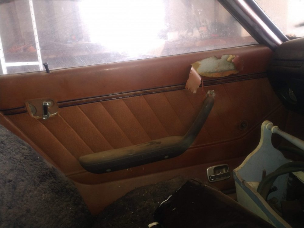

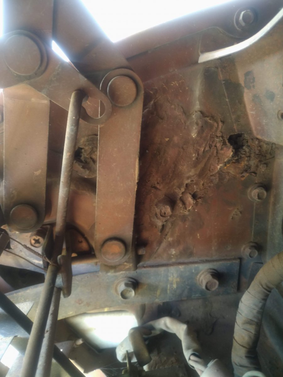

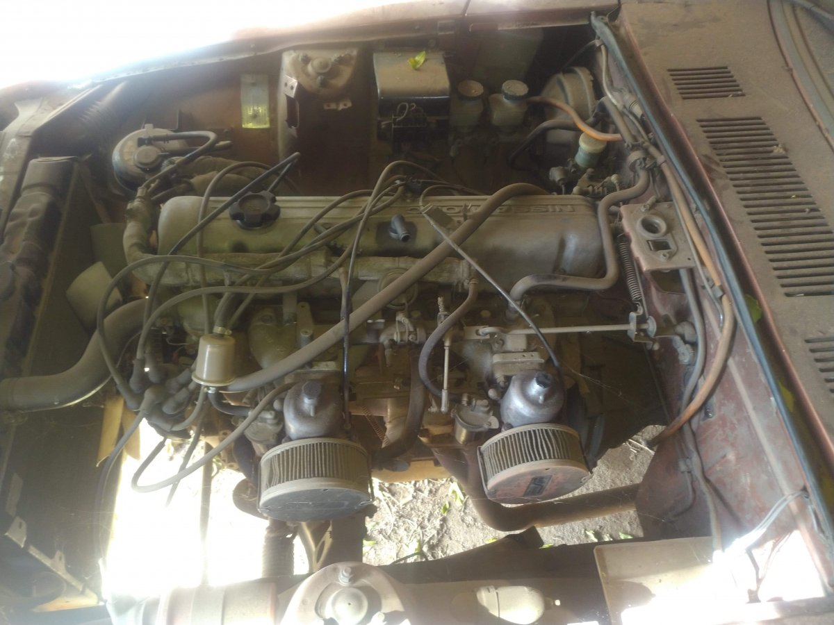

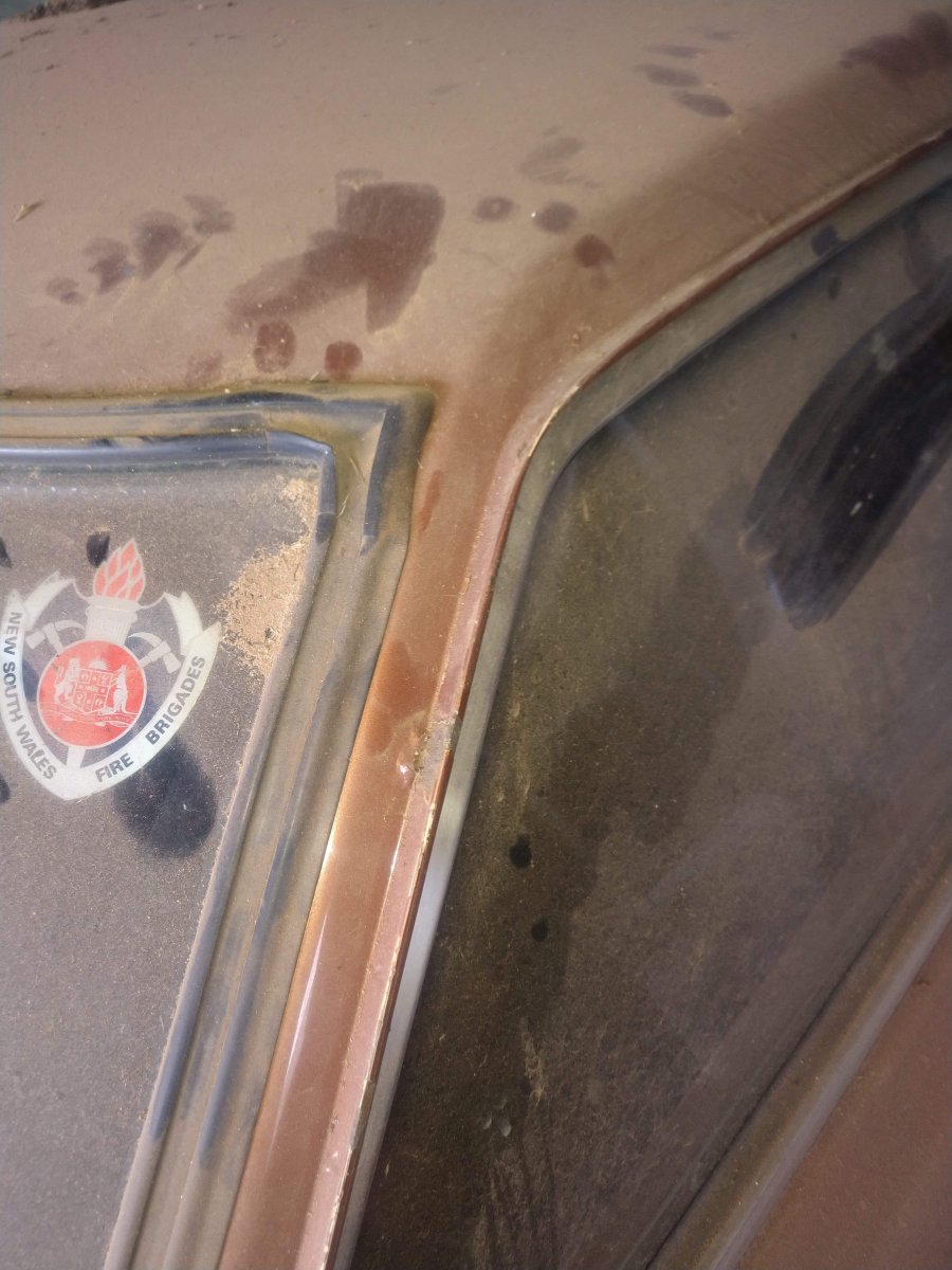

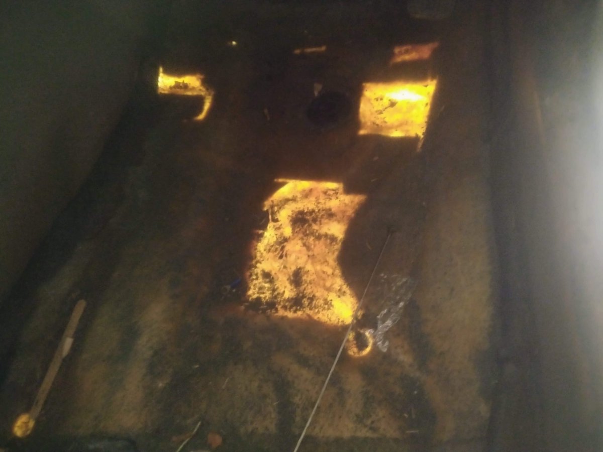

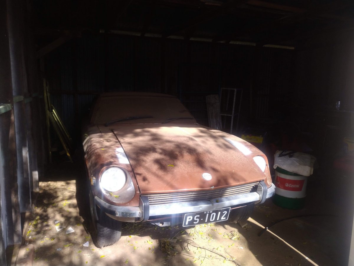

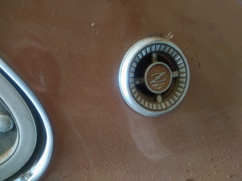

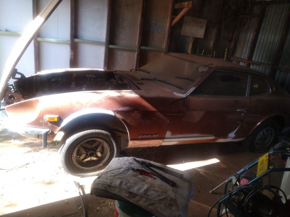

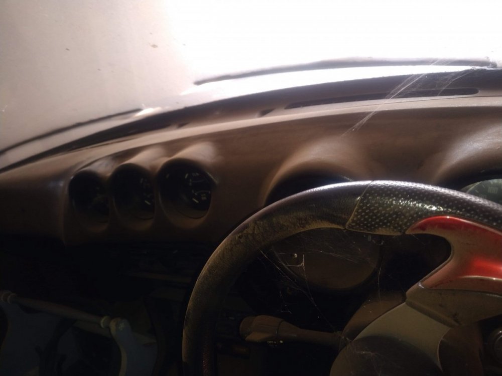

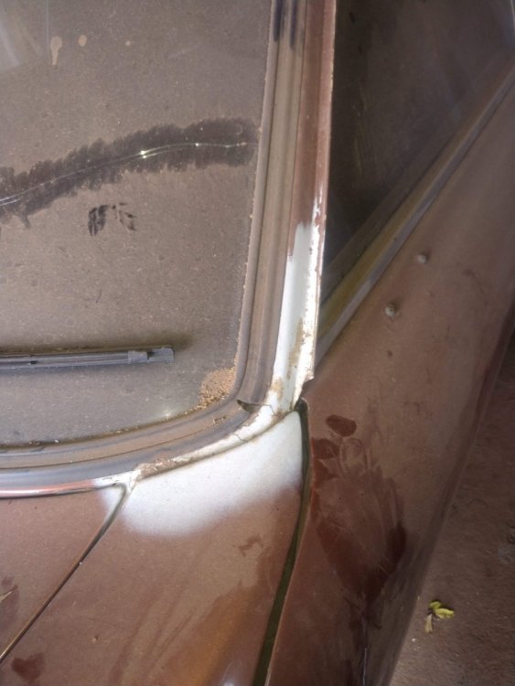

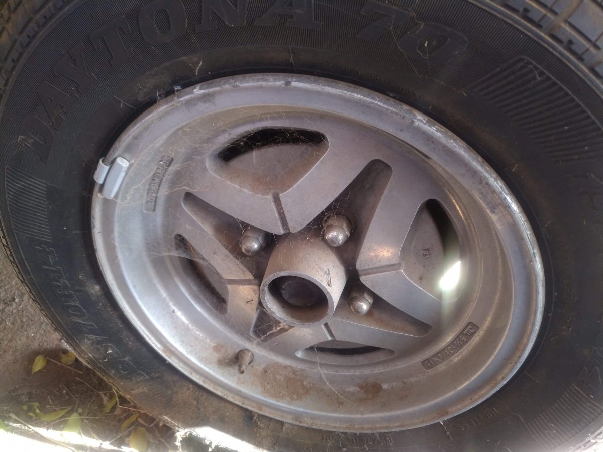

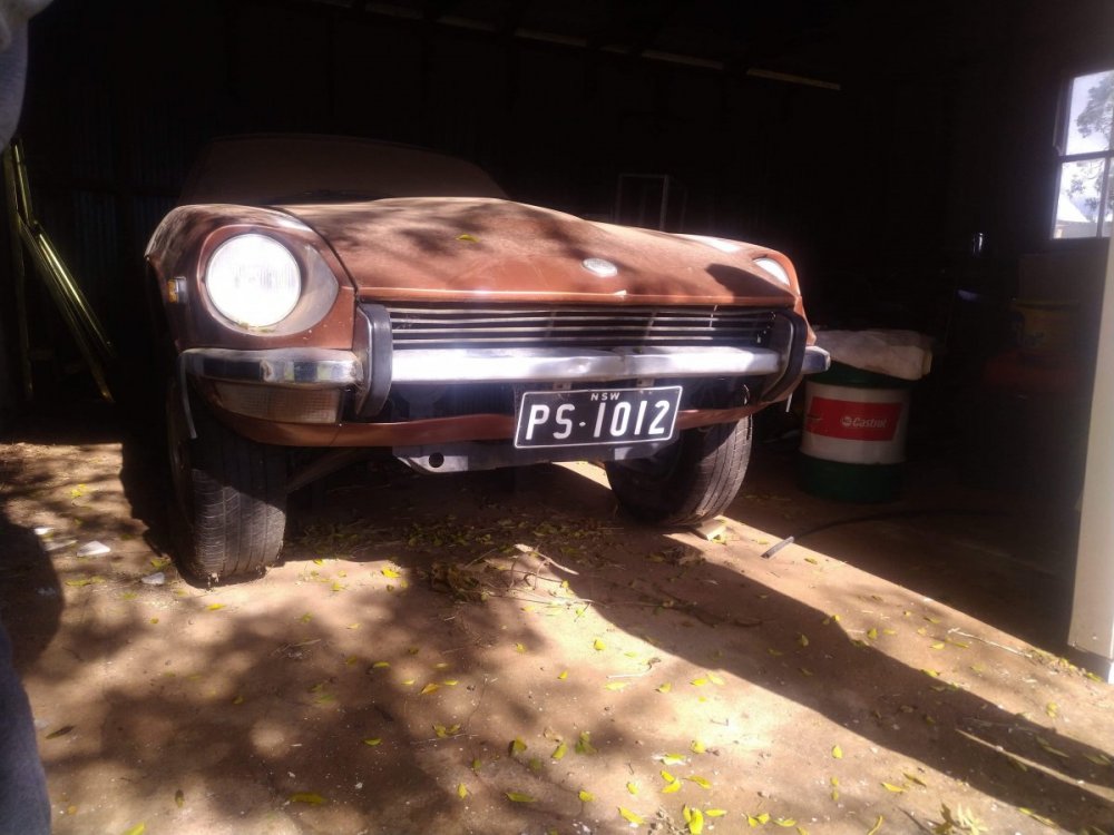

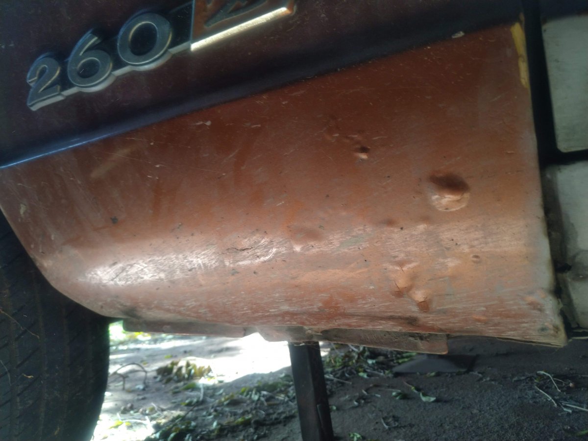

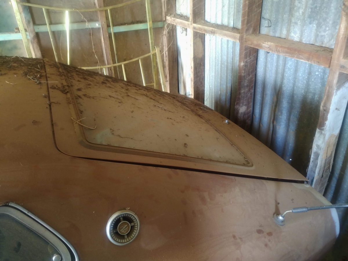

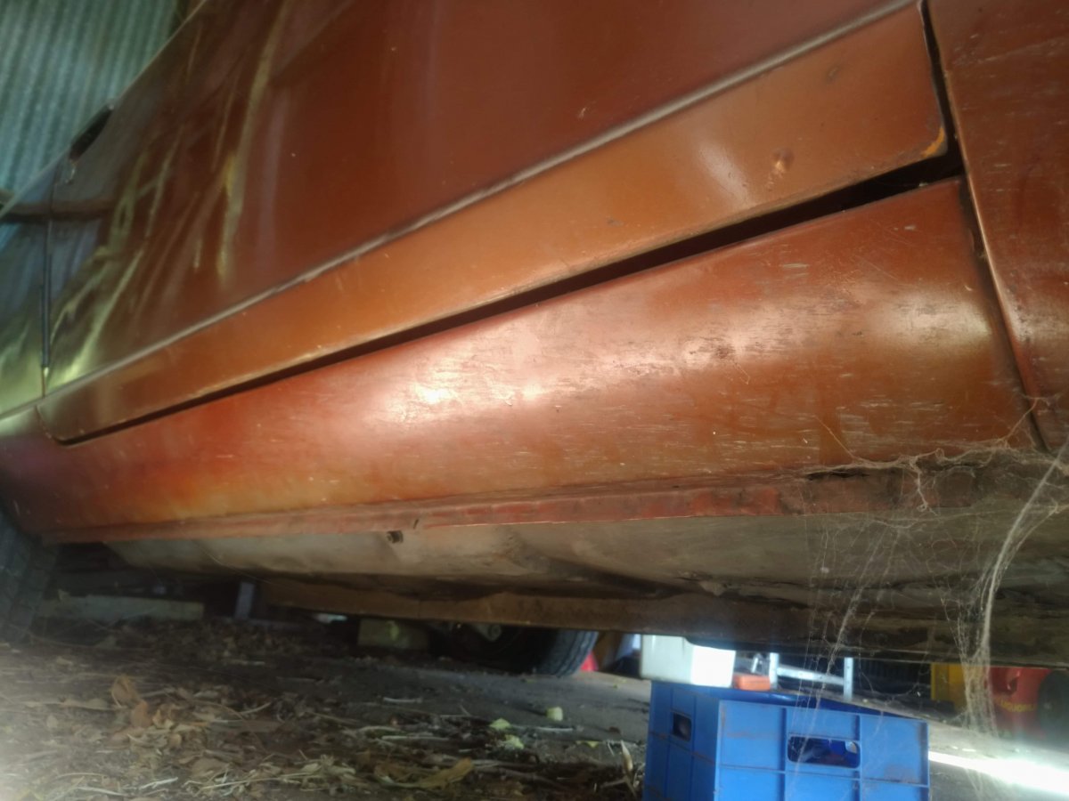

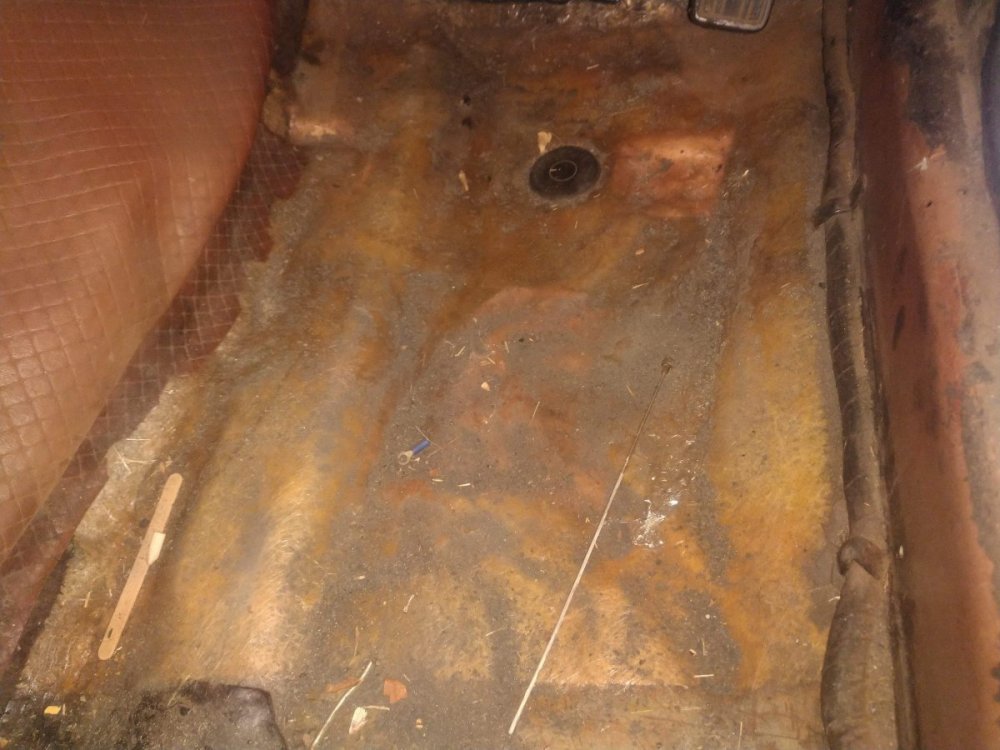

looking to buy my first Z this weekend its a 260z 2+2 1976 model I believe the bloke in its possession wants about 5,000 for it. what are your thoughts? Here are some images of it that the owner sent through, last time it was registered was back in 2004

For $5k seems very fair price wise, considering condition and work required to get it back on the road.
Posted (edited)
I agree - that's a fair price for a manual Bus.
Be warned though, you are up for many thousands in rust repairs.
It needs new guard bottoms, sills, doglegs (rockers) and door bottoms, floor sections and probably a slam panel...
Edited by C.A.F.
I was thinking (rough figures) but about 20k-25k to bring it back to bare metal repair have all the rust repaired and a respray in a dark cherry red??? Is that a realistic number
Provided those rust spots are all you find when you strip it back. I'd say that's a reasonable figure. But be prepared for snags along the way.

2jz would be an awesome pick and the one to go for just for the reliability I think... anyway better get back on track for now just thoughts on if the car is worth the 5k from the photos provided
2+2s have been increasing in price due to supply drying up. $5k is not a lot for an S30z chassis.(I've seen worse sell for more). But 2+2s are a little trickier to restore due to most parts being reproduced aimed at 2 seat cars.
I would go look at it and inspect the rust and straightness of the shell. If you're gonna restore a 2+2 start with a relatively solid / straight 1. A rough 1 will cost a lot more to restore long term and you won't get the money back within the next 5 years, maybe in 10.
