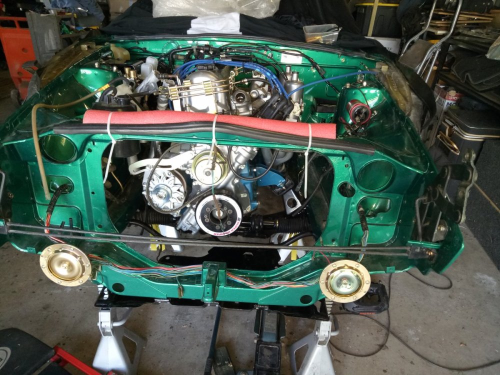

Gtv240z Posted October 1, 2018 Author Posted October 1, 2018 (edited) And now painted and reassembled.. I'll probably get the screws / nuts replated as some stage but for now just clear coated. I paid US$5 for these buy it now on ebay! Freight was a bit expensive probably US$35.. Bit of a gamble but has paid off. Edited October 1, 2018 by CraigZ Zedhead, RAP260 and OdinZ 3 Quote

Gtv240z Posted October 3, 2018 Author Posted October 3, 2018 (edited) On 10/1/2018 at 7:56 PM, Cozza said: Very neat. And, how do they sound? Haven't mounted both of them on the car yet for a test run, only bench test individually, hopefully this weekend I'll fit them. Edited October 3, 2018 by CraigZ Quote
Gtv240z Posted October 5, 2018 Author Posted October 5, 2018 On 10/1/2018 at 7:56 PM, Cozza said: Very neat. And, how do they sound? Fitted and tested! They sound good as new ones! Couldn't upload a video here so posted on Facebook.. See here.... https://m.facebook.com/groups/740335446098903?view=permalink&id=1472531162879324 Quote
