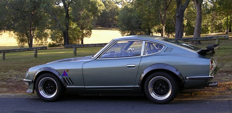

260DET Posted March 30, 2018 Author Posted March 30, 2018 Appreciate all the advice but it's a race car so easy touch ups are important and I've had good results from acrylic. Pic show my 260Z done in acrylic under the house with a Supercheap spray gun and not enough compressed air capacity. Quote
