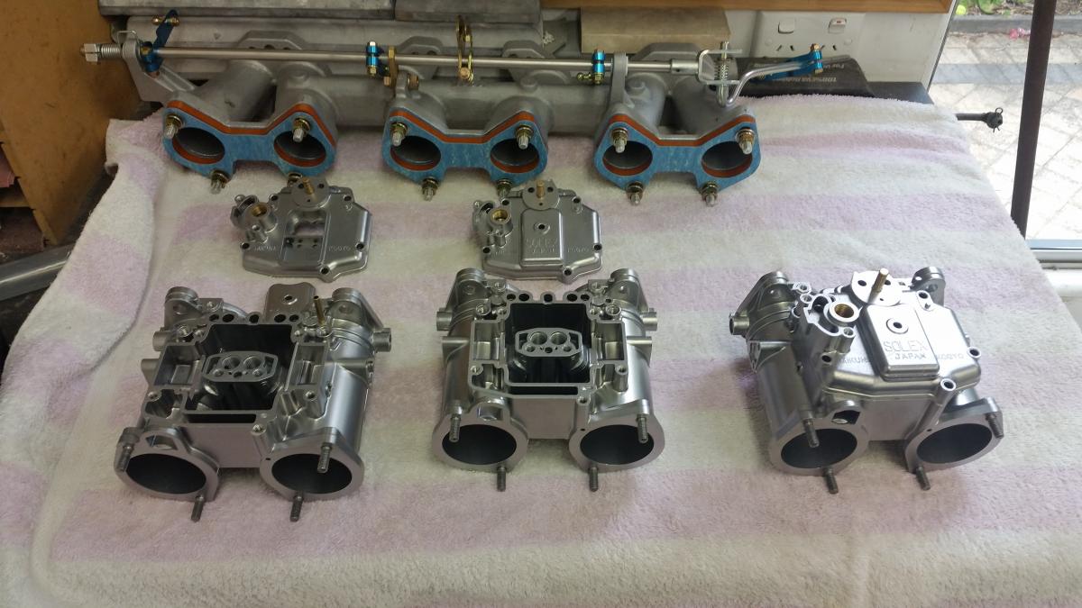

C.A.R. Posted February 18, 2018 Posted February 18, 2018 (edited) http://www.woodyshydroblast.com/ From this:To this: To get the steel fuel rail refurbished, you'll have to have re-plated.I recommend: https://www.yellowpages.com.au/vic/mordialloc/solar-plating-co-12534212-listing.html Edited February 18, 2018 by Lurch ™ LLN260Z, gav240z and smugley 3 Quote
Cozza Posted February 18, 2018 Posted February 18, 2018 They look great Lurchos. Do they have a clear coat or something on them to give them protection against future oxidation. I soda blasted mine in the back yard. They came up heaps better than they were but nothing like Lurch’s set. Only cost $7 or so in bicarb and 5 mins of my time though. LLN260Z 1 Quote
Administrators gav240z Posted February 18, 2018 Administrators Posted February 18, 2018 Water jet blasting sort of shot peens the surface so it's more resistant to oil impregnation etc.. So basically it cleans the surface nicely and then makes it more resilient against oil stains in future. Not sure about oxidation... God I wish you didn't sell those 50's Lurcho's! LLN260Z and OdinZ 2 Quote
