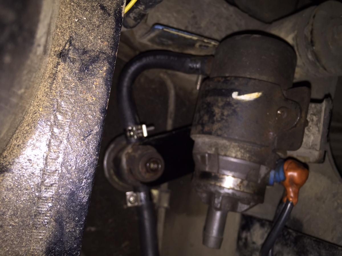

Moderators PB260Z Posted September 30, 2017 Moderators Posted September 30, 2017 Hi FWIW series 1 280ZX runs an external fuel pump. Pretty easy to fab up a bracket and fit the pump and pressure reg under the back of an S30, well it was on my '77 bus. You will need a fuel line adaptor as (from memory) the pump is 3/8 and the tank is 1/4, or is 1/2 & 3/8. I would also recomend fitting a small fuel filter in the line before the pump. I had crap in the tank that caused a few issues. Attached is a dodgy photo of the bracke bin place. If you wanted to come for a drive to Hornsby more than happy to show and tell. Cheers PB Quote
