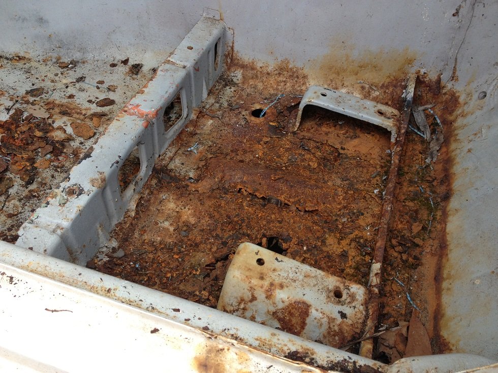

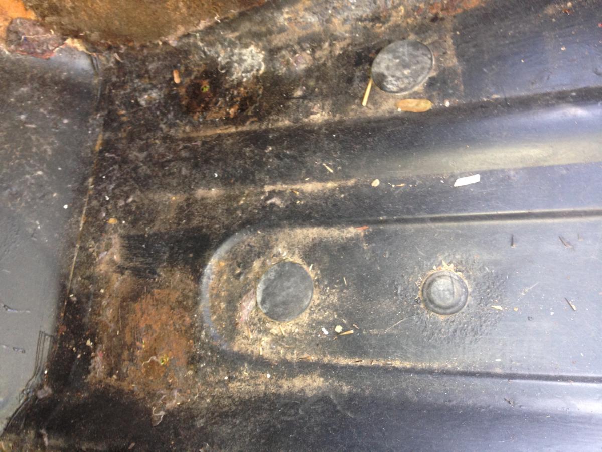

peter t Posted May 29, 2017 Author Posted May 29, 2017 Could do that Gav. But long term might be best to replace. Mostly bad around the area where the foot rest goes through and at the back where the join is. Quote

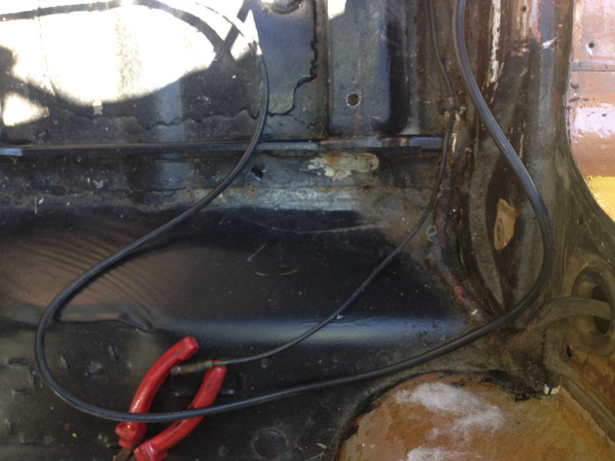

gilltech Posted May 29, 2017 Posted May 29, 2017 FWIW I'd remove the wiring that is in the way then hit those areas with 3M strip discs to take the rust & paint off & see what's what. I suspect it will all look a lot better when everything is all cleaned up back to shiny metal. Quote
C.A.R. Posted May 29, 2017 Posted May 29, 2017 '74 260Z's used the late 240Z bodyshell (excluding the tail light panel), so the Rare Spares floorpans are a direct replacement. FWIW I agree with Gilltech - strip the floors back to bare metal & see what they look like.If they are rusty in spots, it's easier to patch them rather than replace the whole floorpan. Quote
peter t Posted May 30, 2017 Author Posted May 30, 2017 (edited) Looks like I will get away with doing the passenger side only. Previos owners have painted with underbody paint and this really hasn.t sealed properly and rust has bubbled up under the paint. Too much carpet underlay has held all moisture in. Rare Spares are exact fit but they didn't know left from right until I explained they had the wrong part nos on them. Edited May 30, 2017 by peter t Quote
