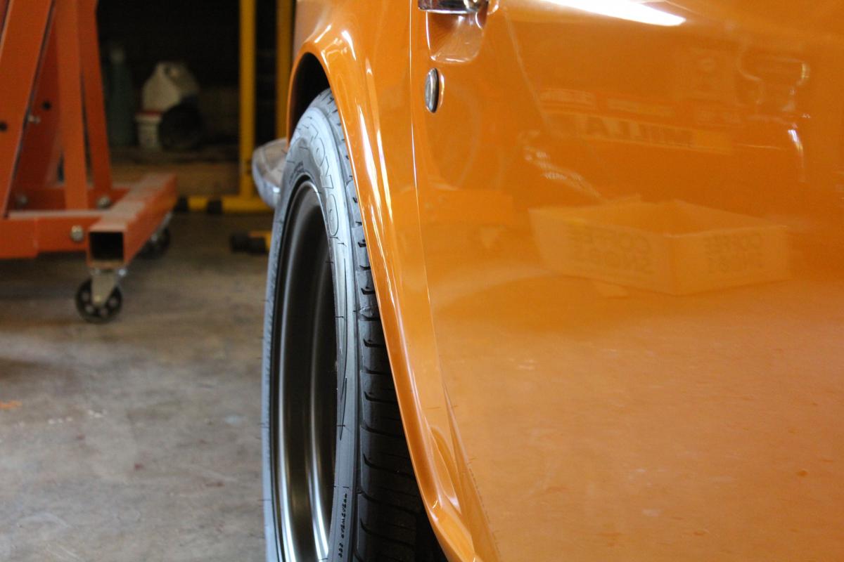

theremm Posted April 1, 2017 Posted April 1, 2017 Test fitted my 15 x 8 (+0 offset) watanabes on the rear of the 240z this afternoon.. A lot of people seem to think that these fit fine however after trying them on the car they just seem way too wide?? I haven't settled on a tyre size.. however I was ideally thinking 225/50/15. I lowered the car as much as safely possible with some cushioning to simulate about the same ground clearance of a 225/50 tyre. I was hoping someone in the Brisbane/SEQ region might be running a similar wheel/tyre combo and wouldn't mind if I visited to take a look at your car one afternoon? If it wasn't too much of an ask it would be great to even test fit the wheels on my car for reassurance. I'm not feeling too confident of the fitment and didn't want to spend money on a second pair of wheels and/or tyres at this stage.. I only have the 1 pair of watanabes currently. I should note - I do not want to roll the inner lips of the rear guards at all, however want to ensure the tyres won't be scrubbing. I drive the car very regularly and currently have pretty standard suspension/springs. Future plans are for konis etc and king springs, I think. Quote

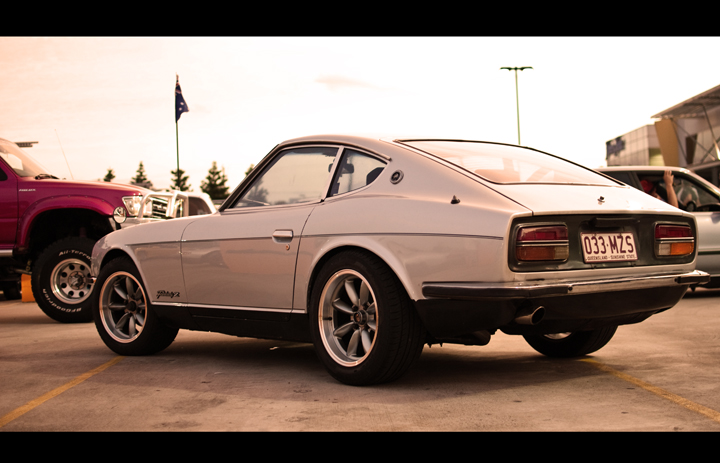

d3c0y Posted April 2, 2017 Posted April 2, 2017 I had 225/50/16x8 +4s on my 240Z and with rolled lips on the back it was fine. I don't think the 4mm extra you have would make a big difference on that. Out of interest, why don't you want to roll the rear lips? There is a mobile guy that comes around and does a great job. He has done both my Rx-7 and 240Z and did a great job both times. I've attached a pic of the job on my Rx-7 where he even flared the guards slightly to accommodate some really wide wheels (ignore the stupid tyres). On the 240Z you can't even tell it was done unless you put your fingers inside the guards and feel for the lip. I'm in East Brisbane if you want to come around and talk zeds sometime. Quote
