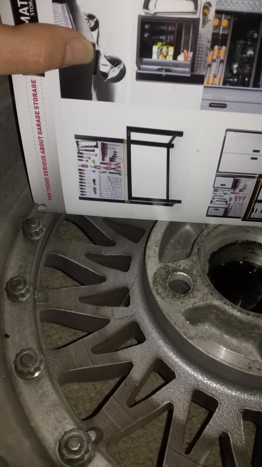

600Z Posted February 9, 2017 Posted February 9, 2017 Hi Guys, Ok I know this has been covered and covered many times over on many forms on how too and what to do for different brake conversions. But to find reviews as to how the different setups perform is not so easy. I have a couple of issues as well as on one of the cars a set of Simmons 16" three piece wheels will be going on and as they are bolted together there is limited room so the brake setup can't protrude much past the hub face where the wheel bolts up. I have a silvermine stage 4 rear brake kit for that was going to be used on that car with the Simmons but it won't fit so it will probably go onto the other 260Z which has the R31 rear setup as it's running superlites and should fit though been lazy and haven't checked lol. My questions are if anyone can give me a bit of advice and how they different brake setups perform are as follows: First 260Z with the 16" Simmons what options don't protrude much past the hub face where the wheel bolts up? (I have clearance of 150mm from the centre of the hub before the bolts of the wheel, so 300mm diameter but then the bolts will foul as they protrude about 10mm back behind the hub face) same issue with the rear obviously. I'm not sure if the s12w calipers will fit or the R32 style but I do want to run ventilated rotors on the front. Is there much of a performance difference between the different four piston setups? And does anyone have any ideas what might fit on the front? The rear I'll probably just swap over the R31 setup unless the maxima type are a lot better though they look to be smaller calipers. Any ideas there? Second 260Z with the superlites I should have plenty of room to run most setups so considering I'll more then likely put the silvermine stage 4 kit on the rear of it with the ventilated rotors and mustang calipers. Do I go the hilux S12W, S13W, R32 type as it all gets so confusing and is there much or enough of a performance difference between them to worry about it? Thanks guys any ideas will be much appreciated. Justin Quote

Agno Posted February 10, 2017 Posted February 10, 2017 It always miffs me how so many Z owners insist on changing to disc brake rear ends or oversize brake calipers for street use. The major restriction for most Z owners would be the quality of the rubber the brakes are acting on (tyres) and a well maintained drum rear will outperform an R31/Maxima/280Z/Silvermine kit rear end 90% of the time. I had to special order wheels with a larger internal caliper clearance to go over my S12+8 (small Hilux) calipers as they protrude approximately 15mm past the mounting face of my 260Z hubs. Looking at your photo your wheels would probably have the clearance for them. I have never really had major problems at the track with the braking ability of my 260Z with S12+8 front calipers and stock drum rear. The only exception being Mallala which was absolute hell on the brakes and my budget (TRW) pads couldn't handle the heat. GongZ 1 Quote
