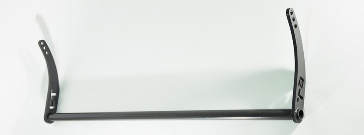

Riceburner Posted February 1, 2017 Posted February 1, 2017 Wondering what people's thoughts are on this bar setup from T3. I'm trying to decide if I go for stiffer springs or I keep the current springs and go for a larger adjustable rear sway bar. Rear springs are in the 180-220lb region, rather than upgrade to 300lb springs will the the rear bar below give me a similar stiffness but with the added benefit of adjustability? Front end has 340lb springs and a 25mm sway bar. Didn't the bob sharp and BRE cars run soft springs and huge sway bars? https://technotoytuning.com/nissan/240z/techno-toy-tuning-rear-swaybar-z Quote
260DET Posted February 1, 2017 Posted February 1, 2017 I'm a heavy springs, heavy front sway bar, no rear bar person for a powerful car with a Torsen type LSD. My reasoning is that the rear tyres have enough to do with putting down power without putting much extra load on them cornering while the front just has to steer. Works for me. Quote

Riceburner Posted February 2, 2017 Author Posted February 2, 2017 All good info thanks chaps! I searched for Carroll Smith and came across that quote on performance forum. The way I read through his definitions it sounds like I should be going for stiffer springs and leave sway bars out of it. I have mostly adjustable links on the suspension so camber, castor, toe front and rear is all manageable. The rear springs are just king spring lows, I thought they were 220lb but now I have read they are less. I guess the next step is to go for a custom rate. What do you guys think of something in the 250/275lb range? I have bilstein shocks to go in the rear too. Quote

dat2kman Posted February 2, 2017 Posted February 2, 2017 Gareth, why do you think you need a rear sway bar,and, a stiffer rear sway bar? When racing, i ran a standard rear bar, and a thicker front bar, and would adjust the stiffness on front, by moving the drop links fore/aft, The rear, by simply backing off the nylock nuts, it would reduce prpensity to oversteer, and also allow the car to "flop over" before bar started to work, ( good for wet tracks) Spring were 250-275 front, 225-250 rear, a stiffer front, say 300-325 would have been preferable, as the front bars drop links could have been backed off a bit more if needed. We cant easily fit blade adjusters to the bars in a Z, unless its custom fabricated, but unless you are after the nth degree, why would you need them? Quote
Riceburner Posted February 2, 2017 Author Posted February 2, 2017 Gareth I had my front King lows KDFL08 springs measured at my suspension shop and they were actually 155 and 160 lb/in. From memory King advertise them as 200 lb/in. I personally don't have much faith in their specs. I am currently running the Kings with a 24mm sway bar up front and kings with no sway bar at the rear. It is great for the road but boat like on the track with a little understeer mid corner on the slow corners. What spring rate are you running at the front? Are you thinking coil overs? Don't want to go too stiff at the rear if the front is soft. Interesting, I'd read they were around 180lbs. That's a massive front rear split for me 340lb front, 150/160 rear Mine seems ok on track, but looking at other in car vids I seem to have a fair bit push and from my steering inputs some understeer. Great topic guys. So much to say, but hey, you have to try it, test it and feel it. You can't manufacture a car set up on the forum. You can get ideas, but that's all they are. Guys will give you there set up, but don't drive on the tracks your going to drive on. Carrol Smith talks about bumps in corners, but has he driven a zed at PI lately . Theres way to many variables. Your driving style is different to others .you could be fast in and slow out. Or slow in and fast out. You might like a little over steer or perhaps under steer. It's never ending . The pursuit of the fastest lap, and the best set up. My advice is to get your ball park set up. Try it. And then change your set up one thing at a time and log book the changers. Some things make a big difference and some things don't do much at all. Good luck Gareth. When you find the perfect setup let me know. Cheers. It's the tight arse coming out in me, I was hoping some keyboard racing might help get a better setup before I race again next decade. Lol! Time and budget mean racing could be a while off and I was thinking the adjustable sway bar might allow me to cheat a little and not have to buy/try several sets of springs before finding the right stiffness. Gareth, why do you think you need a rear sway bar,and, a stiffer rear sway bar? When racing, i ran a standard rear bar, and a thicker front bar, and would adjust the stiffness on front, by moving the drop links fore/aft, The rear, by simply backing off the nylock nuts, it would reduce prpensity to oversteer, and also allow the car to "flop over" before bar started to work, ( good for wet tracks) Spring were 250-275 front, 225-250 rear, a stiffer front, say 300-325 would have been preferable, as the front bars drop links could have been backed off a bit more if needed. We cant easily fit blade adjusters to the bars in a Z, unless its custom fabricated, but unless you are after the nth degree, why would you need them? Was your front bar the adjustable type? It seems I'm way too soft in the rear and the front rear split is too big. From most of the Australian Z track car videos I have seen everyone looks to have a lot less steering input through the corners and I have shortened steering arms. My initial turn in is fine, minimal and direct but as I progress through the corner it looks as though I increase steering all the way until the very exit. I guess as Gordo says that could just be my driving style and the Torsen diff might be causing the push. Quote
