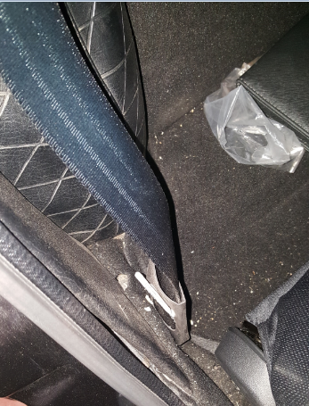

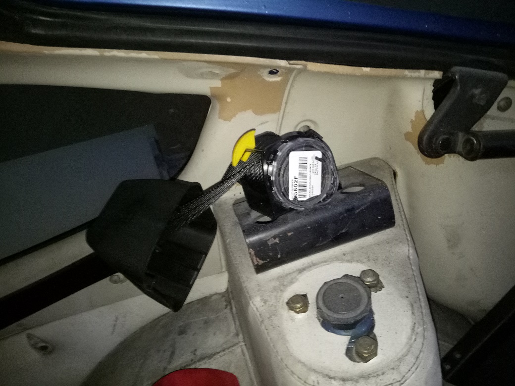

nizm0zed Posted December 8, 2016 Posted December 8, 2016 this is my setup, 76 260zI used an aftermarket retractor and mounted it on the stock seatbelt mounting plate.Im not sure if all the cars have these? but mine has had them ever since I have owned it.Mine doesnt have the stalk on the window pillar anymore though, the belt goes through my seat now, but i wonder if you would be able to get Klippan, or Autoliv aftermarket or whatever they are called now to use this retractor part number and put your pillar stalk on before they sew the buckle in place.I reckon any engineer would be pretty happy to sign off on that, may not be exactly like oem, but its pretty damn close. Quote

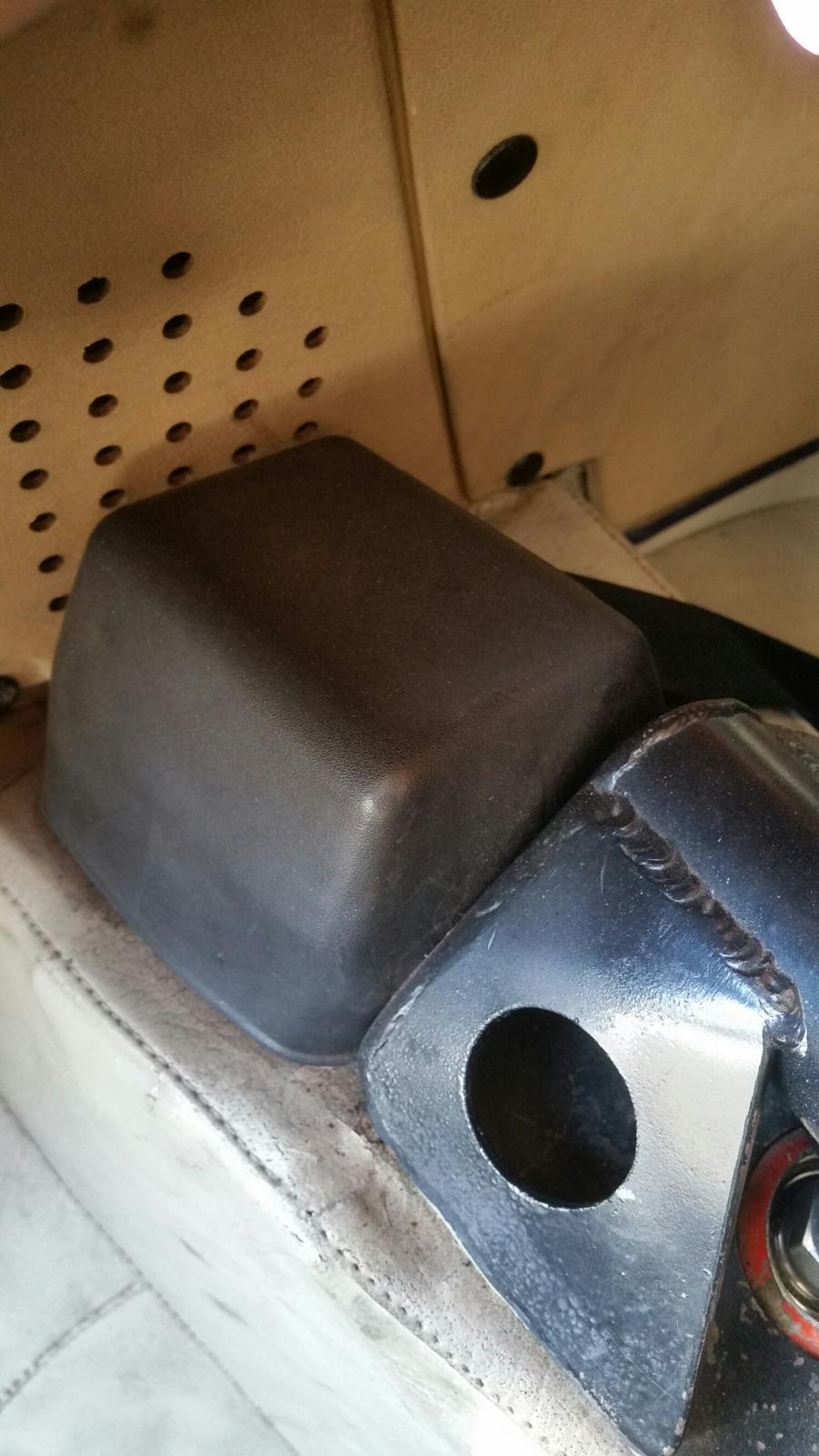

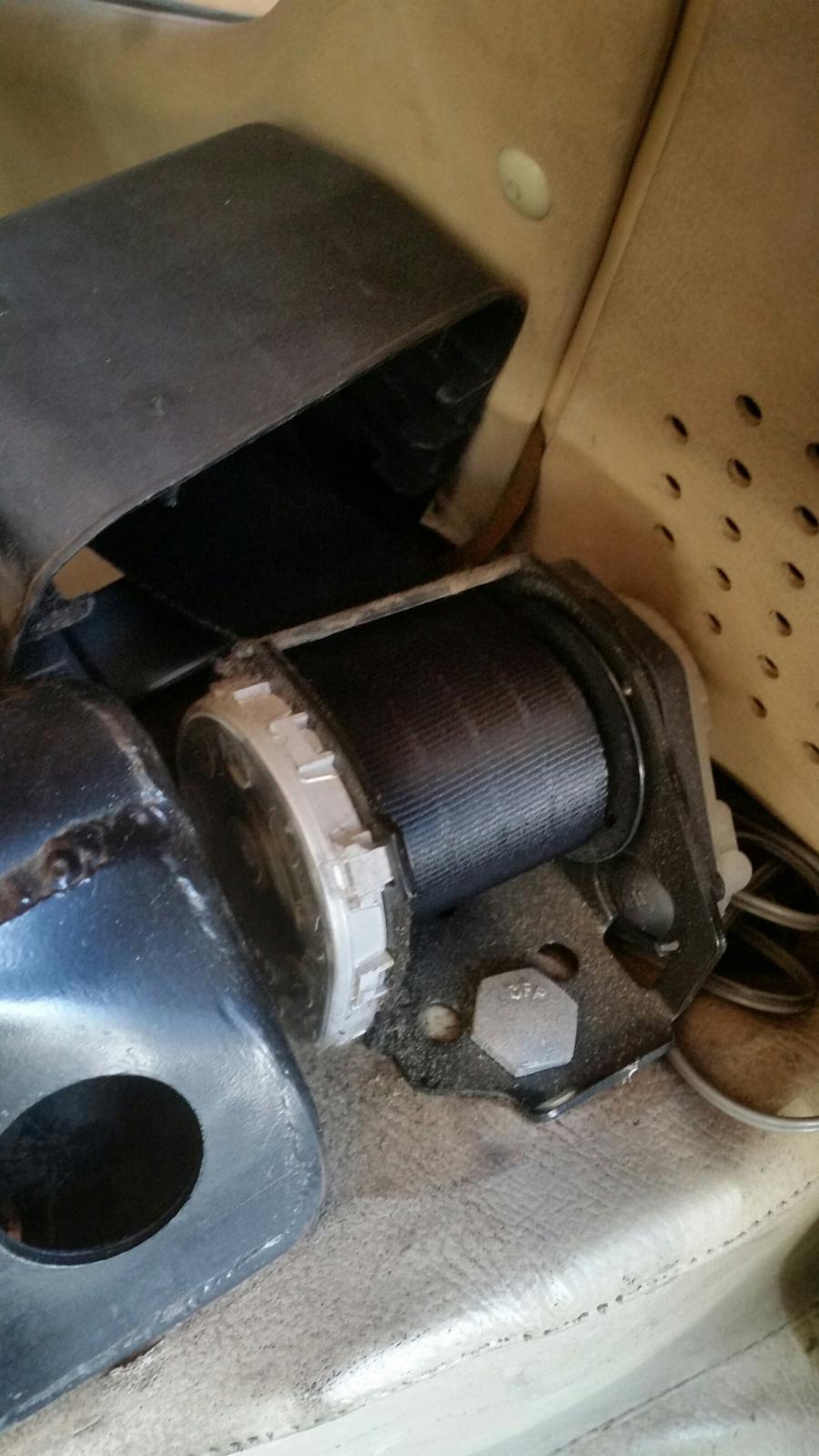

my_mad_z Posted December 9, 2016 Posted December 9, 2016 Photos aren't the greatest but you get the idea. I was reluctant to mount the seatbelt mechanism on the wheel arch but due to space limitations because of my seats, I didn't really have much of a choice. There is a reinforcement plate also supplied by Hemco that provides a mounting point for the seatbelt mechanism. The drop-link uses the existing mounting point in the pillar and the anchor point also uses the existing mounting point between the seat and door jamb. The cable stalk also uses the existing mounting point. Due to the reel being so close to the drop-link, I believe Wayne may have made the seatbelts slightly shorter so I didn't have issues with the webbing feeding back into the reel. Part numbers: Seatbelt mechanism/drop-link: 1600009 ($165ea) 350mm cable stalk: 1766029 (included in the above price) Reinforcement plates: 1740211 ($5.50ea) S&H: $26.40 Bought these in 2014 so prices may not be the same. Hope that helps. Marc. 1600009 Issue C Mar-14.pdf 1766029 - 350mm 45° DS Stalk.pdf Quote
