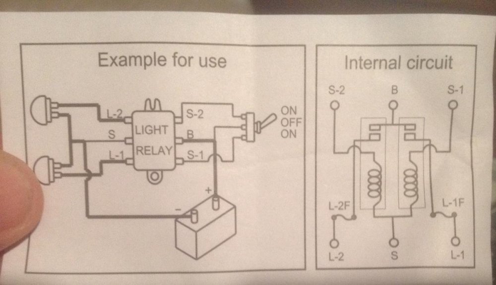

Thanks for your response Peter , there's no hurry mate . Just need to know in the simplest of terms how to set it up properly .
The diag's they enclosed were a bit confusing for me & I don't want to stuff anything up just for the want of patience.

Not sure this is the best option but this is how mine was done by the previous owner. I have since replaced the relay and done it the same way. It has worked well to date.
As PB mentioned, because the S30 lighting is -ve switched, you have to make a small modification to the relay. It really is pretty simple if you can solder, just snip the 2 coil wires close to where they are soldered to the chassis or body of the relay. Now solder on an 8" piece of wire to the ends of the 2 coil wires and route it out of the relay body, you can see how i did it in the pics attached as well as how to wire it up.
I hope this helps but let em know if you need more info.
Mick

Hi Mick, Alan
With the newer relays you don't need to mod them for -ve switch.
The relay does not earth the switching circuit through the relay chassis, it has a separate (6th) terminal for that. So supply +ve to the "S" terminal and let the exiting switched circuits in the car handle the closing.

 Thanks for your response Mick , also to you Peter for the Diag's mate , it's a lot easier to comprehend than the info that came with relay unit .
