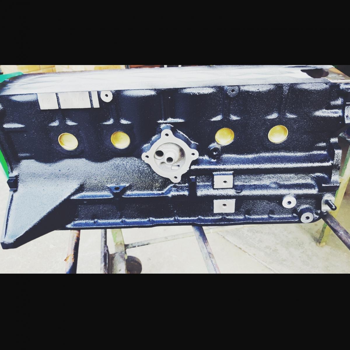

Riceburner Posted September 6, 2015 Posted September 6, 2015 Do you expect any issues with cooling when the block is grout filled? Quote
peter mc Posted September 6, 2015 Author Posted September 6, 2015 So far every block i have filled. We have not seen any change in cooling . As most of the cooling is needed at the top of the bore and head .. Quote

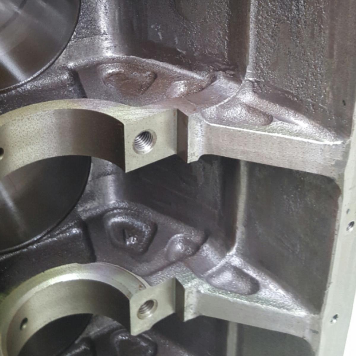

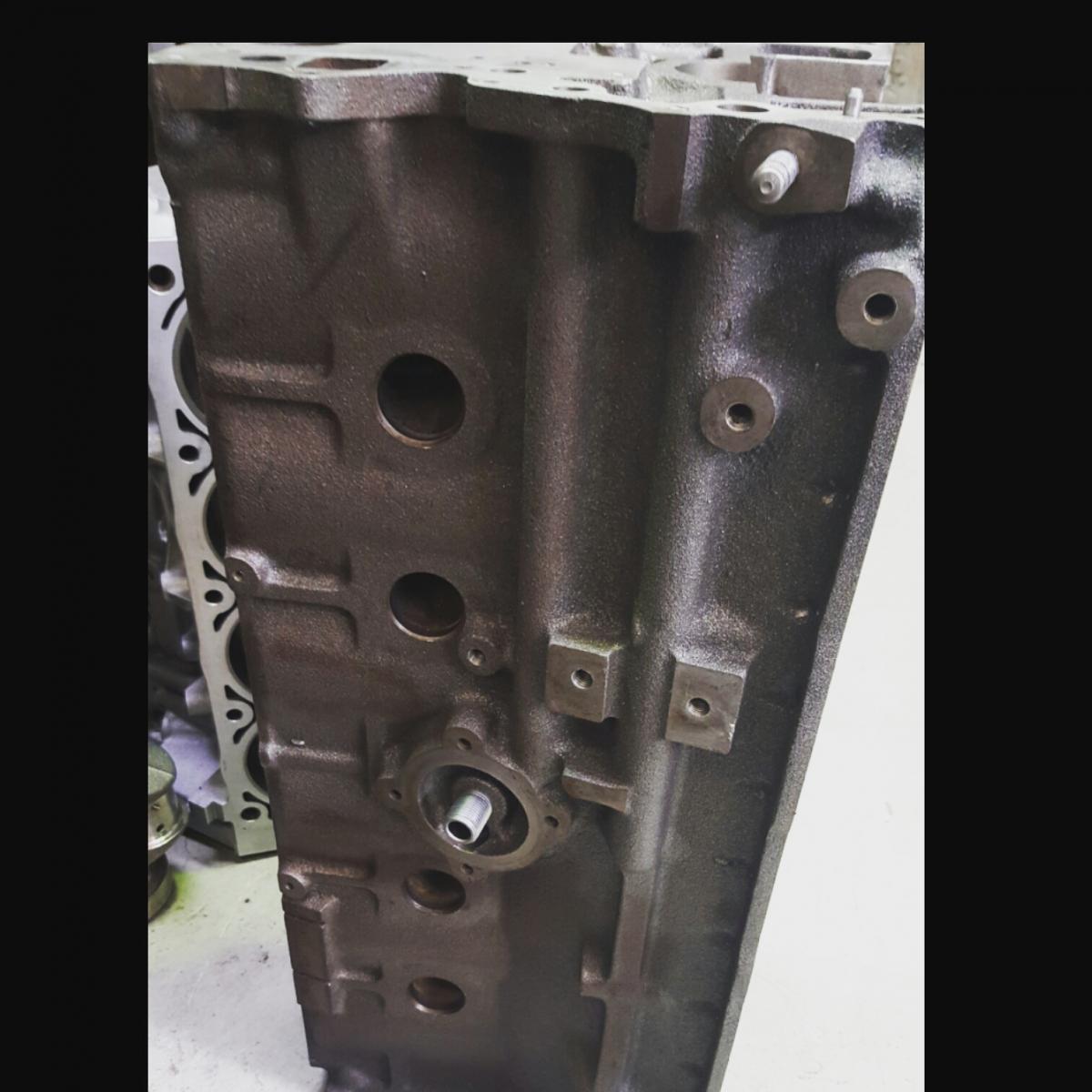

peter mc Posted September 9, 2015 Author Posted September 9, 2015 Working on the block this week. .making room for the 90mm stroke ..next week im flying over to japan to see os gikens engine man and get a few parts ..things are getting serious. .going to be a dream trip scott 1 Quote

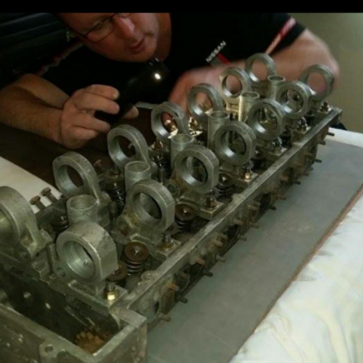

peter mc Posted September 27, 2015 Author Posted September 27, 2015 Having the best time in japan so many cool things to see .spent 2 days with the people at os giken factory. Just great people. And there motors were fantastic. gav240z 1 Quote

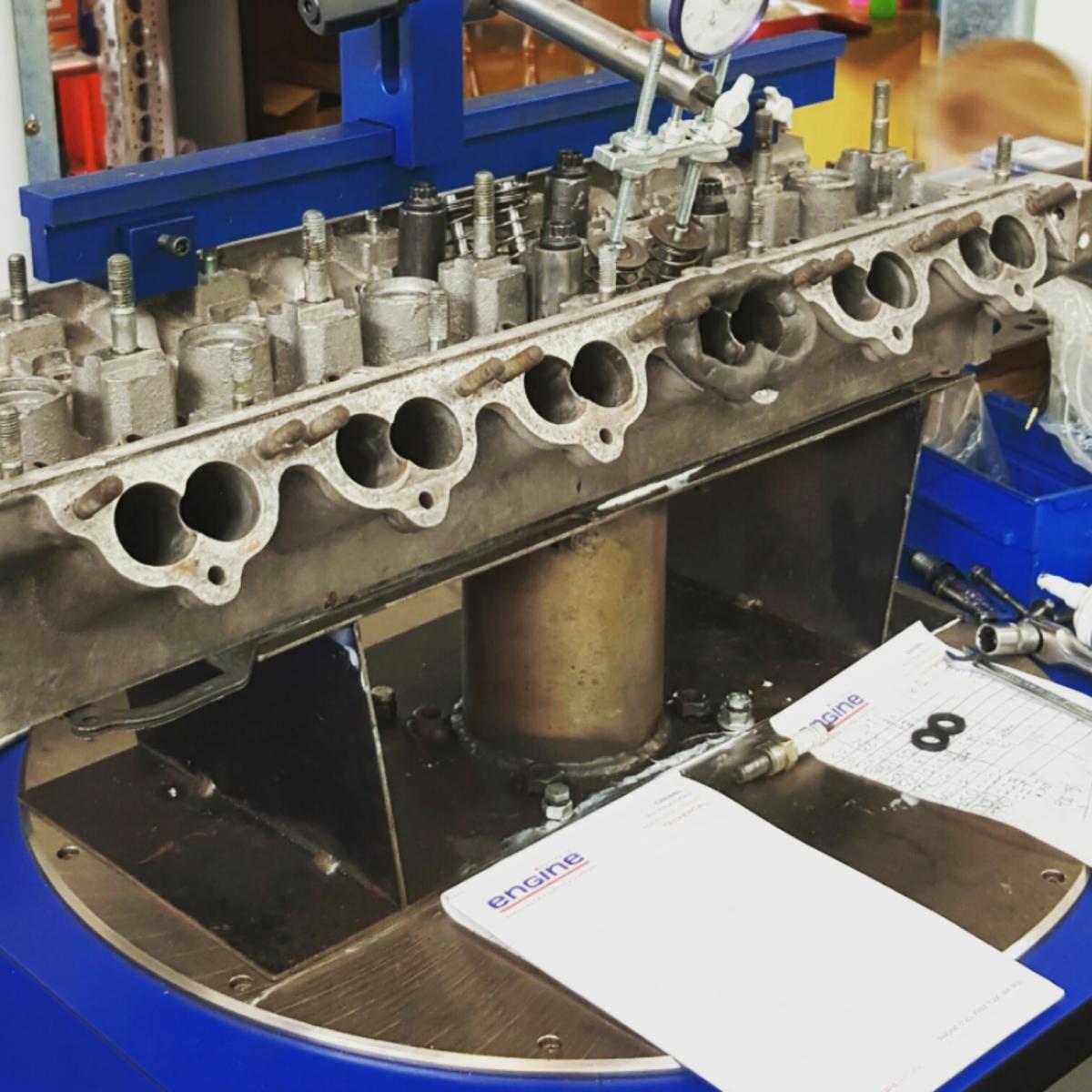

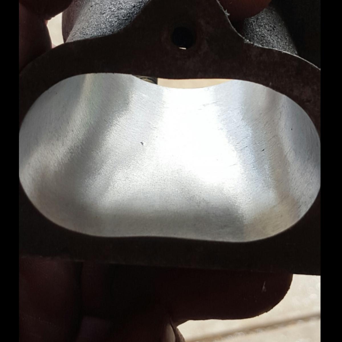

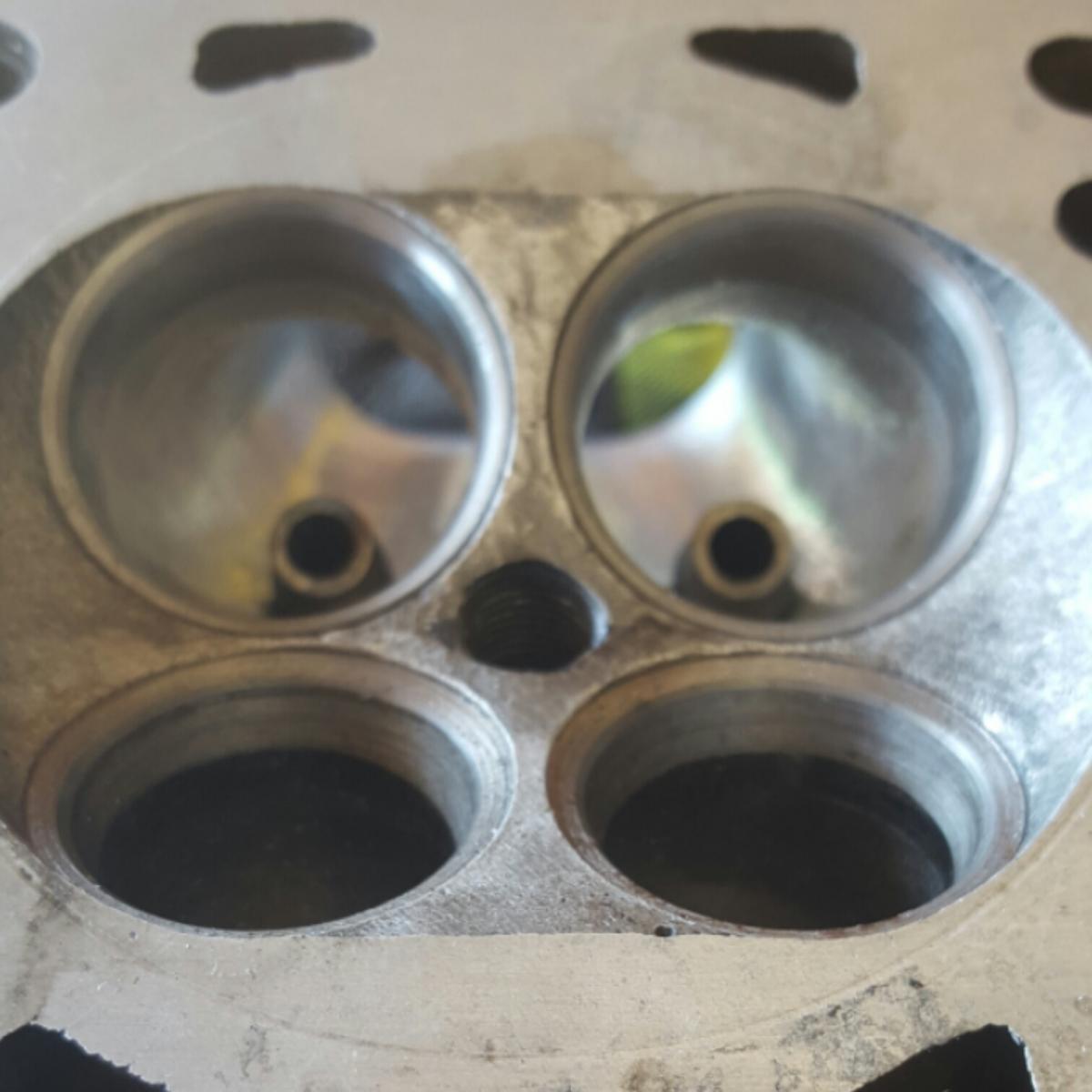

peter mc Posted October 1, 2015 Author Posted October 1, 2015 So first day back i had to know how well the os24b1 head flows stock and then with a good port to clean up a few problems. Well first time on the bench it was quite clear the port was very small .and went in to choke and stoped flowing at 350 thou lift but still flowing 376hp . Next i spent several hours doing the port and fixing the seat area. Well i was very surprised. 440hp flow first test ..i think 450hp flow is not going to be tuff to find scott and gav240z 2 Quote
peter mc Posted October 1, 2015 Author Posted October 1, 2015 Many hours to go .and have to make a new set of valves .5 mm up in size to make best use of the seats .so its very possible theres 450hp flow .that will be one cracker L motor Quote

peter mc Posted October 1, 2015 Author Posted October 1, 2015 (edited) I have cut aways and seen the size i can safely go. The head of os giken engine department spent a day with me showing all the tricks . Edited October 1, 2015 by peter mc Yamahacam 1 Quote

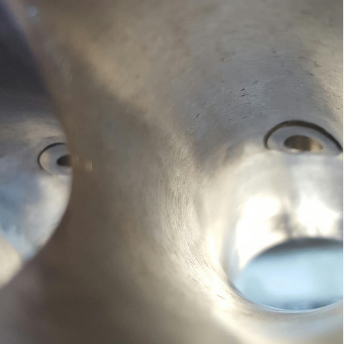

peter mc Posted October 4, 2015 Author Posted October 4, 2015 Ports are looking very nice now its taking some time to get something that works on such a big engine. . Quote

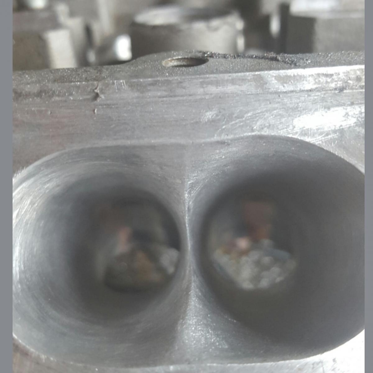

peter mc Posted October 7, 2015 Author Posted October 7, 2015 Lots getting done block prep work is well on the way . And ports are looking fantastic. Port flow is at 305 cfm through the intake. Steve at efi hardware is making a custom made set of itb for me .they are great to deal with .and clive cams are building a set of custom made billets for the new now very high flowing head ..its going to be very special Quote
