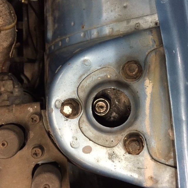

Moderators PB260Z Posted August 20, 2015 Moderators Posted August 20, 2015 Hi, So have done all the suspension and the ride height and stance are good, but we have heaps of negative camber. Turns out the car has offset top strut mounts (see image) thus I am now looking for a standard set of upper strut mounts. Has anyone got a set of these sitting around looking for a new owner ? Thanks in advance PB Quote

Moderators PB260Z Posted August 20, 2015 Author Moderators Posted August 20, 2015 Hi Mate Not adjustable, the mounting hole is offset (about 10mm) to increase neg camber. Happy to swap if anybody can use them. Cheers PB Quote

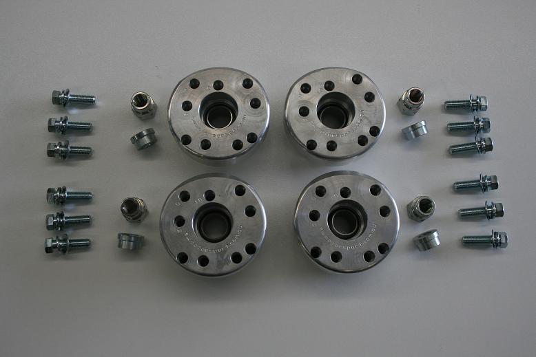

GongZ Posted August 20, 2015 Posted August 20, 2015 Hi PB, I noticed at the Harry's Cafe meeting that Mick's (Cozza's) 240Z had offset front strut mountings. I asked him about them and I am pretty sure he said that they were negative 1 degree and from Stewart Wilkins Motorsport. I have just had a look at the SWM website and they show these; Strut Top Mounts for 240Z & 260Z - Billet Aluminium - Price: $1,540.00 (front + rear) http://www.swmotorsport.com.au/product_info.php?products_id=129 If this is what you have on your car - you may be in luck because they have 3 camber positions - STANDARD, negative 0.5 degree and negative 1.0 degree. So you might just need to undo them and set them to the standard setting. Quote
Moderators PB260Z Posted August 20, 2015 Author Moderators Posted August 20, 2015 Thanks Ian My car has what look like standard steel/rubber mounts but the hole for the shock tube about 10mm inbound. If they were adjustable I would be very happy. Cheers PB Quote

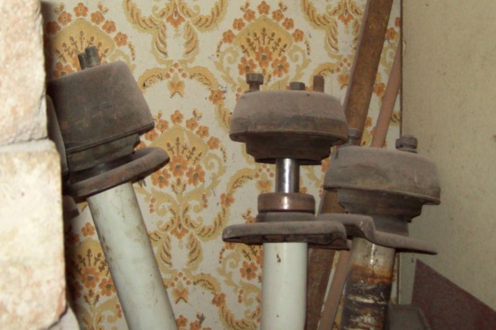

HKSZ Posted August 20, 2015 Posted August 20, 2015 240z and 260z '74 had short tops all round, the later 260z seaters and 2+2 have short front tall rears. All interchangeable. Quote
PeterAllen Posted August 20, 2015 Posted August 20, 2015 Peter, I've got these off my 240Z if they are of any use? Quote

Cozza Posted August 20, 2015 Posted August 20, 2015 Hi, So have done all the suspension and the ride height and stance are good, but we have heaps of negative camber. Turns out the car has offset top strut mounts (see image) thus I am now looking for a standard set of upper strut mounts. Has anyone got a set of these sitting around looking for a new owner ? Thanks in advance PB Hi Pete. You mention you have "heaps" of negative camber. As Ian commented I have these in the front of my 240 (non adjustable though) and I still have less than 1' negative. Obviously if your strut length is shorter than mine, this offset bush will offer more overall negative however, I am thinking your "heaps" of negative camber may be due to something else. Is it possible you have lengthened lower control arms or something? Just a thought. Mick Quote
Moderators PB260Z Posted August 20, 2015 Author Moderators Posted August 20, 2015 Peter, I've got these off my 240Z if they are of any use? Hi Peter The smaller ones are what I have been chasing, but I am pretty sure I have it sorted. If the current plan doesn't work out I will let you know. Cheers PB Quote
Moderators PB260Z Posted August 20, 2015 Author Moderators Posted August 20, 2015 (edited) Hi Pete.You mention you have "heaps" of negative camber. As Ian commented I have these in the front of my 240 (non adjustable though) and I still have less than 1' negative. Obviously if your strut length is shorter than mine, this offset bush will offer more overall negative however, I am thinking your "heaps" of negative camber may be due to something else. Is it possible you have lengthened lower control arms or something?Just a thought.Mick Hi MickGood thought and I had also considered that.I have had a good look around and everything else looks factory original.Once I fit the correct mounts I will know for sure.CheersPB Edited August 23, 2015 by PB260Z Quote
