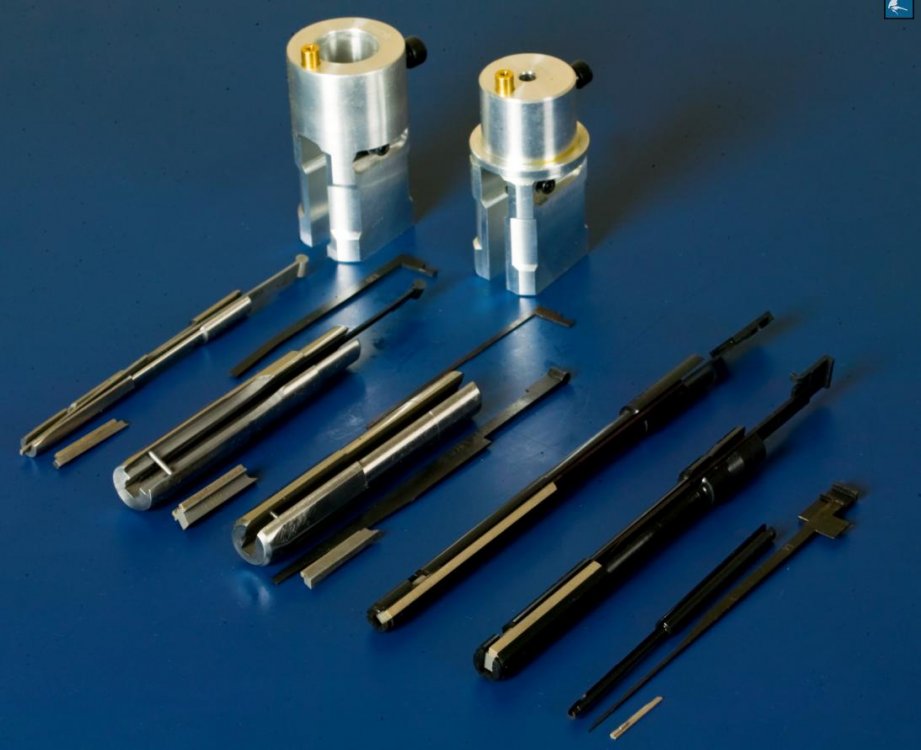

Agno Posted July 17, 2015 Posted July 17, 2015 Just a suggestion for those doing this job, get a hone tool and give the struts a quick going over. I found the spindle pins had seized because of ovality in the struts and also excess material in the middle of the cylinder where the locking screw goes. Quote
PeterAllen Posted July 17, 2015 Posted July 17, 2015 Just a suggestion for those doing this job, get a hone tool... Easy enough to make. Use a piece of 8-10mm dia rod (steel or timber) about 150mm long and cut a hacksaw slot in one end about 30mm deep. Tear off a piece of approx 120-240 grit emery cloth, about 30mm x 70-100mm, and insert an end into the slot, then wrap the the remainder of the cloth around the slotted section of the rod. Make sure you wrap it in the direction on rotation when the rod is driven by a hand drill. Just clean up the bore - don't overdo it. Quote
Agno Posted July 17, 2015 Posted July 17, 2015 I did that also, but I used one of these babies to scrape a much larger amount of material off the cylinder walls! Quote
