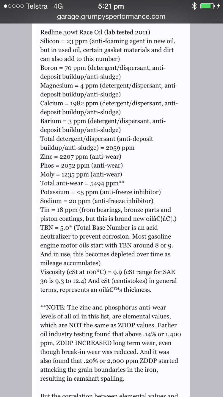

dat2kman Posted November 21, 2015 Posted November 21, 2015 8000 ppm I kinda like that number. Certainly shows on teardown Quote

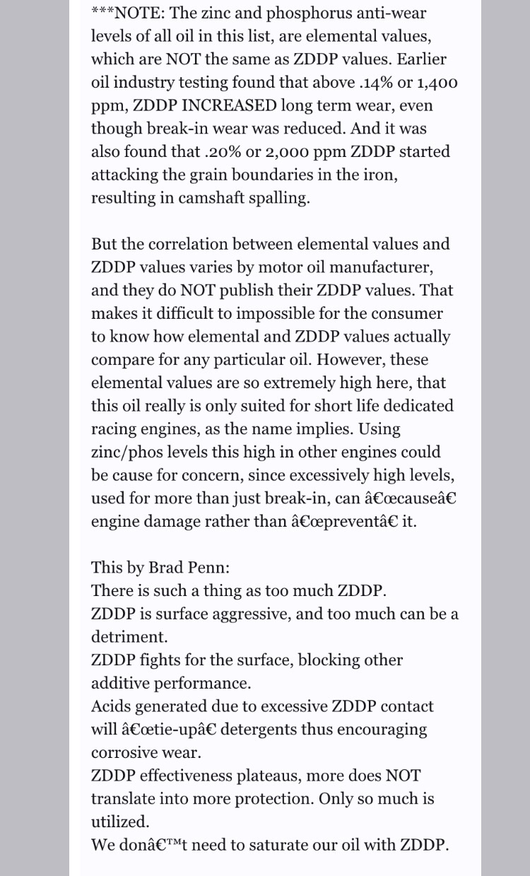

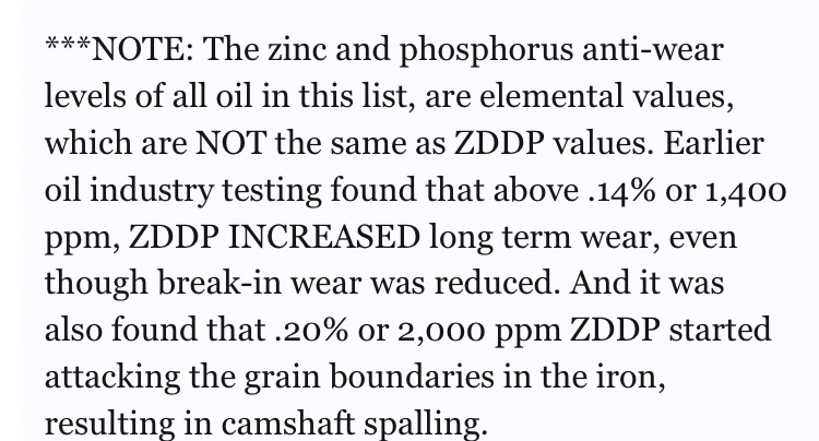

260DET Posted November 25, 2015 Posted November 25, 2015 Keep in mind that ZDDP is consumed during engine operation so the PPM is not crucial unless the oil is going to be used for a longer time. And of course ZDDP is only one additive among many, base oil quality is the most important factor too. Quote
260DET Posted November 27, 2015 Posted November 27, 2015 http://www.motorweek.org/features/goss_garage/too_much_zinc_in_your_oil short expert comment on the amount of zinc needed, too much performs no useful function and can actually be detrimental. Much more relevant to flat tappet engines too. Basically 1,200 PPM is sufficient for running in, 800 PPM after that. Quote

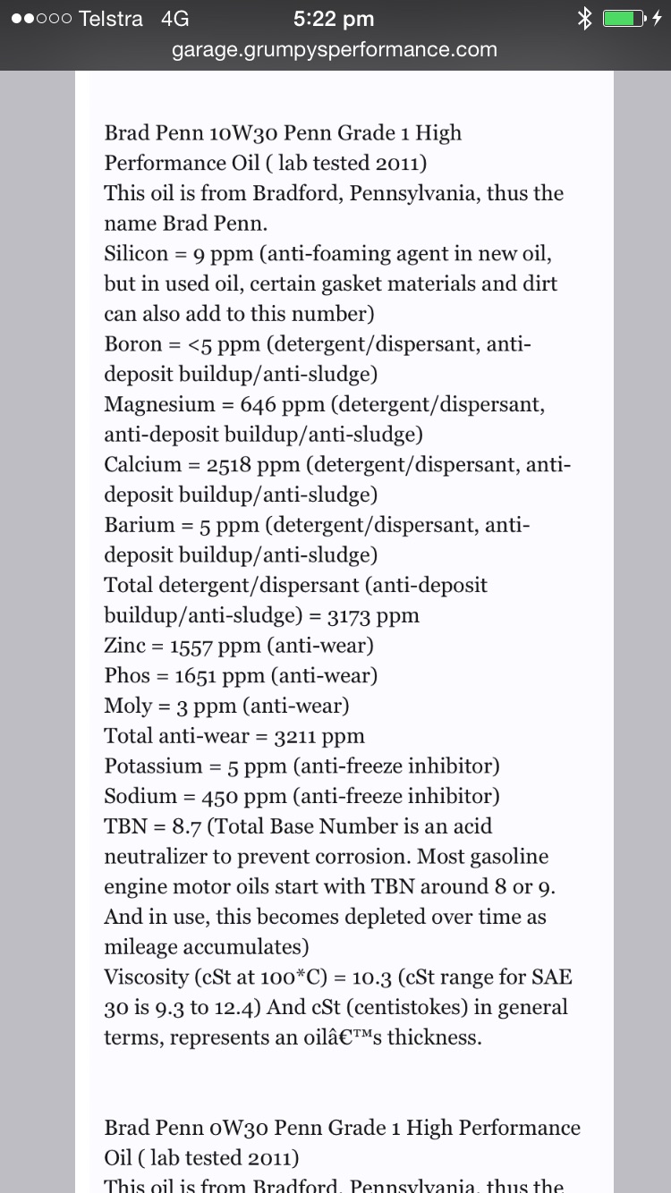

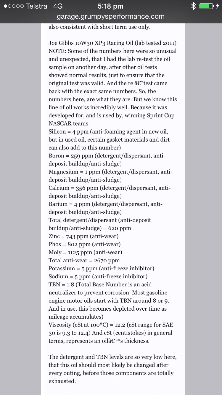

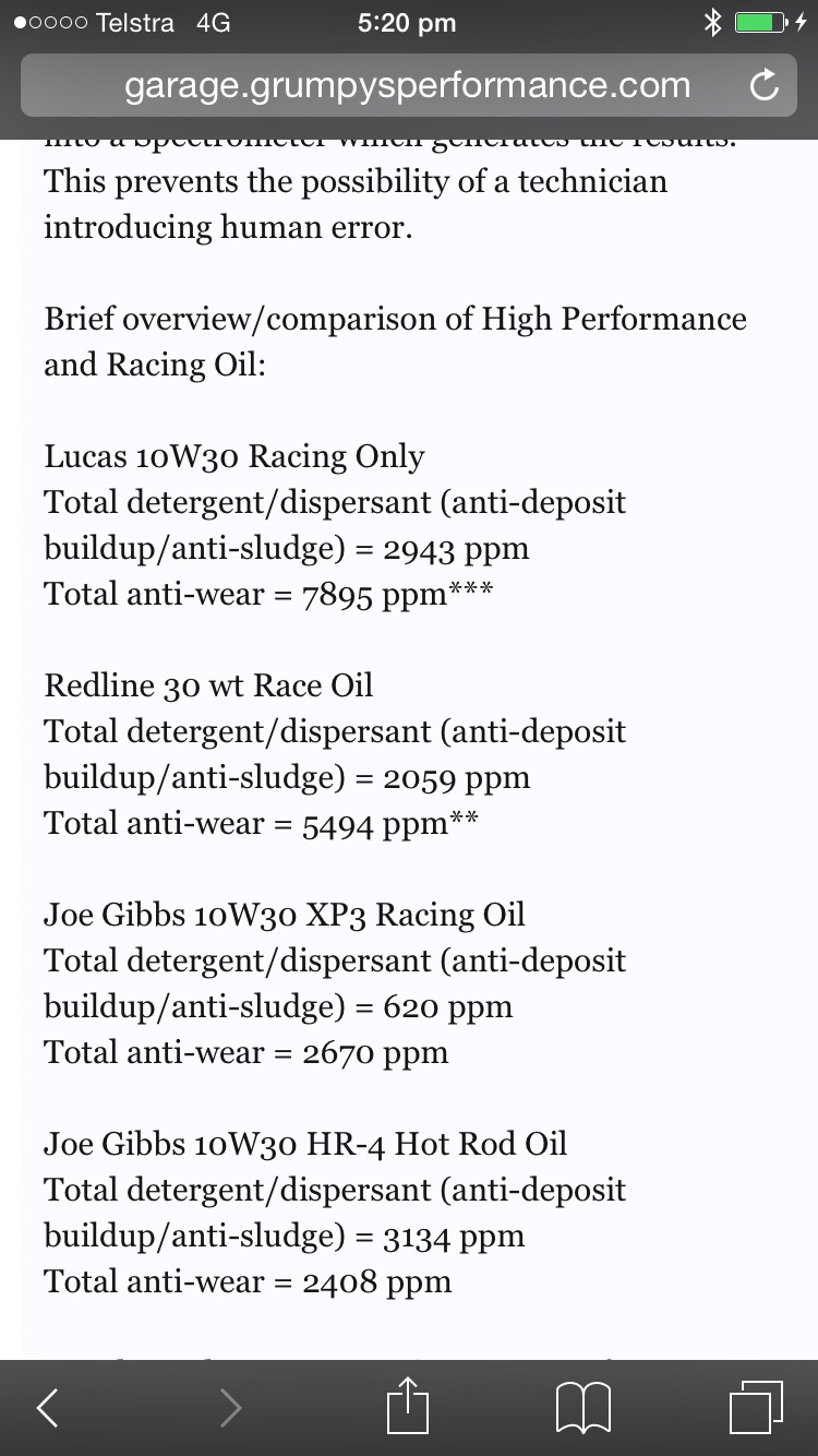

Riceburner Posted November 27, 2015 Posted November 27, 2015 There a heap of info on this Link, lots of laboratory test results on many many oils. http://garage.grumpysperformance.com/index.php?threads/which-oil-what-viscosity.1334/ Quote
Riceburner Posted November 27, 2015 Posted November 27, 2015 On the first attachment it refers to 'total anti wear' it's a combination of ingredients and not Zinc alone. Quote
